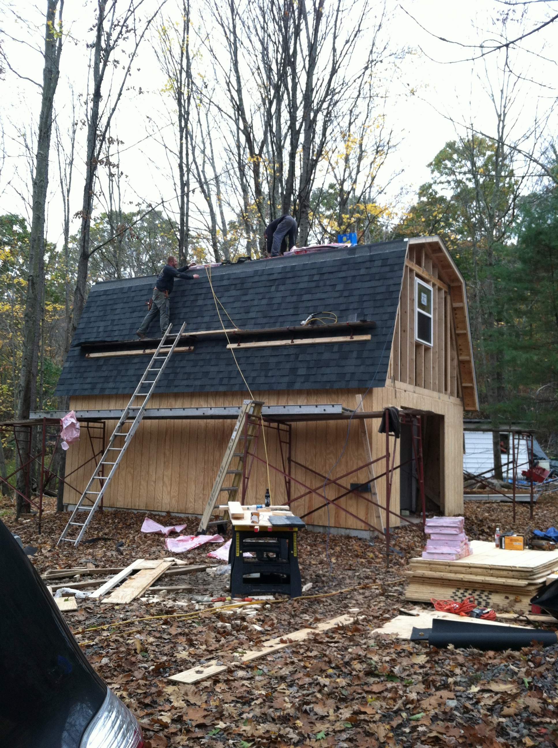

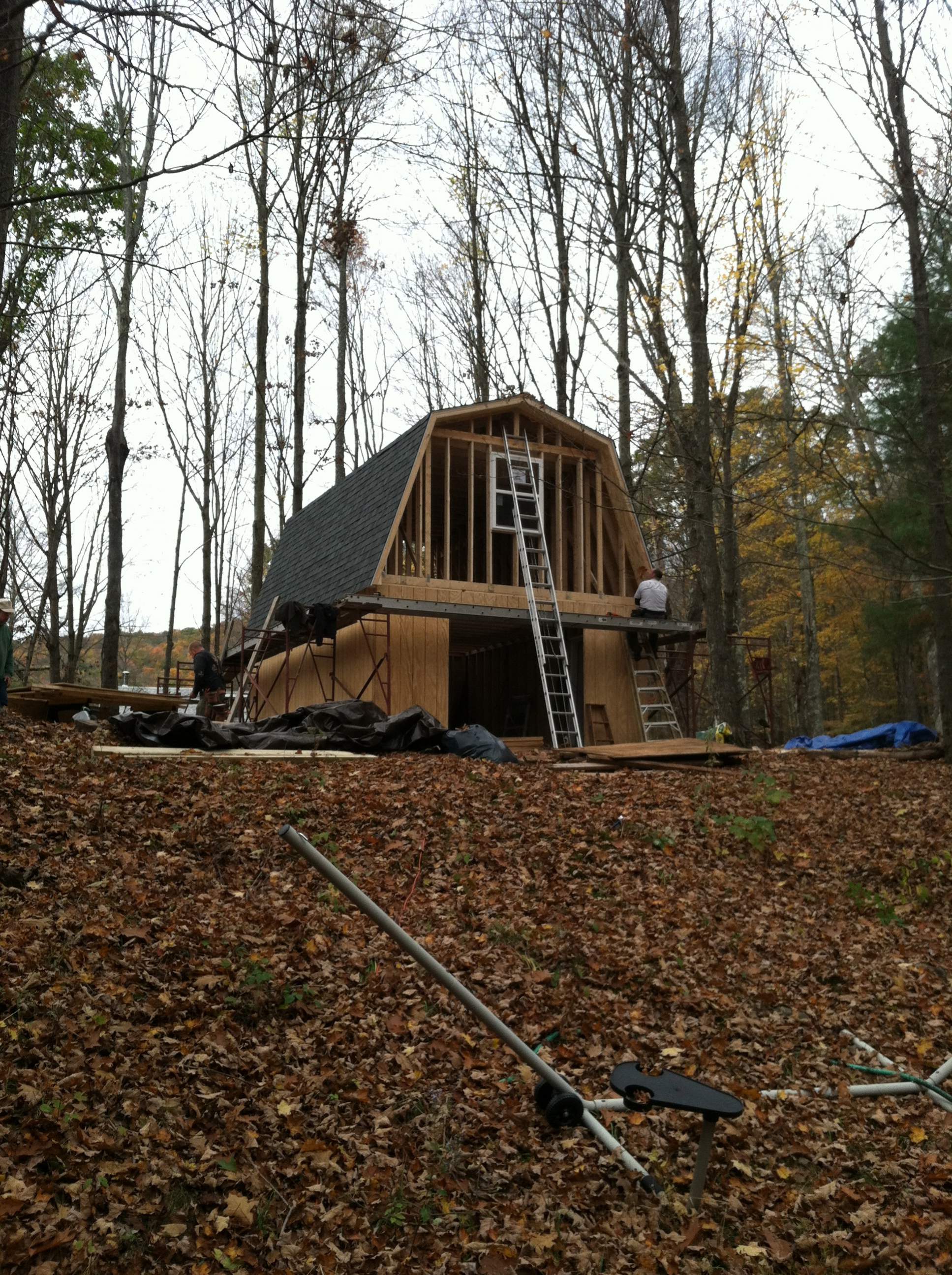

   / 16' x 24' Mini-barn build #12
that the same size i built
