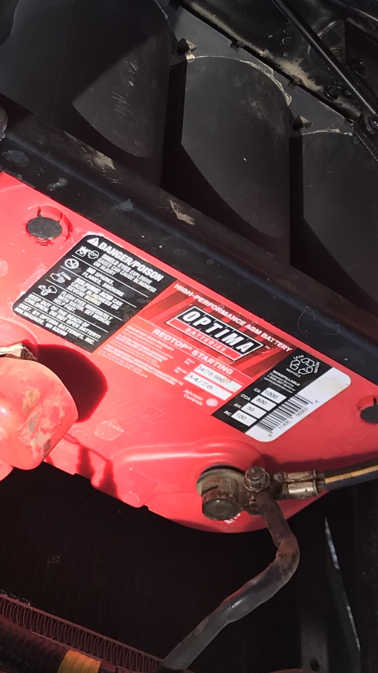

Thanks again for the responses. Great discussion. For those who went the sealed/optima route, any suggestions on the right model? There doesn’t appear to be a like-for-like replacement for the model I have.
   / 1626 Battery Leaking #13
From the photo of mine it looks like a group 34. The part number is 34/78-980.

My 1626 battery is leaking as well. I致e had it two months!
I cannot believe Mahindra is still dealing with this issue. The 3016 I bought in 2013 (which is now termed as the 1626), also had a leaking battery as well as a *****-ton of other Mahindras with the same problem.. This was due to a bunch of cheaply made "Exide" batteries that leaked from the base of the posts that I can only assume Mahindra got a "good deal " on.
I received a new battery and cables under warranty. The replacement was an "Interstate" which as of this date, has had no similar problem.

I am in the process of converting over my 1526 from a BCI Group 58 over to a Group 34 AGM battery. The only thing that does not fit is the battery holder angle bracket. Other than that there are no problems at all. My positive clamp was corroded hard and took the galvanized plating right off. Looked like big mushroom of some sort. I cleaned that all off with baking soda and warm water and repainted the tray. The original leaking battery was made by EXIDE something like a 60 month, El Cheapo thingy.
