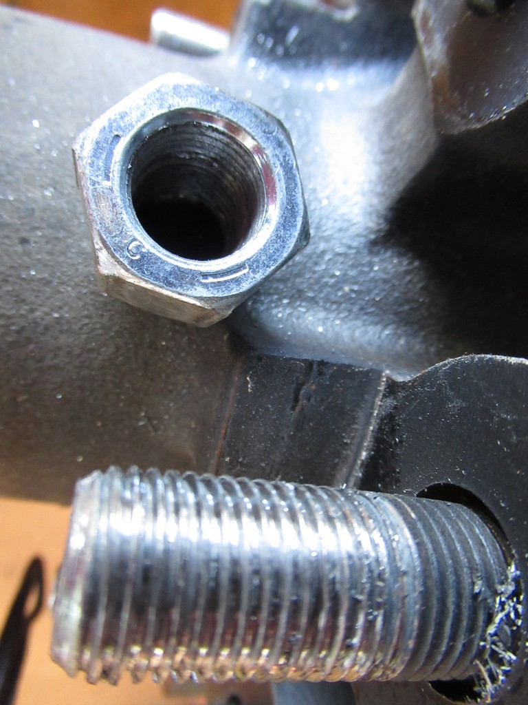

All the 17.5 wheels on etrailer call for a 5/8 flange nut.

This is still in the works and no resolution yet. They don't know it yet, but I'll be visiting with them later this week along with the hubs & wheels. And yes, the liability could be huge. What they've done seems to void all the warranties and liability that the various manufacturers provide.
Also, I want to point out that the trailer manufacturer (PJ Trailer) had nothing to do with creating the problem. It was the dealer who made the decisions. I've only recently contacted PJ Trailer warranty department and their initial response is that's not right, but wants some more information.
The trailer currently sits on blocks next to the barn until this is fixed. I still like the trailer although I haven't been able to use it yet and don't want to return it. I have a couple things I want to do to it, but won't until this is resolved.

I already pulled one wheel off in the process of discovering this. Because the studs are damaged I can't put it back on. I'm not sure I'd want to tow it another 100 miles in the condition the dealer delivered it in, in any case. I checked the other 3 wheels by backing off one lug nut so it was not in contact with the rim on each wheel to see if any were different, they're not. So, I pulled the grease cap off the spindle of each wheel and took the spindle nut off and pulled the whole wheel hub, rim and tire assembly so they can see for themselves. It's about 100 miles to the dealer, I'm about half way between two of them. I talked to a friend of mine and he mentioned something i'd not considered, that is that they may have mixed SAE and Metric threads. The nuts would start a thread or two and a big impact wrench would force it all the way on from there (and destroy the threads in the process).

It is a good thing you have good observation skills. What about the poor customers who are unaware? They probably have not converted very many, in spite of their claim of, "we always do it this way". But even 2 or 3 is too many. You can bet that after you, Dexter and PJ educate the dealer, they will not be contacting and recalling the previous conversions.
Pretty sure the nuts were the same ones that were holding the 16's on. They were damaged when the tapered portion of the nut made contact with the sharp, square cut 5/8's hole of the new wheels. When they were torqued down, the nut was pinched into the stud threads and destroyed.

It's possible they used the wrong nuts and that damaged the threads. But that says more about the dealership and the people they have working there. It's even possible that they are different pitch threads to purposely make doing what the dealer did not possible (without force). What sort of mechanic in good conscious would force a nut onto a stud with the air gun hammering all the way? How could they even torque the nuts down correctly. Hopefully someone with some power at that dealership steps up and makes this right.

They buzzed off the 16's and buzzed on the 17.5's with the same nuts. Where would a trailer dealer find metric or non standard lug nuts? They are all either 1/2, 9/16's or 5/8's fine thread, in tapered or flange style. But yes, anything is possible with that dealer.

It is common for brand new (very dry) studs and nuts to seize if they are run with a high speed impact. The new nuts/studs have small burrs on them from the manufacturing process and with the speed, will start galling the thread.
