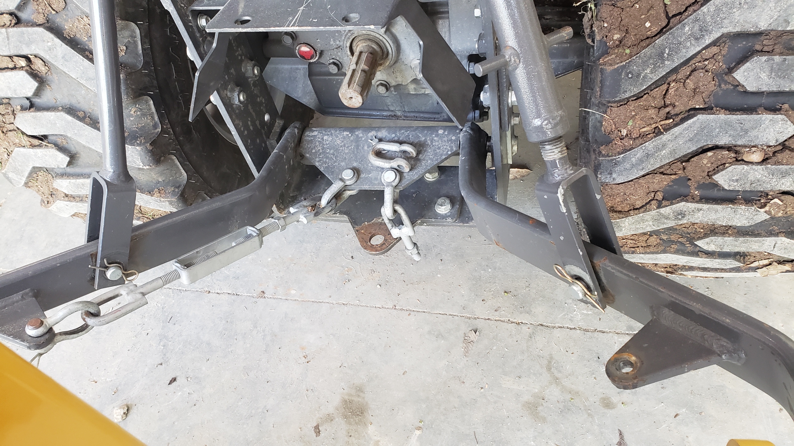

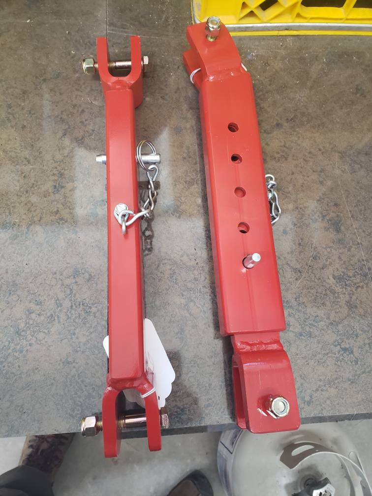

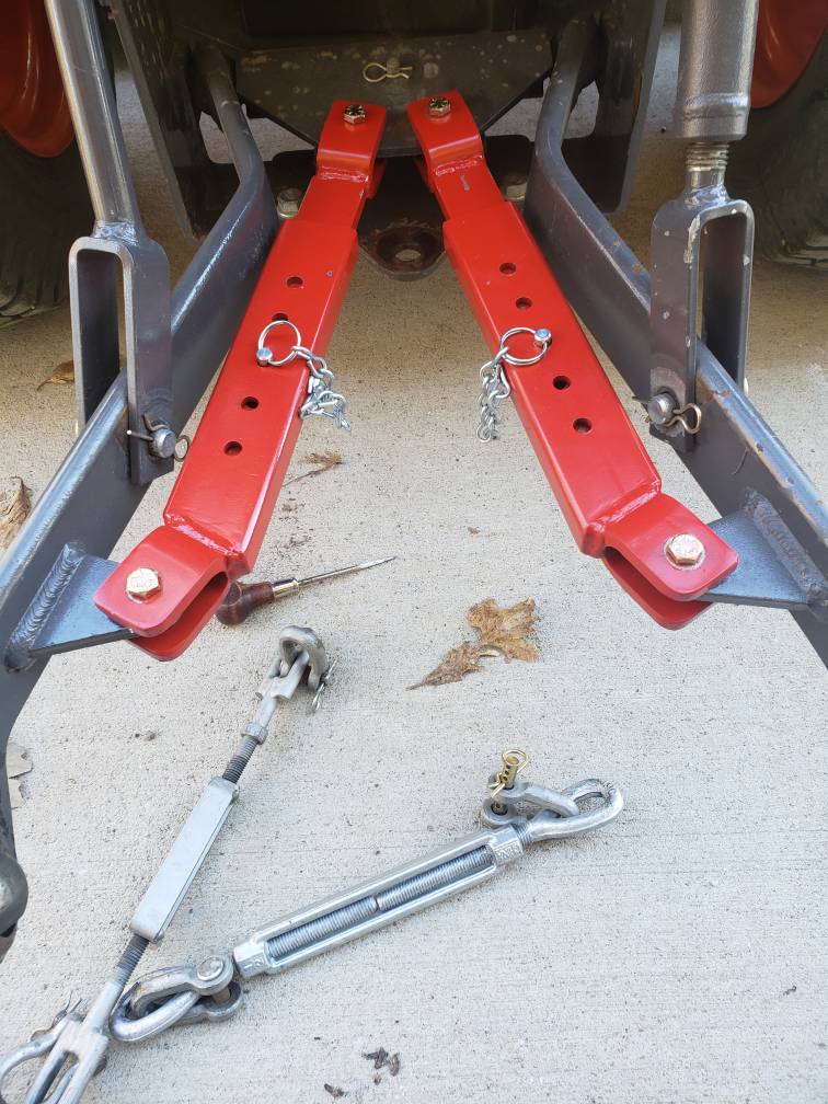

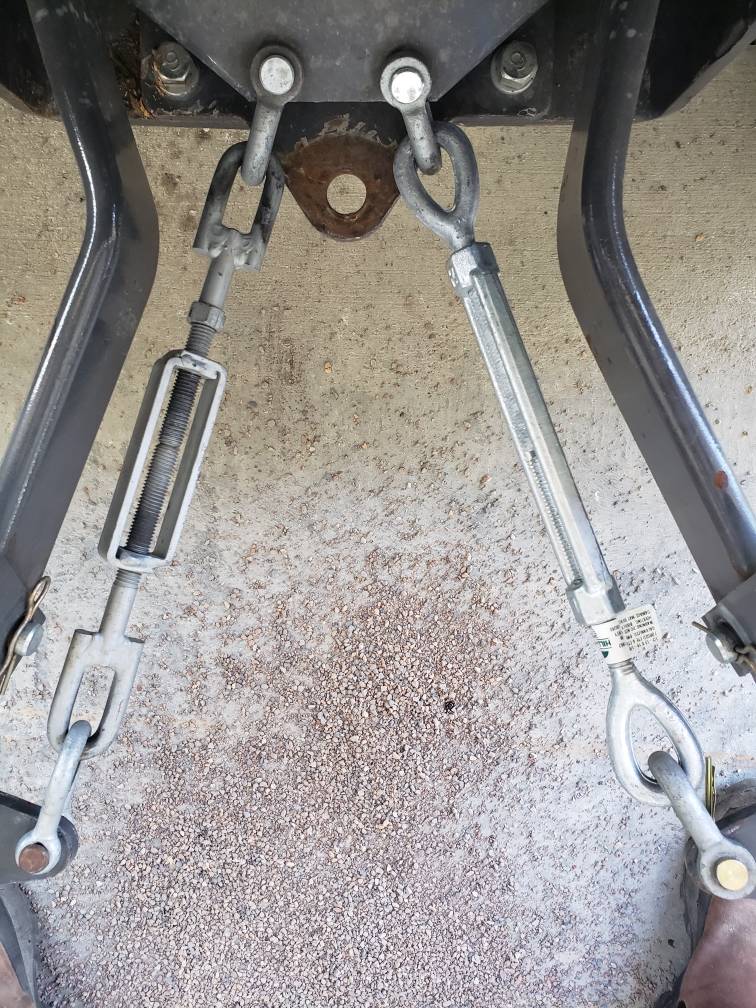

As a temporary solution I pieced together a turnbuckle, clevis, and pins from tsc. For a permanent solution I placed an order for a set from stabilworks. I highly recommend stabilworks!

Downloaded app so I can attach pictures. First picture shows stabilworks installed and you can see a little bit of temporary turnbuckle on the ground. Second picture shows stabilworks by themselves. Third picture shows temporary turnbuckle clevis and pins installed. Hope that helps. 20191025_144529.jpeg20191018_162807.jpeg20190510_162806.jpeg

I don't have a backhoe so I've never tried to fold them up. I suspect they won't fold up quite as easy as the floppy turnbuckle clevis and pins but will defer to others with more experience.
