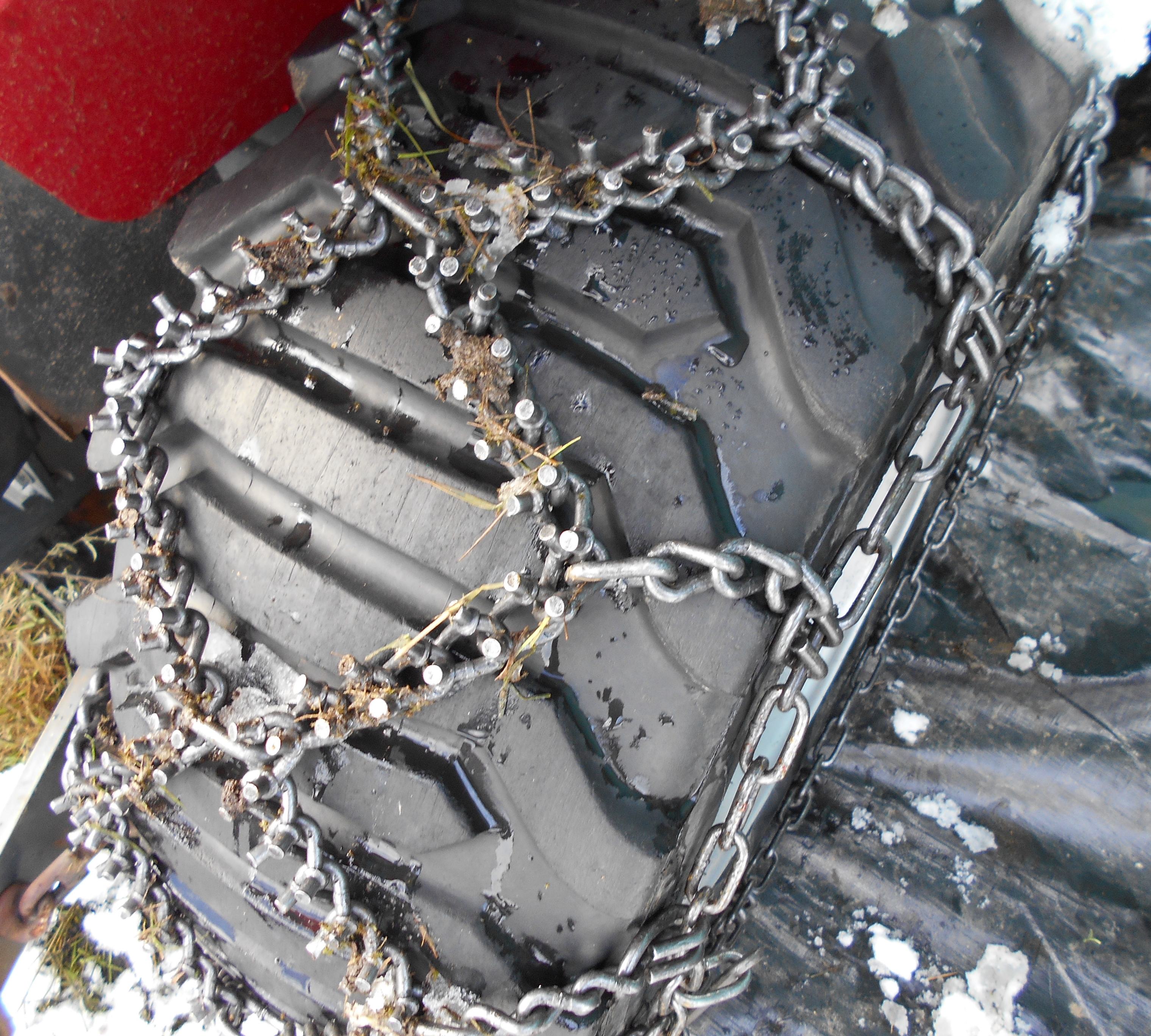

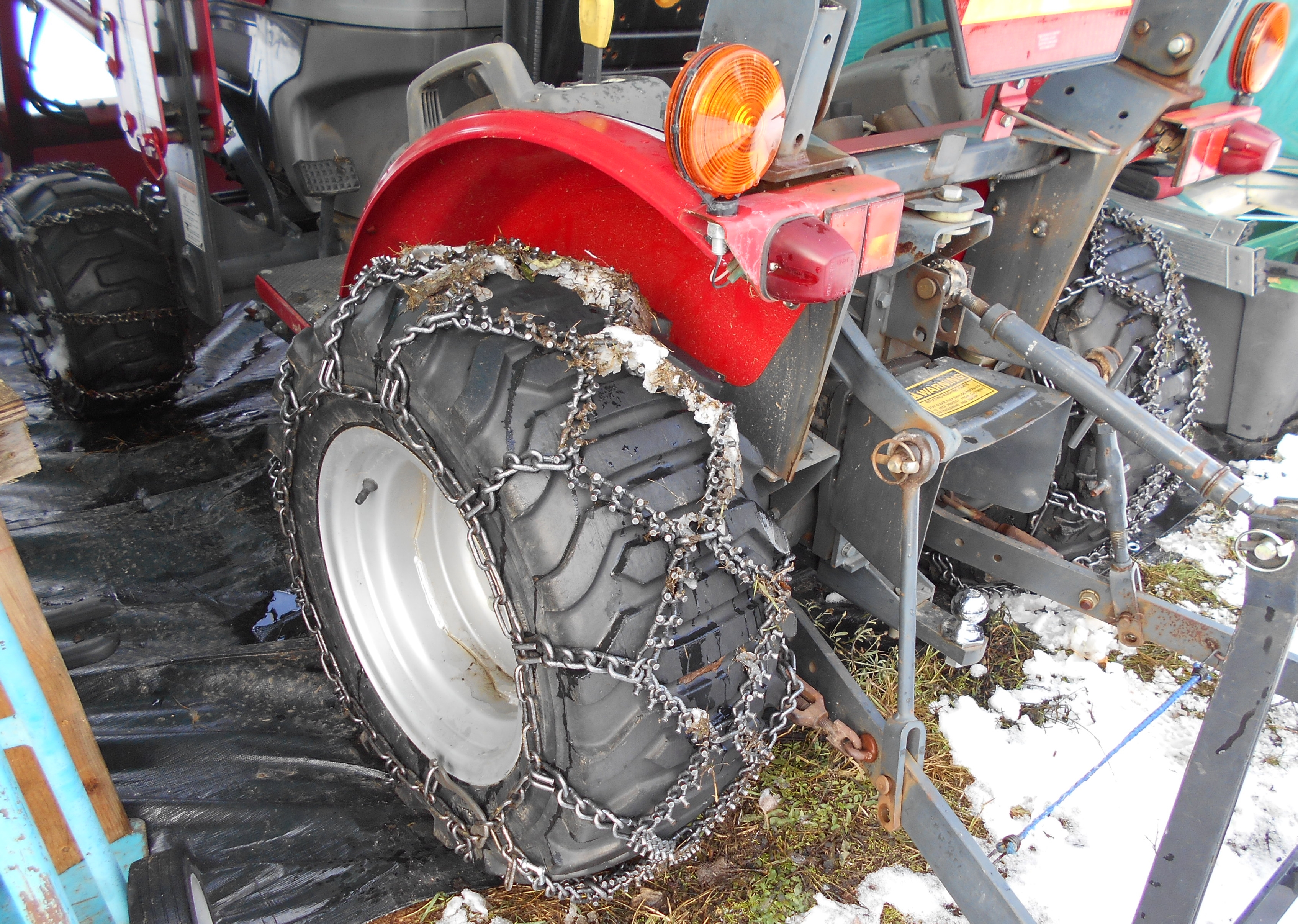

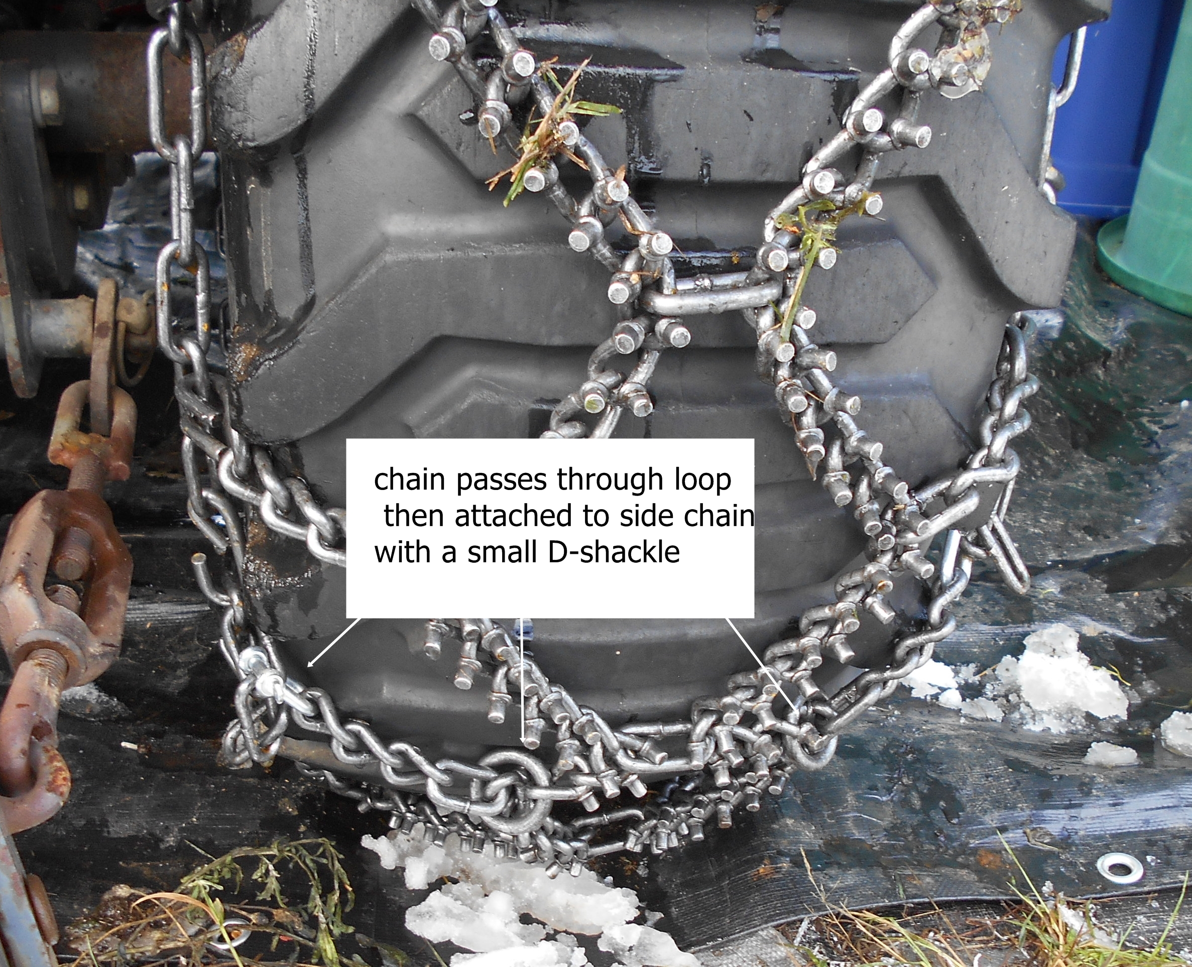

Got a foot of the white stuff two nights ago, forcing me to install the new rear chains. Looked pretty simple but I soon realized that I didn't have a clue so off to YouTube for help. I wasn't sure what to do with the rings and D-shackles - I think this is correct?
Anyway, they are installed and I can't believe the difference - I can go almost anywhere on our property. Last winter, with just front chains, I got stuck a lot and forget plowing.
I'm a happy camper. :thumbsup:
   / 1815 rear tire chains #15
Good looking set of chains,
what brand are they.
It is amazing what full contact studded chains do for traction,
both going and whoaing.
   / 1815 rear tire chains #17
Great pics. I have a front and rear set and when I need them they make all the difference. I don’t need them often but they are ready and pretty simple to put on.
Bungee straps make a big difference too.
Harbor Freight has various sizes very inexpensively priced.
   / 1815 rear tire chains #18

Looking good, Wes. I'm still waiting for rear wheel spacers so those chains will fit. Hoping for lots of snow to go with the predictably unprepared folks around here $$.
