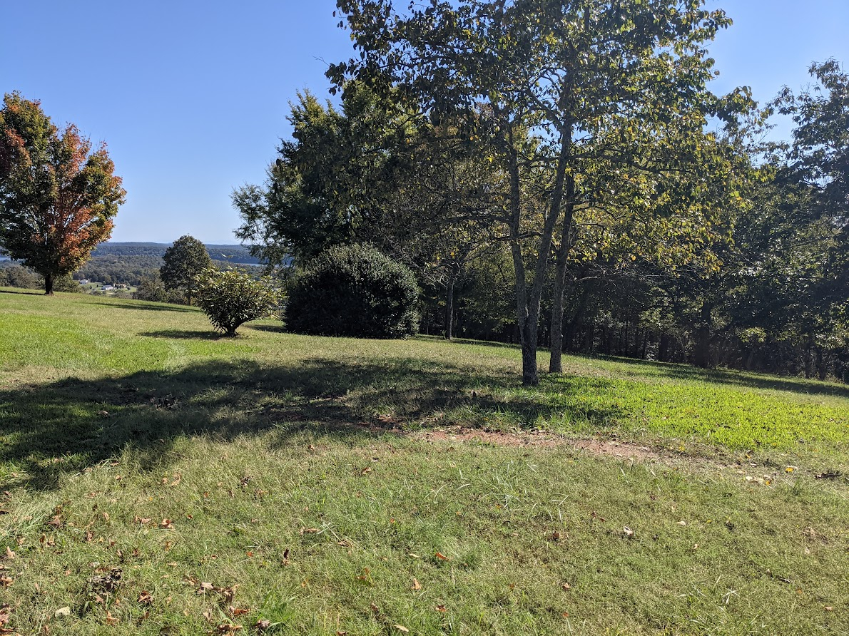

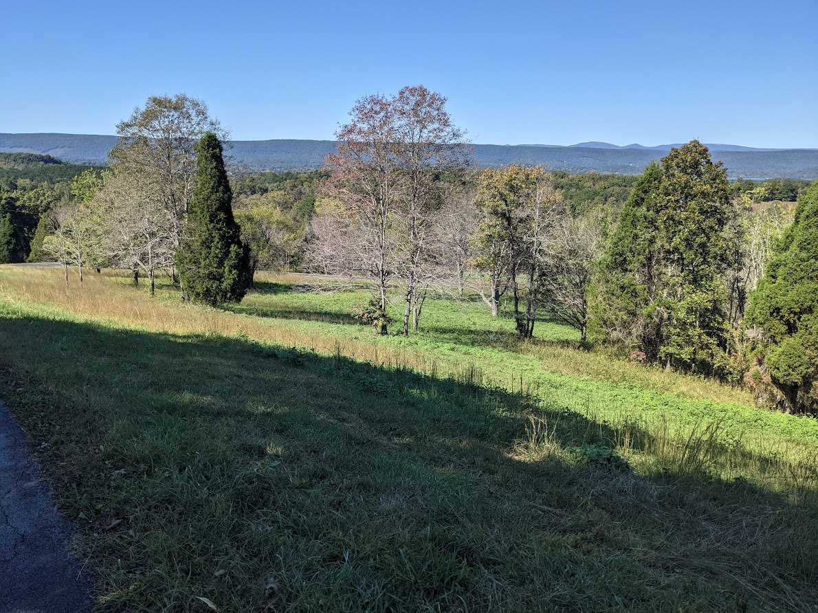

It's a grass pasture. Some of it needs to be bush hogged still, but the intent is to have more grasses in the fields and less brush. I will till, harrow , power rake or whatever as I learn more but we want it to be more grass like and mowed often. PO just let it grow and it is a lot of goldenrod and blackberry brush right now, except for the areas I have cleaned out.
Here are some pictures
This area is very sloped, with some areas over 35 degree but not all of it. Measured with a contractors laser thingiee :)
This will be mowed often
This is one side of the house yard, the side with the most obstacles. I am wanting to mow all the way to the tree line.
Knowing that somehow pictures don't capture elevation well, but it for sure needs a slope mower in the front pasture. I am not going to kill myself on the tractor with a rollover just for a lawn. :)
Edit to add:. I've been to the factory. I could only demo the 1850 and it was impressive. No 1845 were available for demo. This would be a second tractor, I would keep the Branson. The Branson mowed everything in the first picture but it was a real puckering experience.

Yeah elevation and slope are hard to capture in pictures but I think you got it pretty well actually.
For what you've got there I'd rather have a PT-anything over a ZTR for sure!
The PT-1850 is rated for steeper slopes (45 degrees) than the PT-1845 (40 degrees) some of which is in the engine being more tolerant of the slope without starving for oil. Either way you're going to want to be buckled in so you stay under the ROPS if something unexpected happens. And if you can, you'd of course want to mow up and down that slope rather than side to side.
Looking at the price list, there's a big jump in HP between the two - 65 HP for the PT-1850 and 45 HP for the PT-1845 - so one way of thinking about it is that you get 44% increase in power for a 22% increase in price. If your wallet can handle both, the PT-1850 might be the better deal thinking of it that way.

Yeah the 1850 is certainly the better value, but if I buy that I think I will need to keep the zt for the house yard. 1850 will for sure be to big
