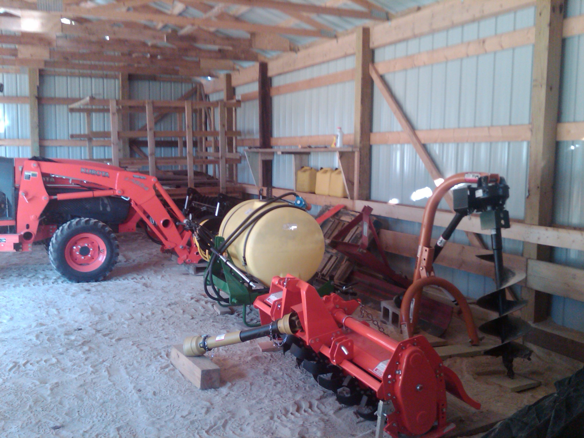

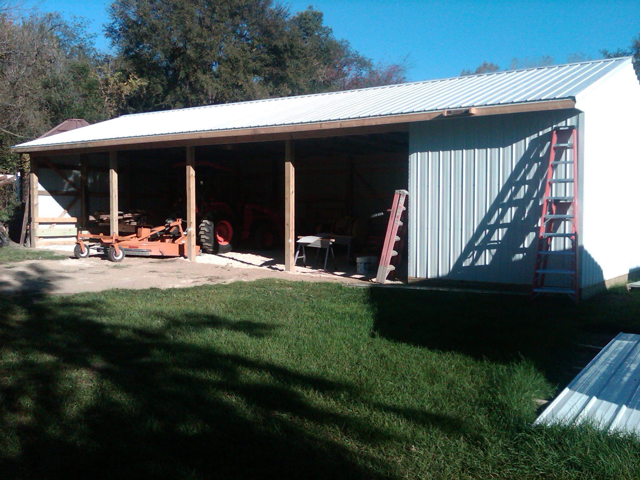

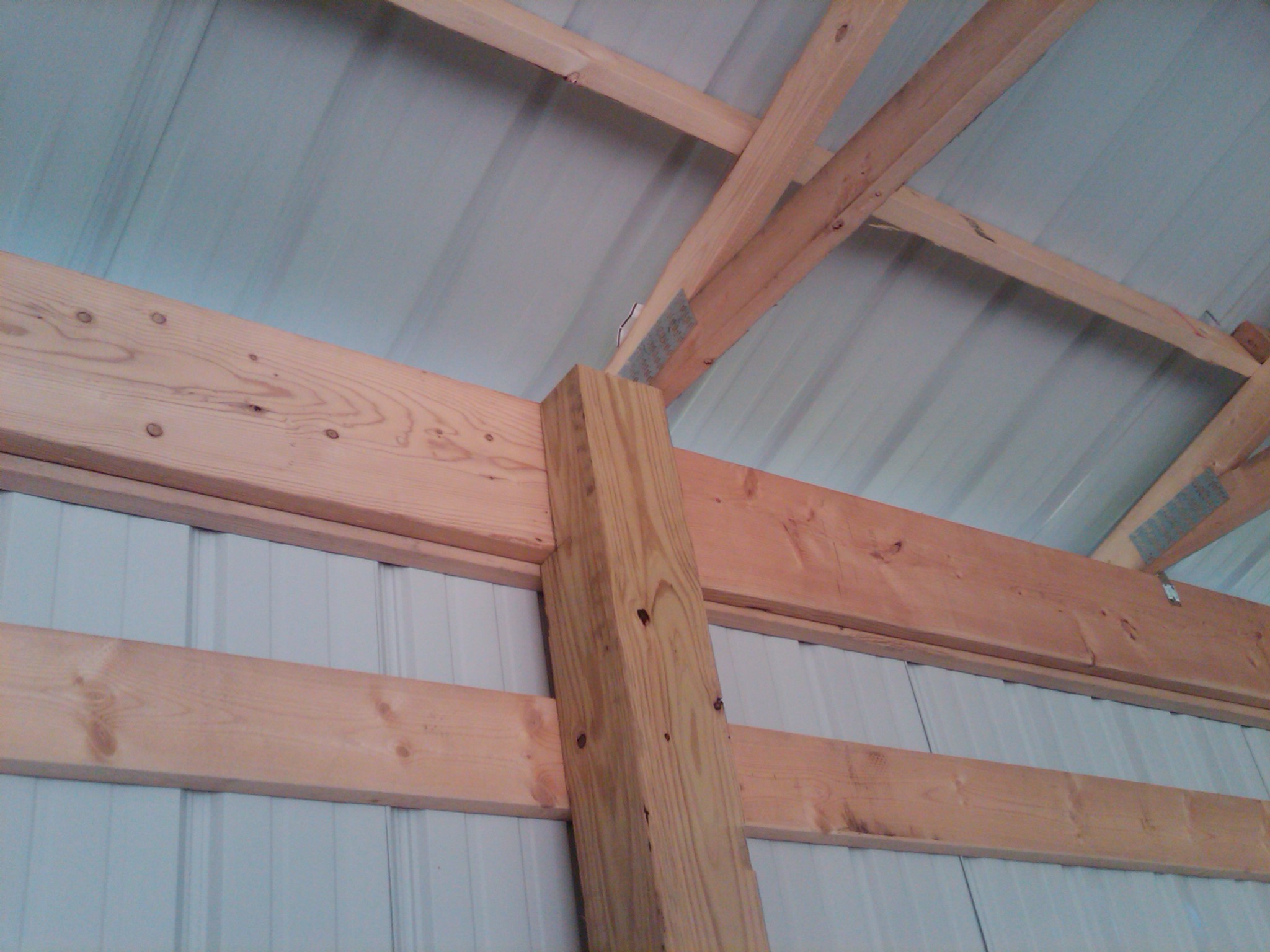

This is 24 x 52. The last bay on left is 12 foot spacing on posts as I wanted large stuff/hay wagon in that bay. All other posts are 10' on center. Sliding doors go on in the next few weeks.
Second picture - shows equipment parked and boards for bottom four feet of shed.Went around inside of shed and lined with boards to prevent putting holes through the tin from inside out.
Third Picture - Trusses coming down to posts show that we notched the top of posts with a chain saw to accommodate 2x10 header. Hurricane clips on all trusses. Also shows 2x4 purlins on side. Pre-drilled purlins to accommodate large pole barn nails. Prevents a lot of splitting.
Filled cavity between bottom boards (treated) with ag lime to give more strength in case of a slight over run with bucket or whatever.

Hey is that a nail that missed?
   / 18x24 Equipment Pole Building question... #27
It must have been my neighbor:laughing: If you would have seen some of our goof ups...you would have thought the three stooges were fully employed!:D

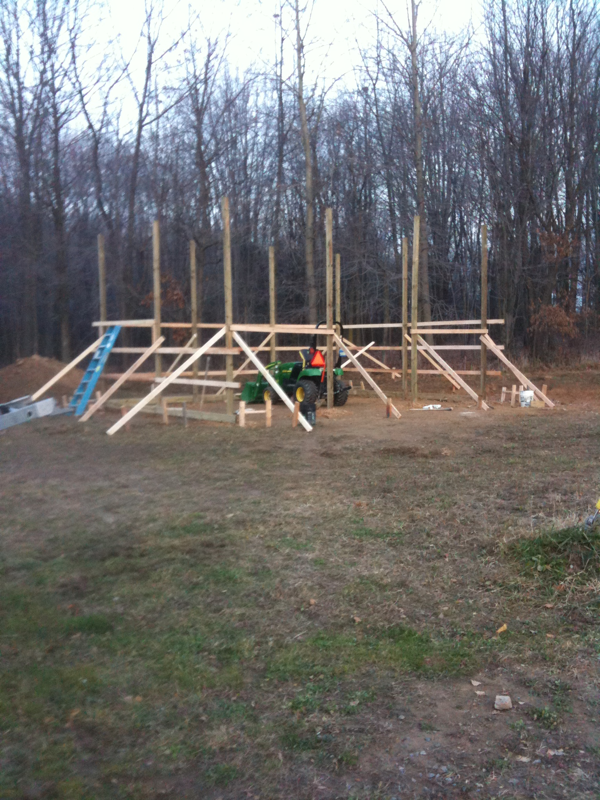

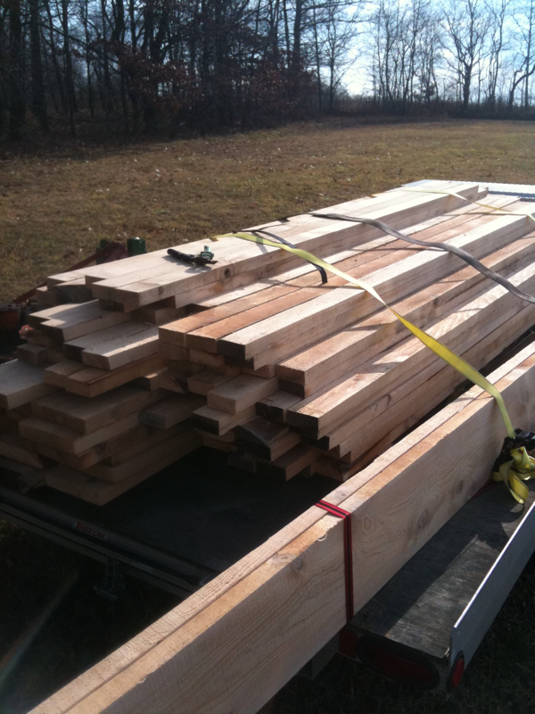

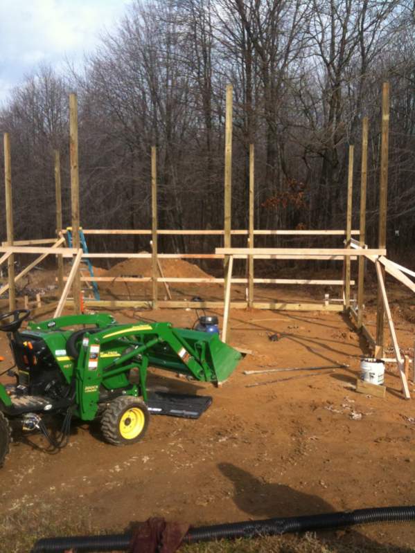

So, it's been a while, buy was finally able to get a start on my building. Unfortunately, right after I started on it, the Pennsylvania 2 week deer season started and we got nailed with snow! With that said, this is what i have accomplished.
The posts will be cut way down, as I am only planning for 8 ft high openings, but 12 foot posts just were not long enough so I had to buy 16 footers...
I also included a pic of the hemlock framing lumber..
are you sure you will never get a bigger tractor
