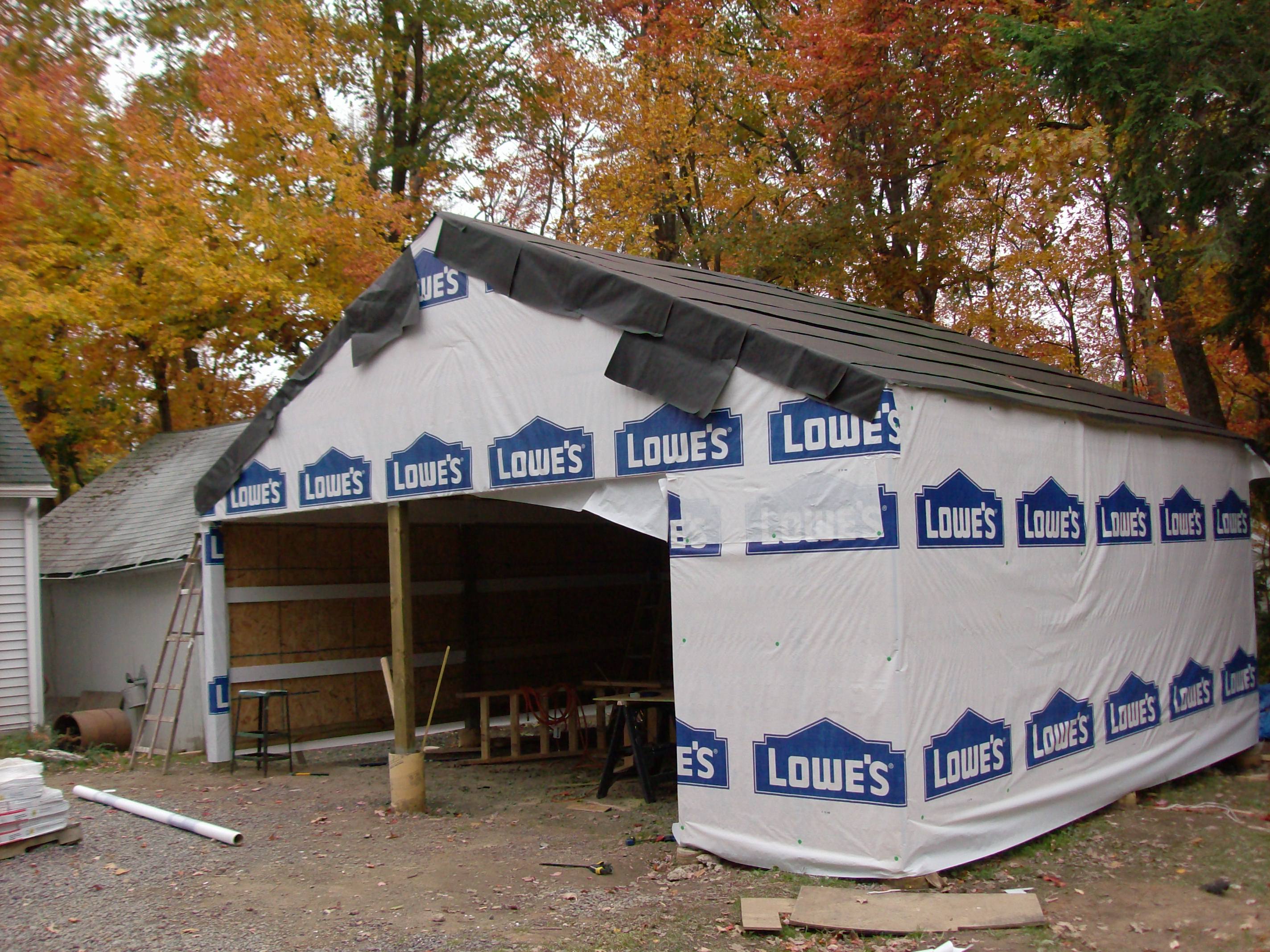

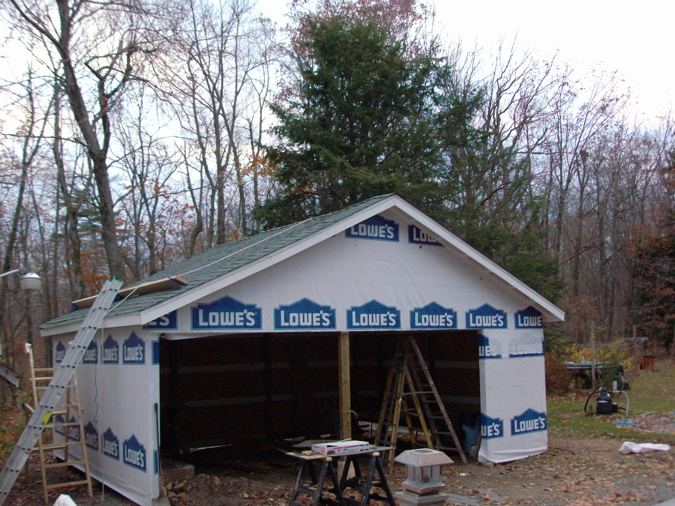

here are some pictures.i ended up cutting out the middle post and put in a new post for a 16ft door.i used osb for the sides and roof 24in on center for the trusses. the wife wants vinyl siding to match the house.metal would have been much easier.oh well keep the little women happy.and for anyone who wants to use trusses 24ft wide built with 2x6 is the most one person can handle and they hurt like heck if they slip don' ask.
Looks good!! I was lucky and my wife wasn't concerned about what I sided it with, as long as it doesn't look like Crap!! Not too much pressure... I haven't decided if I'm going to stain the hemlock with a natural color stain, or stain it white to match the house?? Either way, I plan to trim it out in green to match the steel roof.
Sounds like the truss incident was a little painful...lol

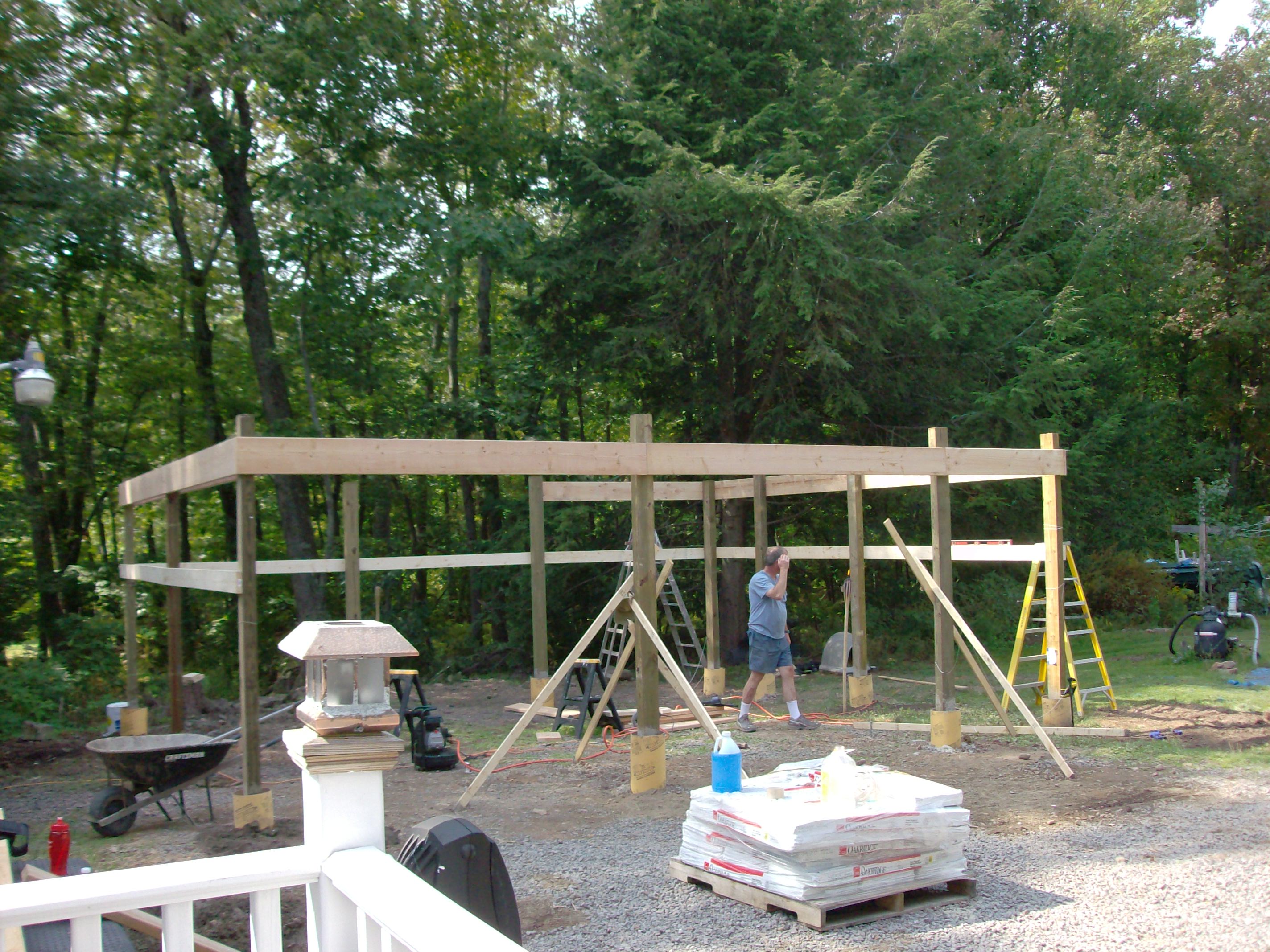

Anyway, my youngest boy and I have been able to get some work done the last couple of weeks ( in between the rain storms)... We just got three of the seven rafters/trusses up today, so I'm happy about that!
More to come!!
