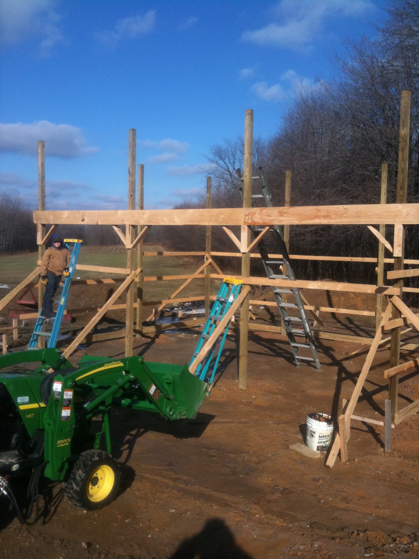

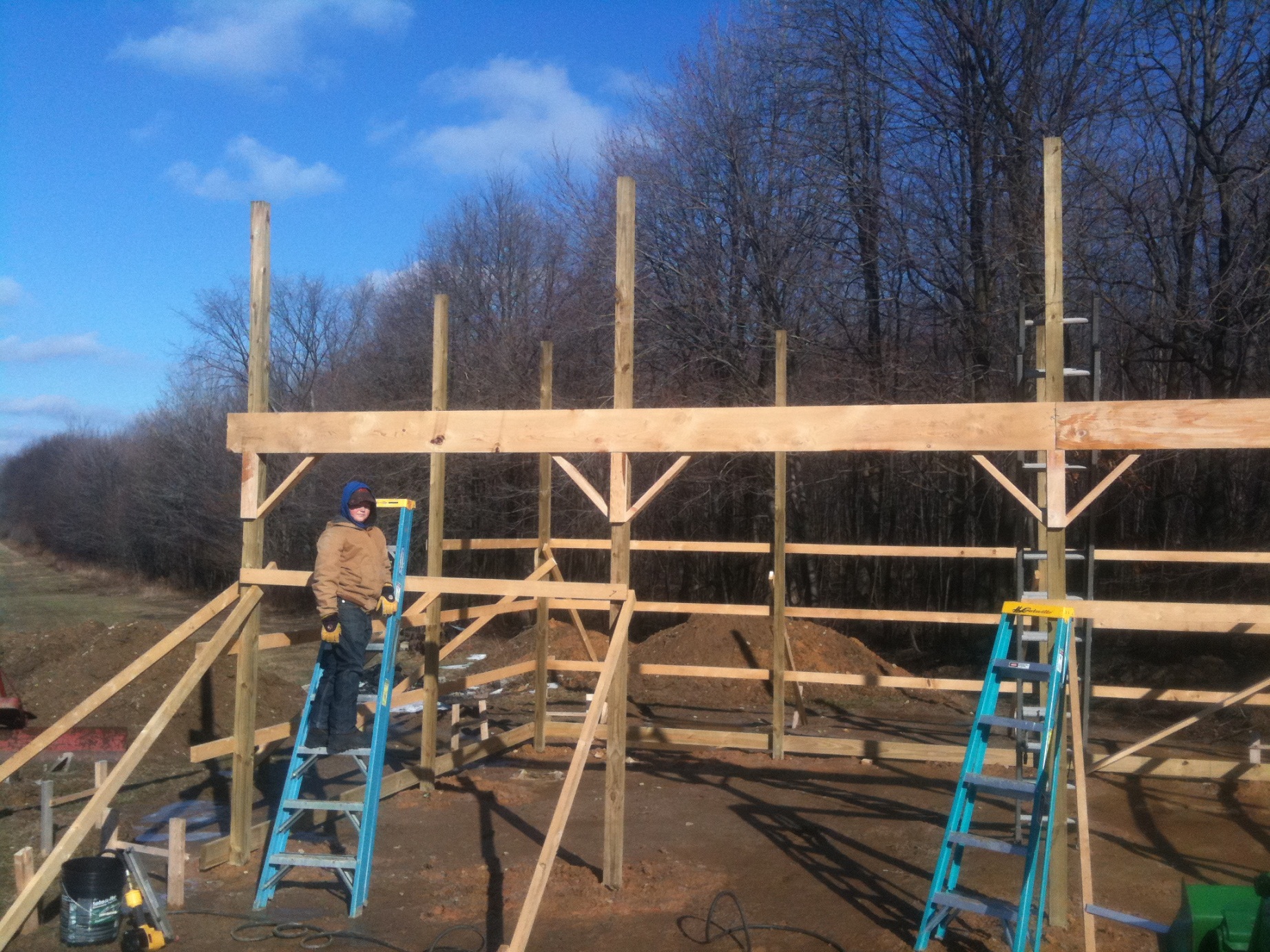

So, back to the equipment shed... I don't know that i have mentioned it yet, but my primary assistant on this project has been my 13 year old son, who is more than willing to help me, but his smaller size sometimes makes it difficult to handle this heavier hemlock lumber! lol This was quite evident today when we were setting a 16' 2x10 (a true 10" wide board).

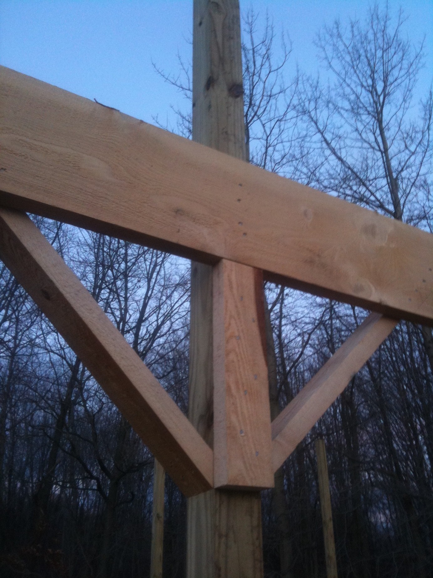

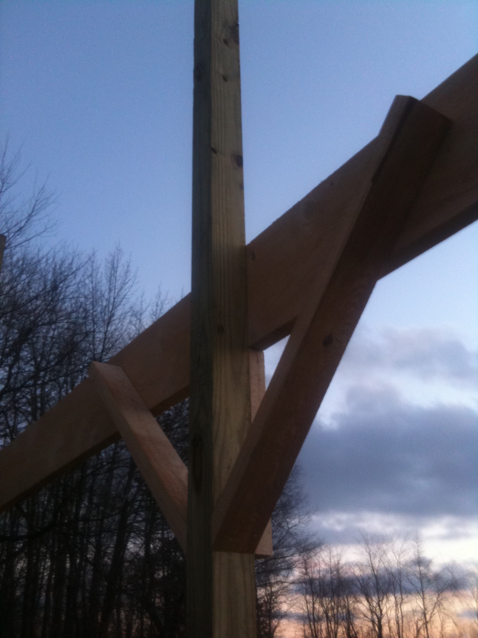

I wanted to get some thoughts on how I was planning to construct the headers and roof rafters...
Here is what I currently have for the header construction, but I wanted to get some opinions on whether or not it would be adequate for the rafter support. I'm only placing the rafters every 4 feet, so there will be only one rafter between the posts. The header is a 2x10 (the 10 is a true 10" width), with 8 feet between posts.
Since i'm building rafter boards, I'm not sure the birds mouth would even extend back far enough back to hit another header board on the insides of the posts, but i'll know that for sure when I get to the point of cutting the rafter boards (2x8's, true 8" width).
   / 18x24 Equipment Pole Building question... #36
Most ones I have seen have had 2 boards and at least 1 has been let in to the post to carry the load not putting the nails all in shear load.
tom
   / 18x24 Equipment Pole Building question... #37
That's the beauty of polebarn construction--you can set that inside header higher to just catch the rafter.
#38
Yes, that's very true, and I like that idea! Once I get all of the rafters into place, I can just go back and quickly install the inside header. Thanks!
