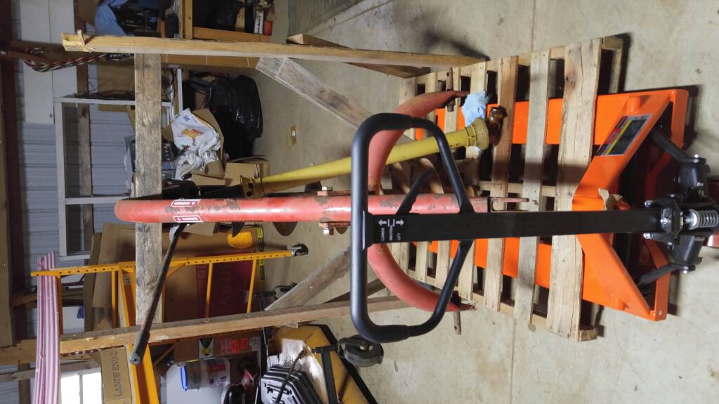

20160314_180206_phd_MD_Home_.jpgthe cross piece the phd hangs on is just screwed into the uprights. I hook up to tractor, raise phd, then unscrew this piece. I rarely use it, or i would put a saddle on the uprights so i dont have to unscrew.
