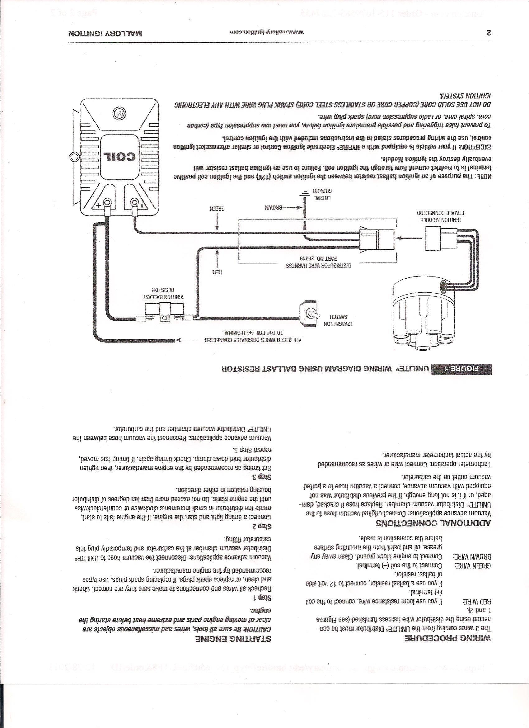

Oh Oh, can't get spark out of Mallory 8555101C billet distributor and it did not come with a wiring diagram, it is meant for a car connector. Anyone got any knowledge of these?
   / 1952 Ford 8N 302 v8 conversion #97
Does it have an internal coil... You may need an external coil.... and resistor... Now you know all I know..... almost nothing...
Dave
#98
It does have an internal coil. There are three wires coming out of the distributor, brown, black & red. These go to a connector block under the built in coil. There are 5 terminals under the connector block. We are trying to figure out what goes where? We think black out of distributor goes to ground, not sure about rest. Couldn't find any good diagrams at mallory or google.
Dave
   / 1952 Ford 8N 302 v8 conversion #99
I couldn't find ANY diagrams or schematics... Are there any symbols where the wires enter the housing...
   / 1952 Ford 8N 302 v8 conversion #100
Found one.... hope it helps...... Dave
