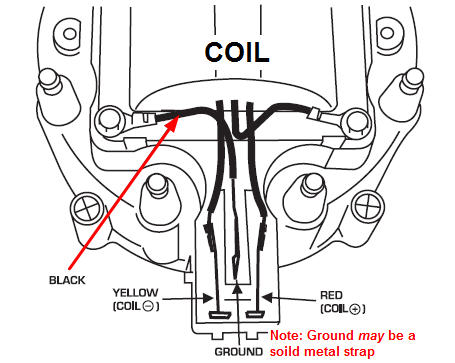

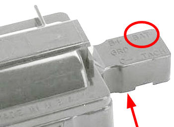

Yea!!!!
We got spark.
Whodathunk it, the Mallory distributor terminal marked - (minus) is actually the input for the tachometer!!! We had it grounded and that was killing the spark. I talked to 3 people at Mallory before I got one that understood the wiring.
Justin will be back with his timing light on Sunday, maybe we can get it running then. If we do, video will follow.
Happy New Year everyone.
   / 1952 Ford 8N 302 v8 conversion #116
heh.. tachs do indeed go on the (-) of coils :)
