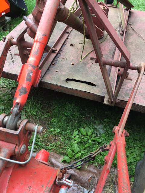

Bush hog has a rip where it looks like the blades must've sliced up through for some reason, attached a pic to show what I'm talking about.
Will head into town next sunny day next week to have the local weld shop stitch it up and weld a plate over top. Any common reason for that damage to happen?
Want to change the bush hog gearbox oil too while I'm looking at maintenance, what should I use? It's a 90-I mower.

deck should be easy to weldd up, just make sure that the blade and or hub play has been corrected.
Generically in mower gear boxes.. I like 85-140
