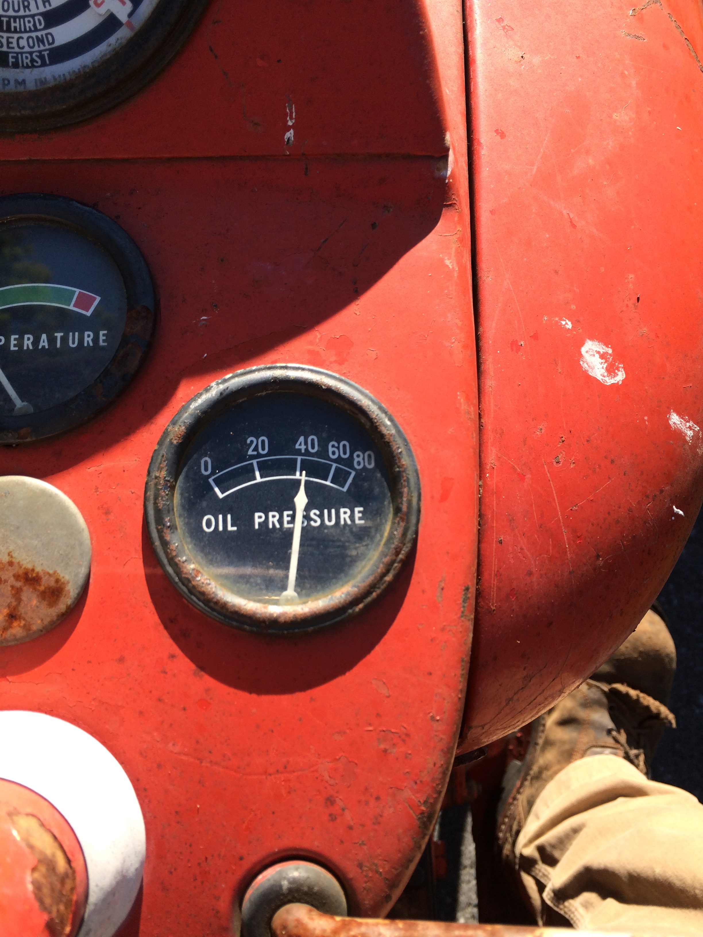

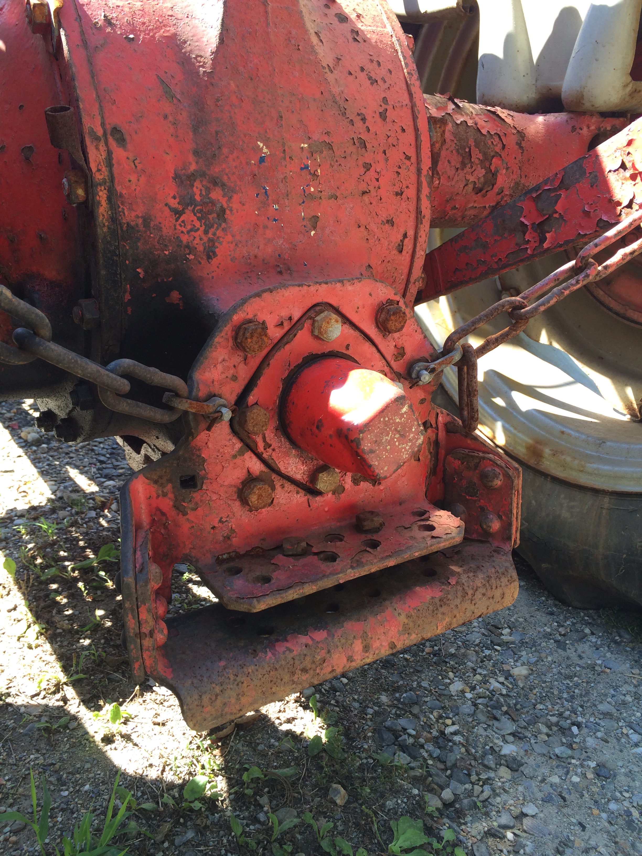

So, FINALLY was able to make my way back up to the 641 for a few hours this morning.
Flushed, drained & filled the crankcase and the hydraulic section. Ran out of time so I'll get to the transmission and differential next go round.

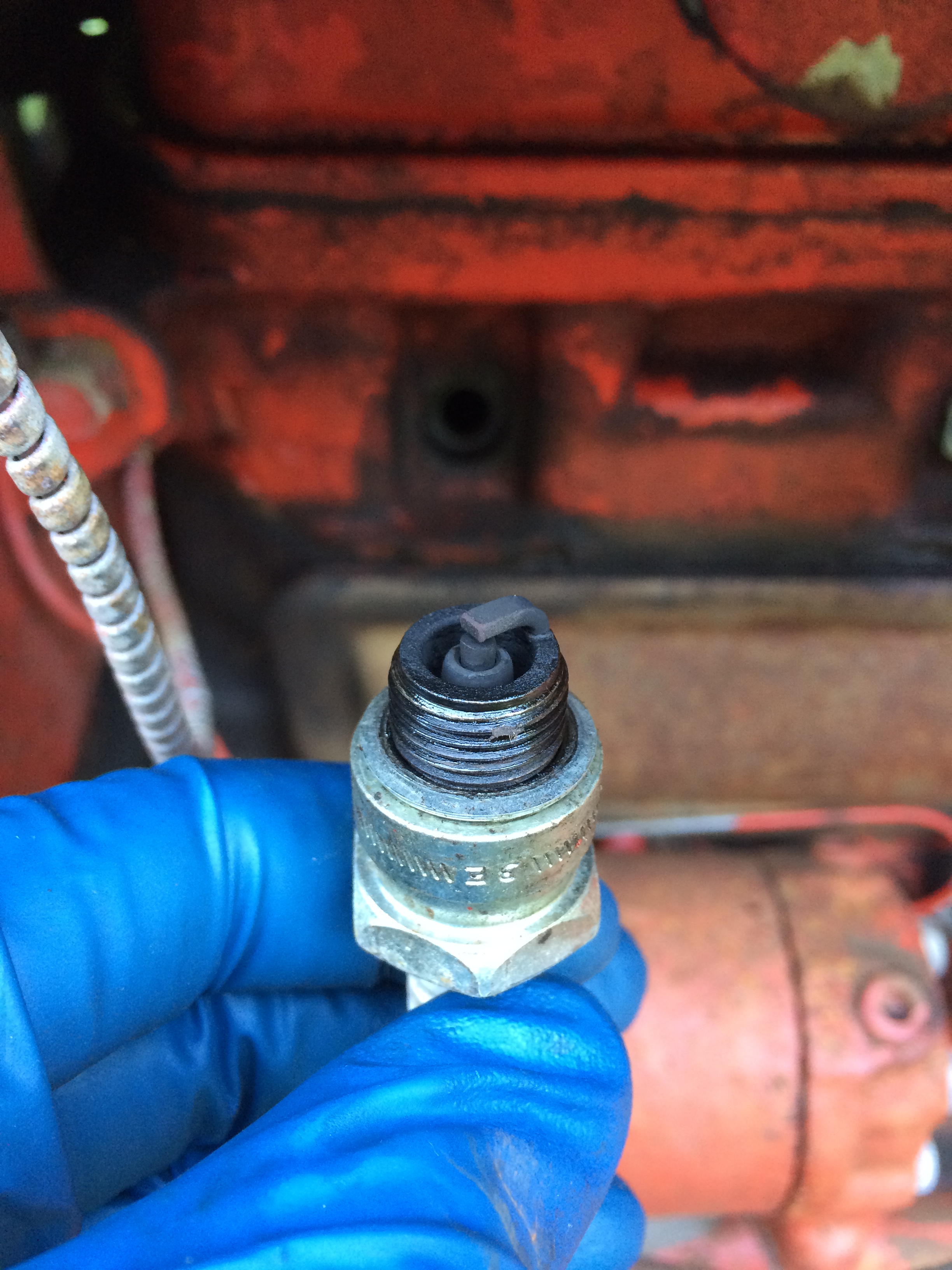

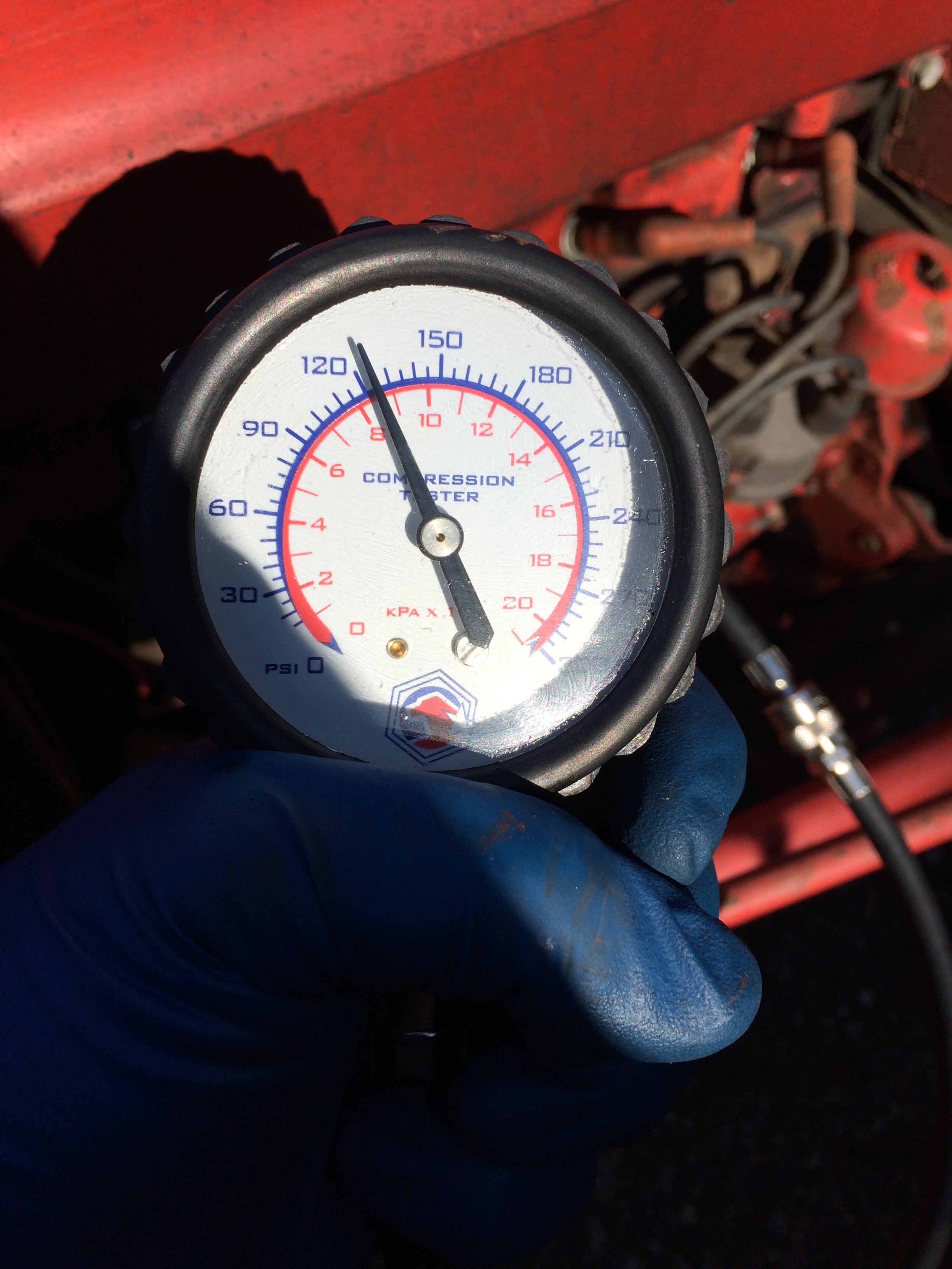

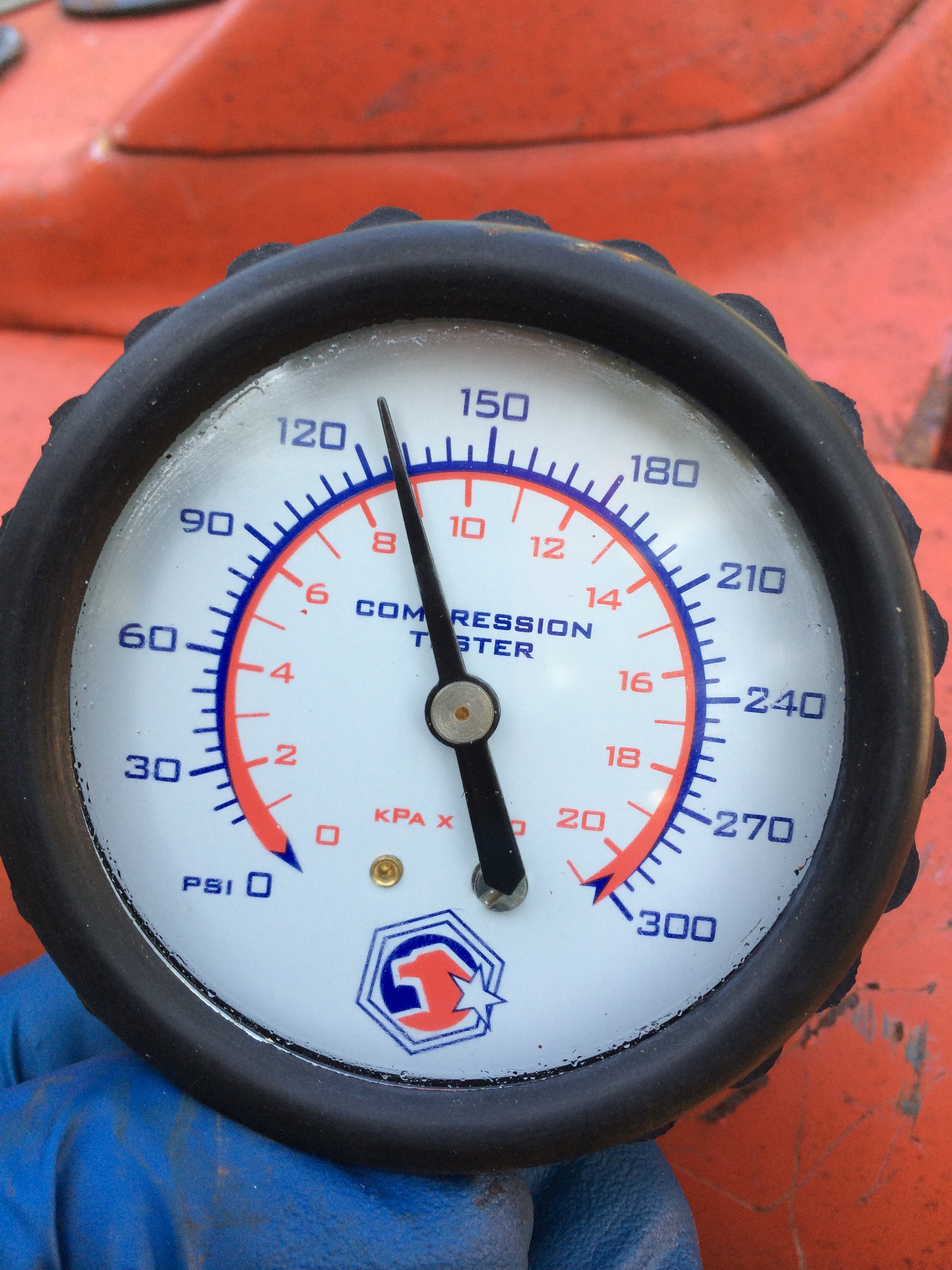

Pulled the sparkplugs, ran a compression test and installed new, hotter range NGK's.
All the plugs looked the same, well maybe the front plug looked a little bit wet.
Compression was OK I thought, but what do I know. From the rear cylinder to the front read: 135#, 125#, 130# & 135#
Engine had been running maybe 15 minutes before I pulled the plugs and ran the test.
Rotella 15W40, came away with decent oil pressure I thought. Changed out the cartridge oil filter before flush and again after.
Dave found the thread-in PTO cover which I thought was pretty cool.
3-point works like a charm now, looking forward to going back up and hanging that bush hog off it to see how it does.

normally you do a dry / wet compression test to see how valves compare to rings.. however if your numbers are dry alone.. they are fine.
