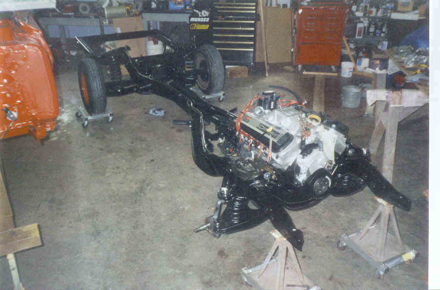

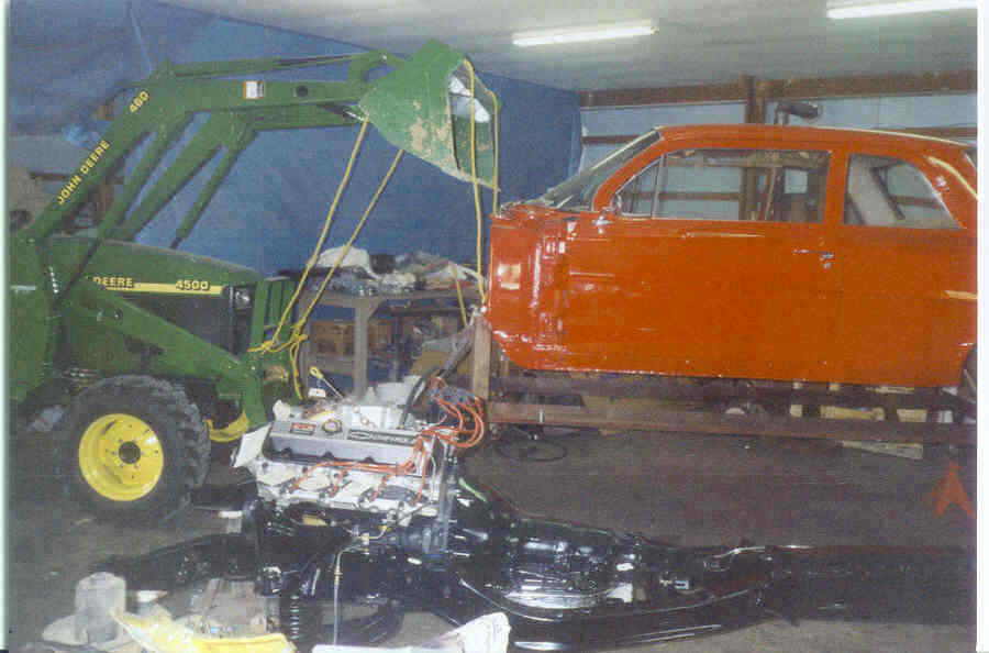

This project car appears to have been re-inforced
Yes, the "X" generally isn't connected in the middle except by a carrier bearing holding the long drive shaft up. Here are a couple of pictures of my '62 Biscayne frame that has a similar frame.
Well, I couldn't find where I'd scanned in a couple dozen pictures of the frame alone, but if you look, you can see a similar 'tunnel' in my frame like the one in the pictured '59. That 'tunnel' was an addition by me to tie the frame together to take the additional torque from the slight engine upgrade I did. The four link rear suspension on my frame is also not as it came from the factory. However, having personally removed and replaced every single nut and bolt on the frame I really have to wonder about the video.
