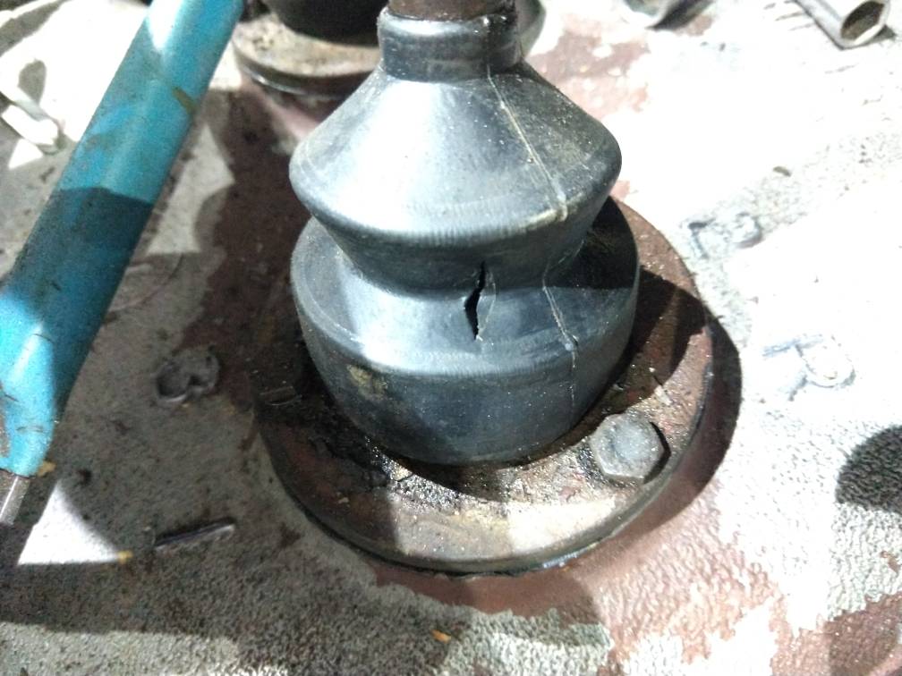

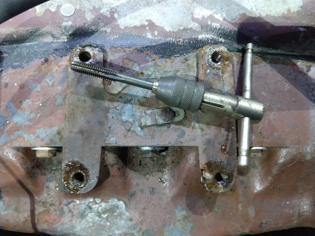

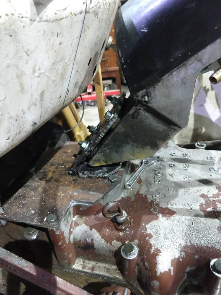

Started on the steering column bracket tonight, that went well, some pictures of how that went:
Also used a tap to clean some of the crud out of the bolt holes for the seat (the back ones had over 1/4" of crud in them):

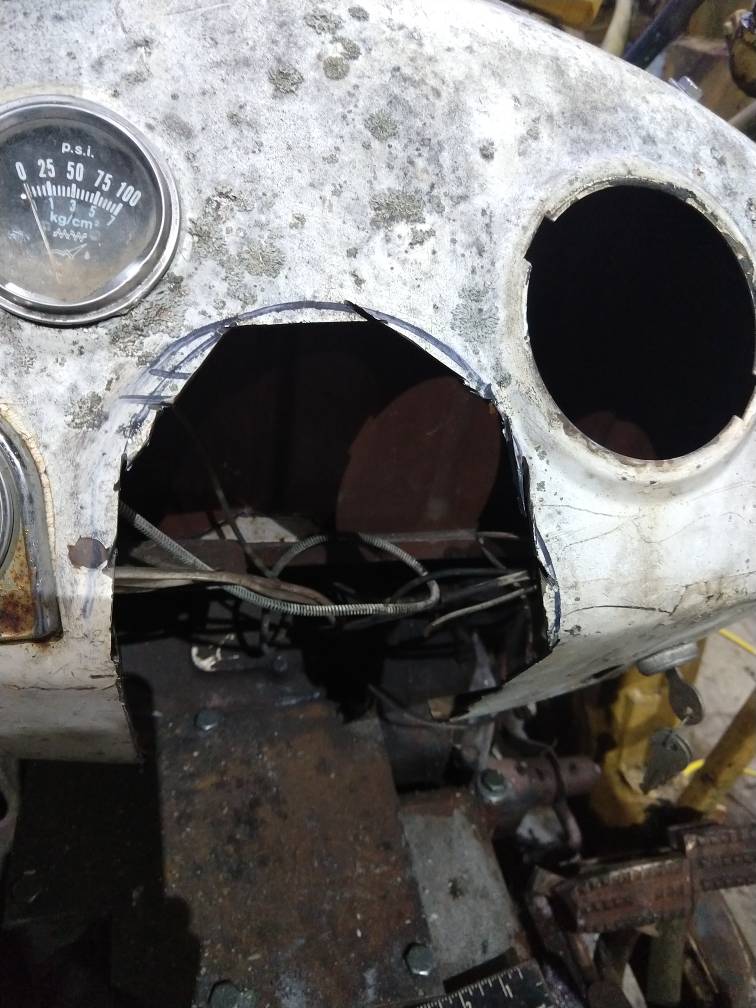

Trimming the instrument panel to fit the steering column did not go as well. I trimmed it to go with the round side to the front and it was looking great:
Then I realized that I had it backwards and the flat side needed to go forward as the hoses exit on the flat side and I needed them to exit and go forward:

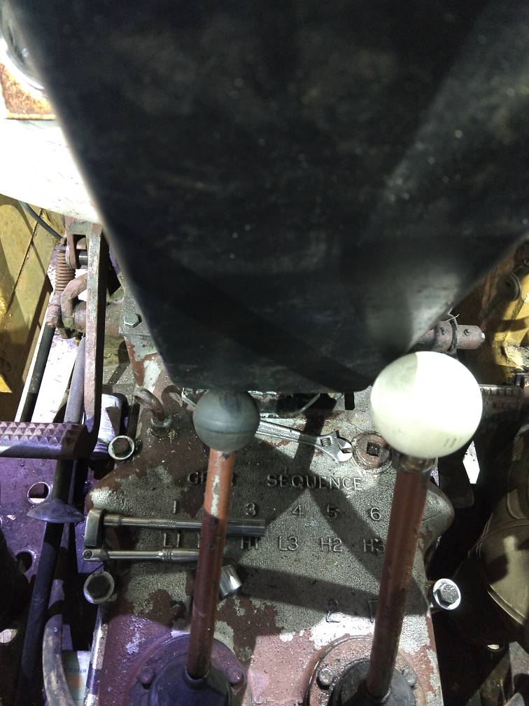

That made for some clearance issues with the shifters:
And I noticed that one of my brand new shift boots has a crack in it:
So, I think I will end up trimming the squared off black cover for what will be the front of the column to end just above the dash to cover up the unneeded round front of the hole (might also weld a patch plate into the dash, time will tell) and I need to contact the seller of the boots to get a replacement boot coming my way.

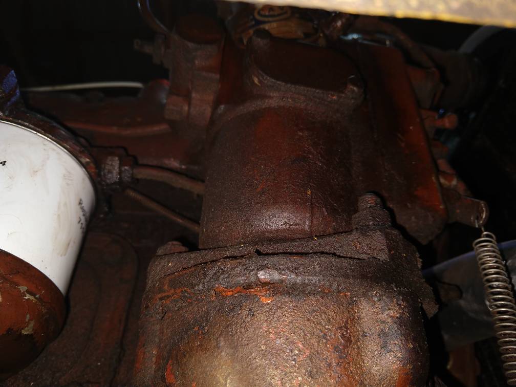

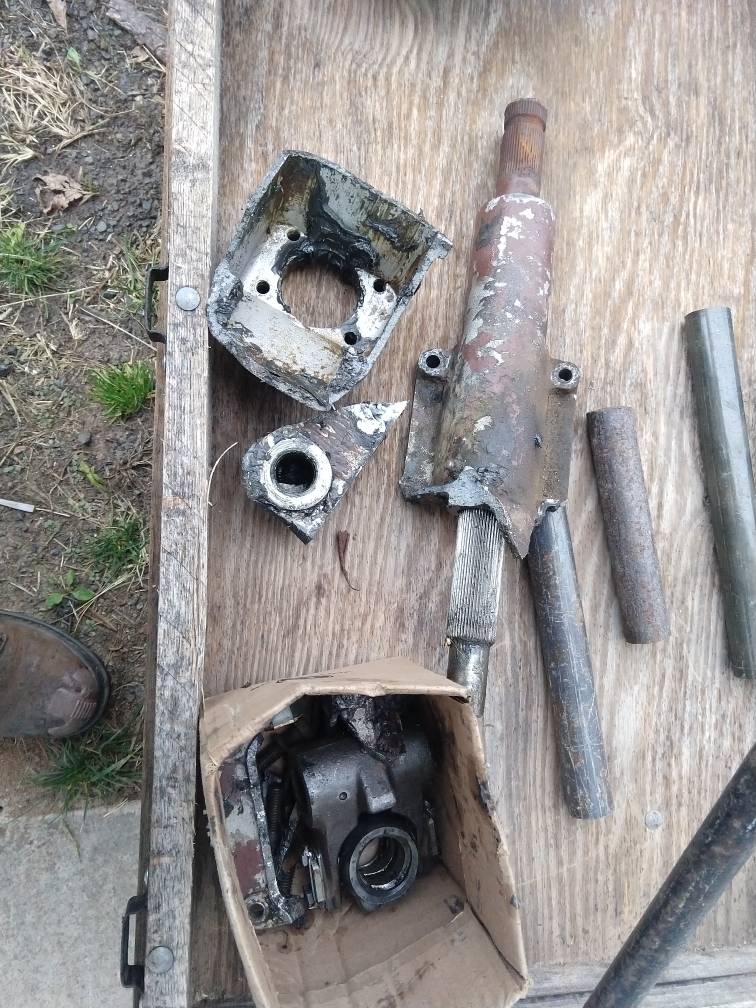

The steering box housing was shattered (and replacement parts are not available unless you can luck into someone parting one out).
It originally had a hydraulic cylinder with a valve built into the end of it that the drag link off of the steering box tied to.
As such I am replacing the steering box with a hydraulic steering column from a forklift (I had one from a forklift that a friend was parting out) and I am replacing the original cylinder with a new one.
As for the bolts, I have been surprised to find that (so far) they have all come out fine.
Aaron Z

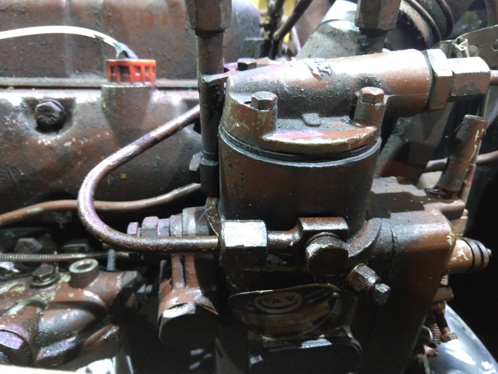

So, some injection pump pictures:
It seems to be weeping a little where the banjo bolt attaches the injection line attaches to the pump (the one closest to the camera). Not sure if this is normal seepage, if it just needs a pair of crush washers, or if there is a problem.
I put a wrench on the banjo bolt and it was not loose.
And a picture of the steering box pieces:

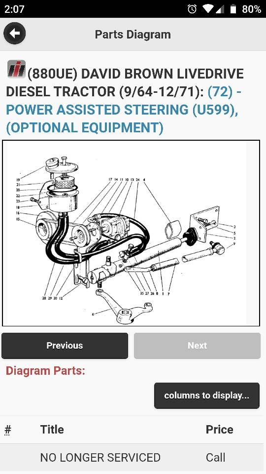

Steering has a dedicated belt driven pump, it is completely separate from the other hydraulic systems.
Aaron Z

hmm. that is an excellent idea, the belt driven pump. i would like rear remotes and i have loader and power steering on a priority valve right now. could use a belt driven pump for one of them.
i also like seeing the restoration threads. thanks for posting the pictures. is it a steering pump off of a car?
   / 1965 David Brown 880UE Implematic/Livedrive Refurbishing
#20
Near as I can tell, it's a David Brown kit, it's listed in the "Steering Parts" section on the Messicks parts breakdown:
You could probably use a car pump, a remote tank would probably be a good idea though, most built in tanks aren't big enough.
