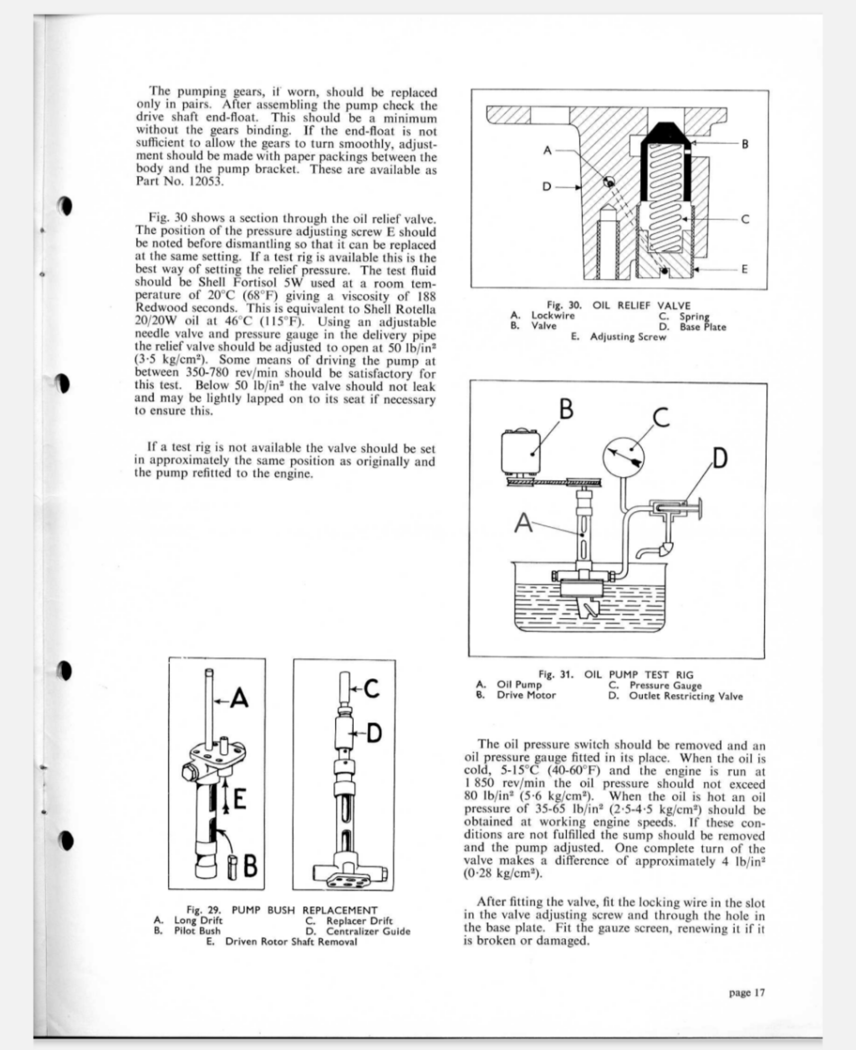

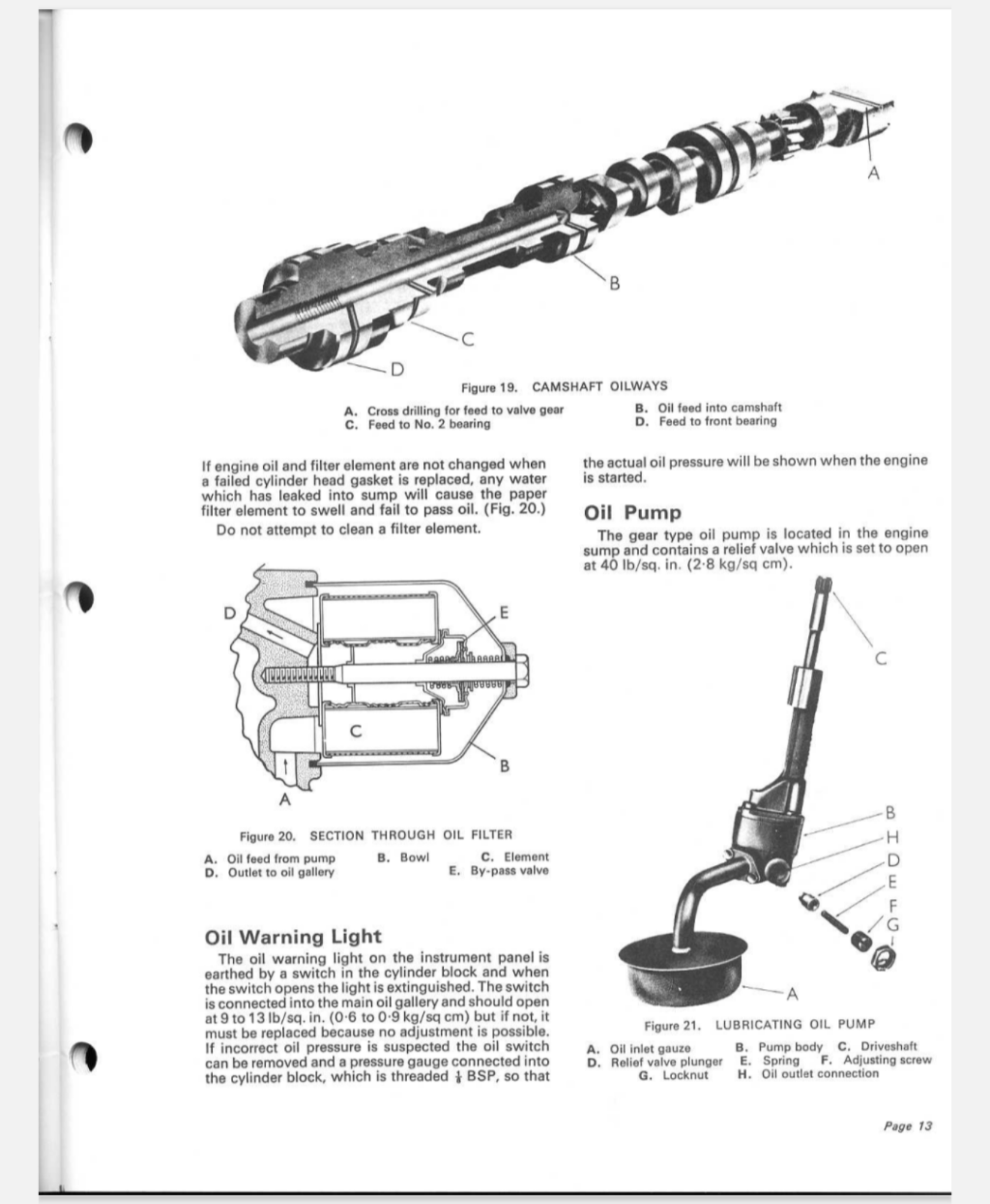

Awesome project I know I am late to the show but just bought one of these at auction. Seems to run good. But the low oil pressure light is on, and oil level is good
   / 1965 David Brown 880UE Implematic/Livedrive Refurbishing
#32
Does the oilpressure light go out if you rev it up?
I would start with sticking a gauge on it and see what kind of pressure it's making.
If it has the 3 cylinder AD3 engine it's supposed to make 9-13PSI to turn off the light per the manual and the relief valve should open at 40PSI.:
The earlier 4 cylinder engines had a higher oil pressure (35-65PSI) with the relief valve opening at 50PSI:
I will PM you a link to download the PDF copies of the service manuals, I still have a copy of them on my Google Drive.
