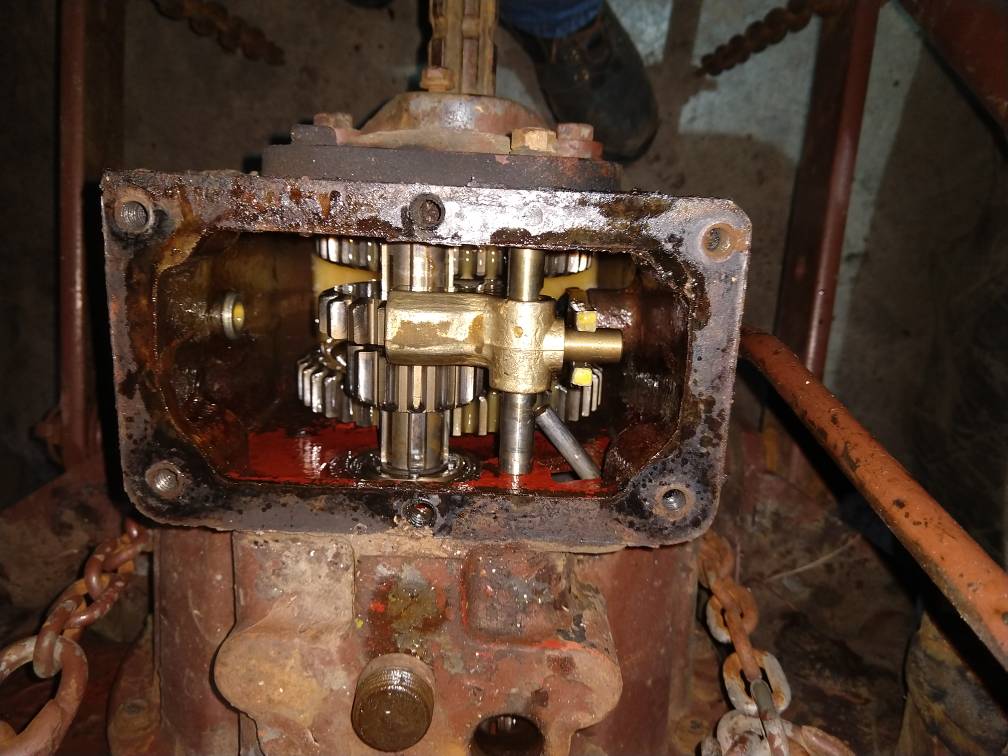

Took things apart today and found that I wasn't getting hydraulic fluid onto the PTO gears (should come out of the pipe in the bottom right corner of the gearbox in the picture below):

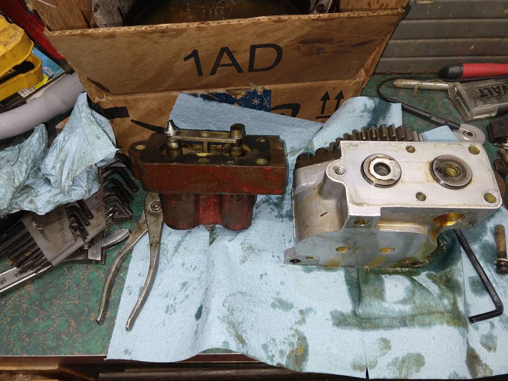

So, I took the PTO housing off (drain hydraulic fluid out of the transmission, unbolt the housing), took the pump out and removed the valve from off of the pump:
I found a bunch of the old nasty milky thick hydraulic fluid in the pump and it looked like the suction tube was full of the same, so I back flushed the suction tube then set the suction end of the pump in a container of hydraulic fluid and turn the gear by hand to flush the crud out of the pump.
I also took apart and cleaned the valve that bolts to the top of the pump, it had a bunch of crud in it and the valves may not have an opening properly.
Now I need to get a new o ring for the suction strainer as the one that is on there is stretched and doesn't fit properly, then I can put the suction strainer back on, put the cover plate back on the bottom of the transmission and reinstall the hydraulic fluid. If all goes well I'll run it for a few hours and then change it out for fresh fluid.

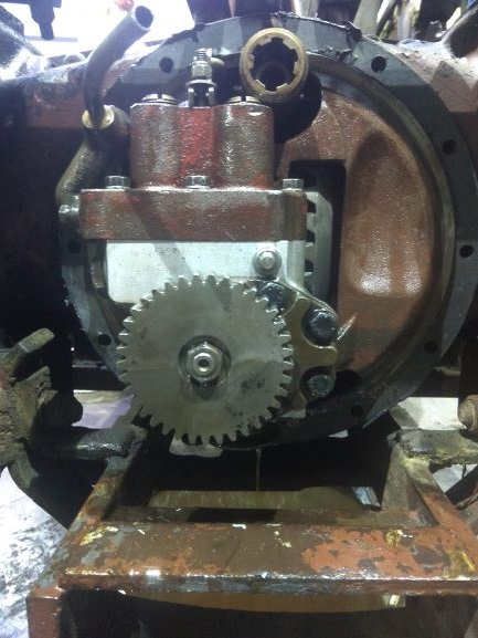

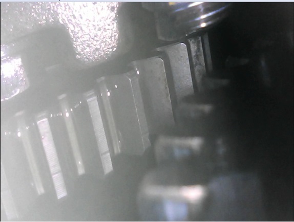

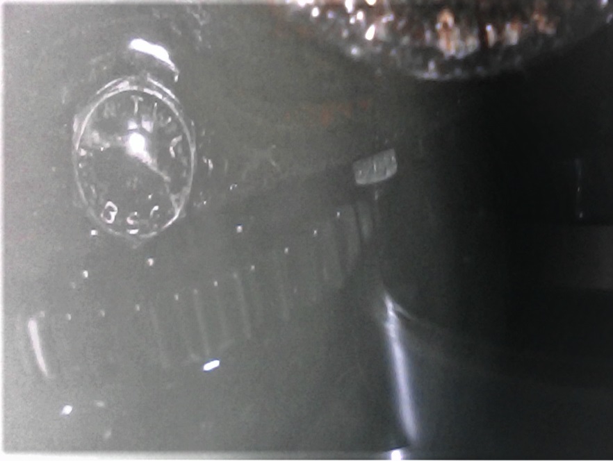

Ended up over at the David Brown Tractor Forum ( 1965 David Brown 88UE Implematic, how to prime transmission hydraulic pump? - David Brown Tractor Forum ) and after removing the PTO housing and re-installing it (twice), I stuck an inspection camera in while the tractor was running and found that the pump gear wasn't meshing with the drive gear:
attachment.php
attachment.php
I took it apart again and spent some time scratching my head as the part numbers on the gears all matched the parts breakdowns, there wasn't any other way to put the gears and there was no reason I could see why it shouldn't work.
Then tomryall said "If you had the pump apart would it be possible you put it back together wrong , maybe the drive gear and idler in the pump should be reversed, just a thought I haven't had one of these off in years"
I have not had it apart (largely because the bolts have Whitworth heads and require special sockets to remove), but there is a good chance that the previous owner had it apart.

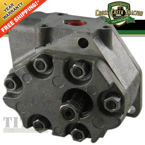

I looked at a picture of my pump:
attachment.php
And then I looked at a replacement pump online:
attachment.php

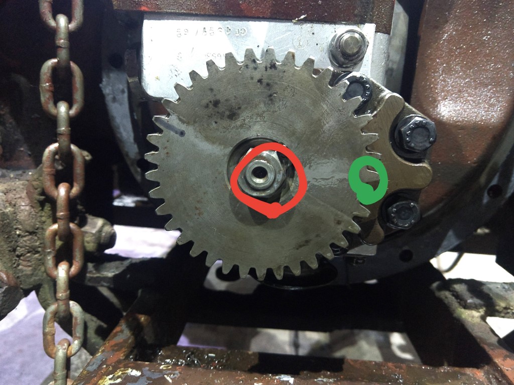

Low and behold, whoever had the pump apart last time put it together backward, the shaft that the drive gear attaches to should be on the right side (looking at the pump from the rear when installed), but on this pump, that is on the left.
In case that isn't clear, the gear center should be where the green circle (right) is, not where the red (left) circle is:
attachment.php
So, I ordered a set of Whitworth sockets, they should be here tomorrow. Then I can take the pump apart, verify wear and flip it around to how it should be and put everything back together again.
