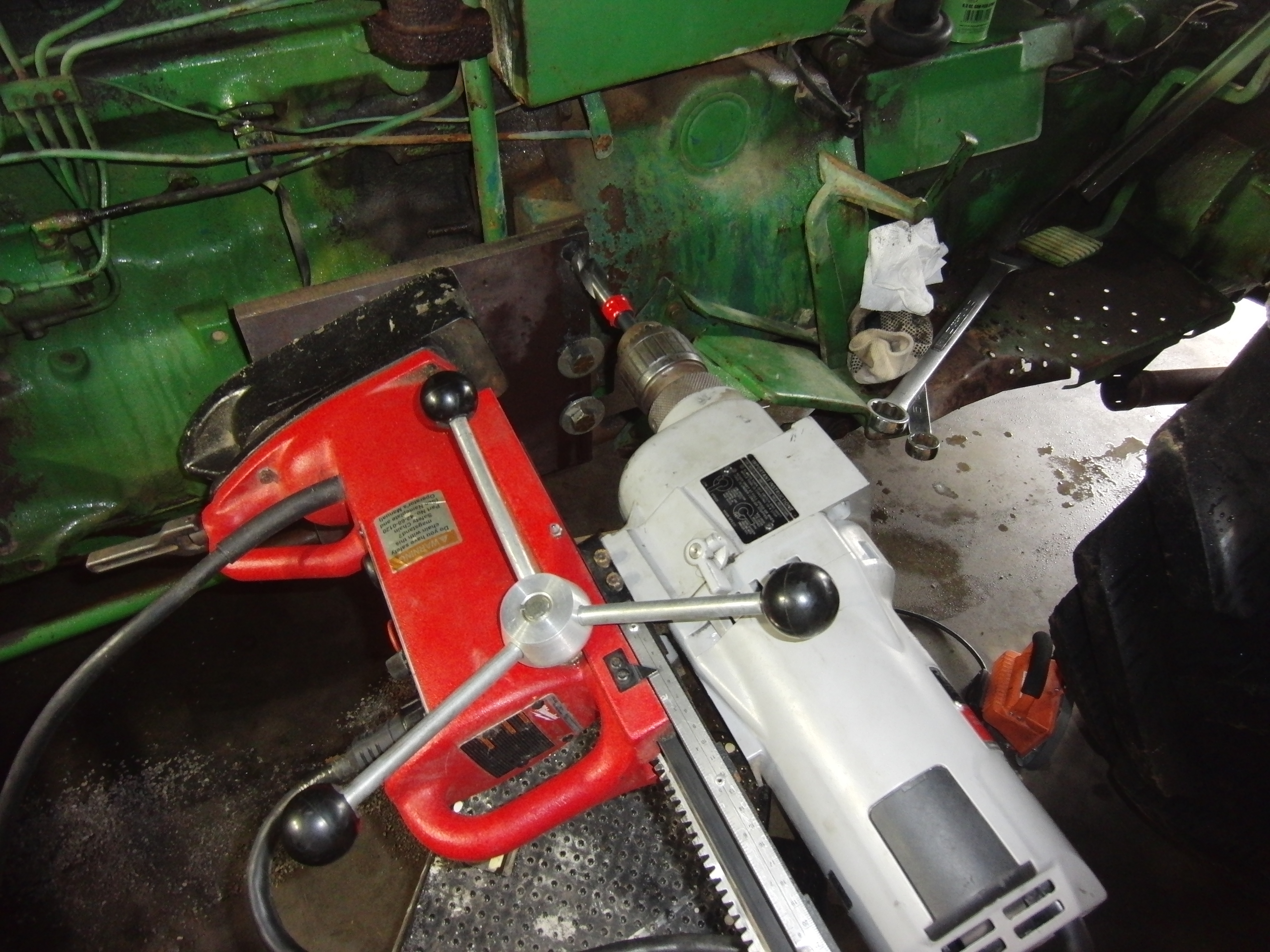

Other stuff came up, so only recently got around to splitting this tractor. I had to enlarge the holes holding the loader brackets on (one to 1"-8), long story. That magnetic drill press is a wonderful tool! That's a 7/8" bit in it.

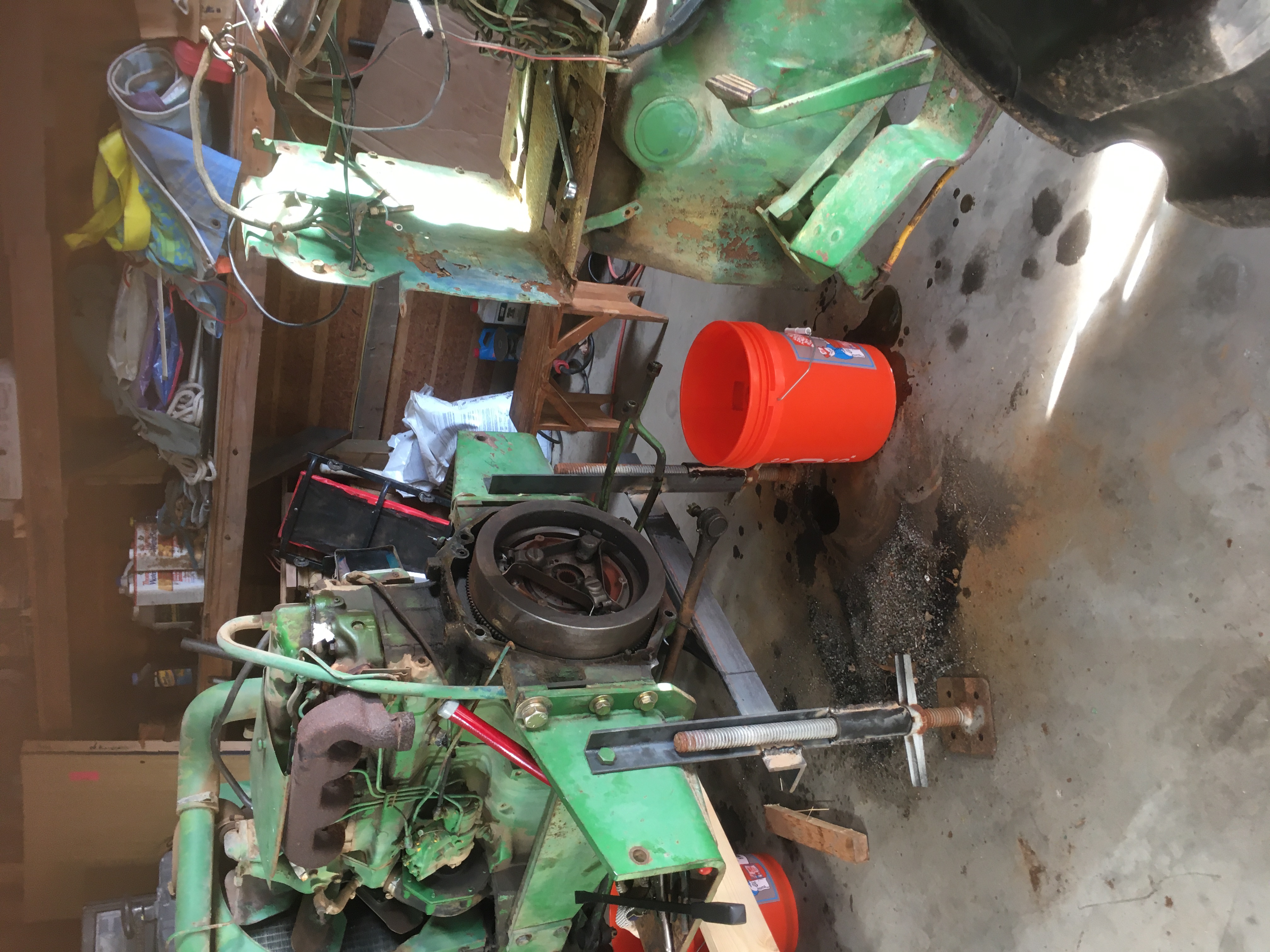

I stuck a splitting frame together that will bolt to two of the existing loader bolt holes to brackets, and uses scaffolding feet (already had plenty).
Clutch pack might come out this weekend. IMG_2200.JPGCIMG2397.JPGIMG_2199.JPG
   / 1979 John deere 301a not going into forward #39
Pulled both the main clutch, and the forward clutch pack out this afternoon. One seal in the clutch pack shredded, and no sign of the back one. Will try to get around to mic'ing plates this weekend.
Amazingly, no scoring anywhere. The old metal parts look brand new.

Good idea for the splitting stand. What size threads are the scaffold feet? They look pretty big.
