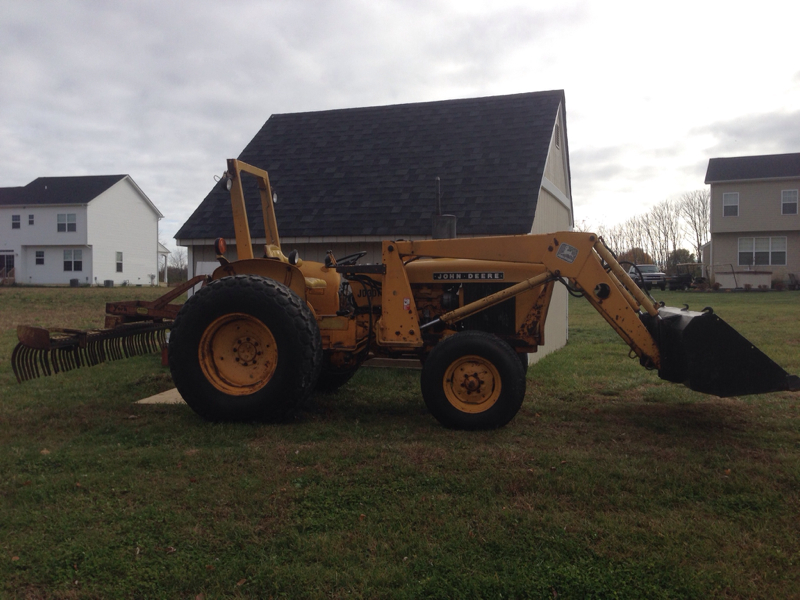

   / 1979 John deere 301a not going into forward
#28
Here she is with her 8' York rake and 3/4 yard bucket
   / 1979 John deere 301a not going into forward #29
Nice Tractor, Good job!
#30
Thanks, I'll give it some fresh paint in the spring, and will be installing the sunshade with-in the next couple days
