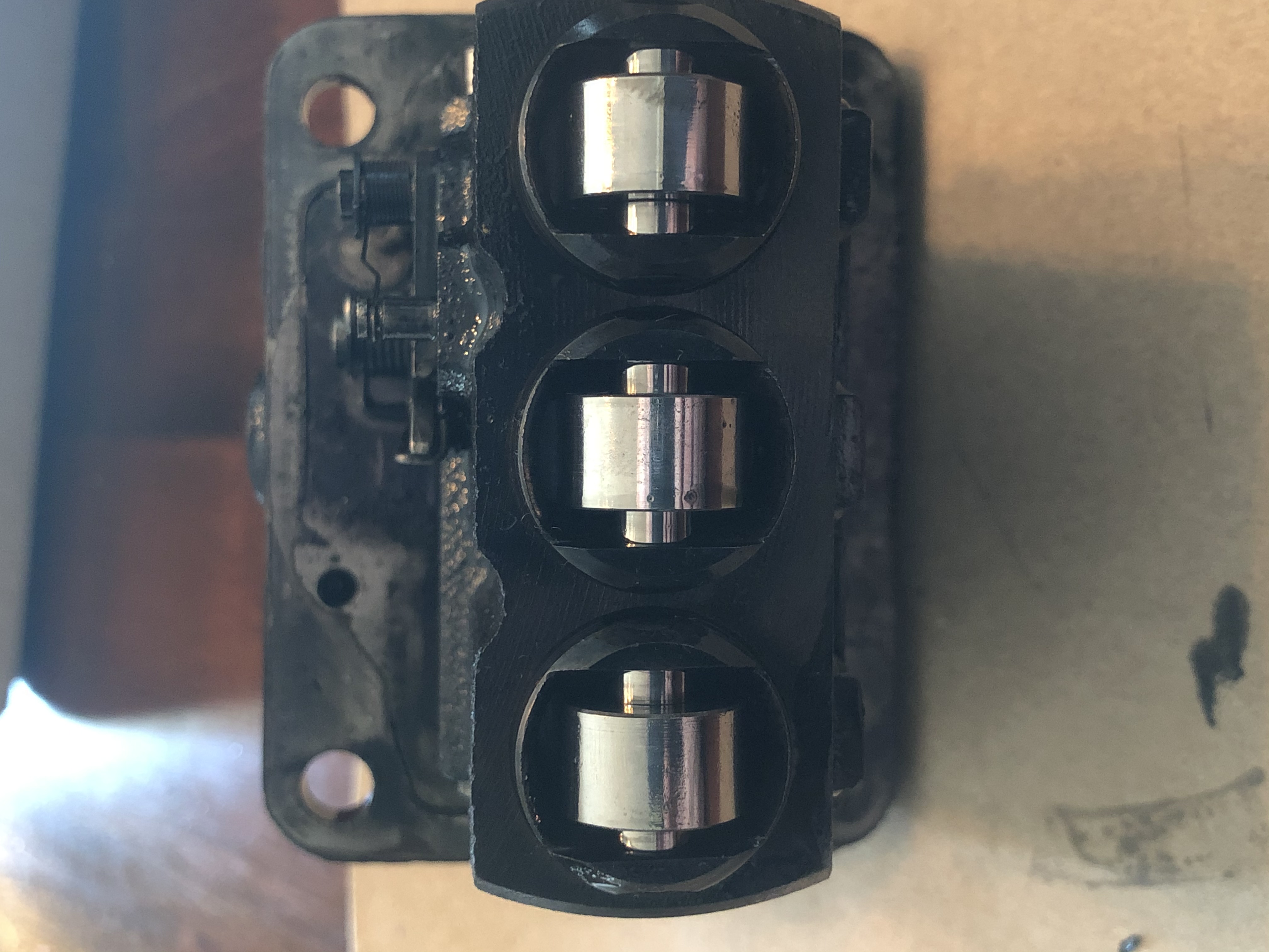

Pump is out. Noticed something that I am not sure should happen. The valve that is not working is on the left.
Mitsubishi K3E Fuel Pump - YouTube
   / 1980s International 254 Resurrection
#18
Pump is back in. The K3E runs and sounds great.
