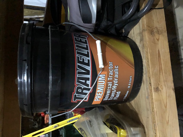

I know this is an old post, but I have the same tractor and need to change the hydraulic fluid. Did you use Hy-tran or standard Hydraulic fluid like from TSC?
   / 1980s International 254 Resurrection
#35
This is what I used. Haven't had any problems.
