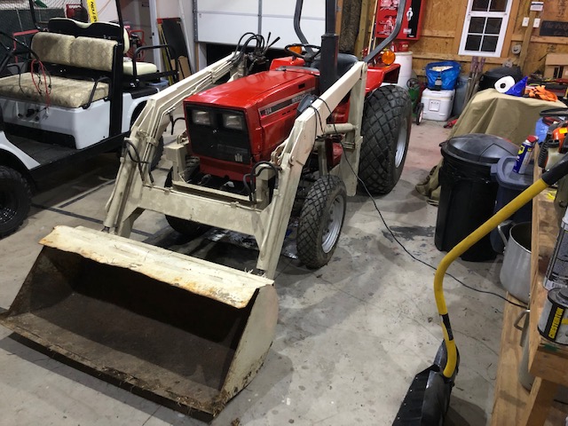

I enjoyed documenting this project, and thanks for looking. Here are a few final pics.

Thanks, and will do because it is a constant project.
Right now battling a low oil pressure light that comes on after its warmed up. To me that is an oil weight problem. Currently running Traveller SAE 5W-30 but going to switch to SAE-10W and see if that curbs the problem.
   / 1980s International 254 Resurrection #24
I would put a mechanical pressure gauge into hole where the switch is and get a good idea of what your actual pressures are as you use it. I usually use a grease gun hose so I can attach the gauge somewhere where I can keep an eye on it. Most oil pressure switches only come on around the 8-10 psi or lower. We were told in school that a good ball park figure to use was 10 psi/1000 rpm. I like to see a little more than that but now you have an idea what to look for.

That is a good idea. I will pull the switch and try and make something up. Will definitely post results. I appreciate all your insight.

The switch will be a metric thread so I will just have to find an a piece to adapt to a mechanical gauge assuming I can find one.
The engine sounds good. Of course there could be an internal bearing problem but I kind of doubt it. Would be interesting to see if there are pressure differences with different oils.

I picked up a pressure test kit. But going over things, my initial thought does not make sense. The only difference between 5W-30 and SAE-30 is its cold properties. When the oil reaches temp they are both 30. That is when this light is coming on so I would need a heavier weight oil at temp to increase pressure?

I run 15/40 diesel oil year round, plug it in in the winter, and I have no fluctuating oil pressure issues in the summer or anytime. I too put a mechanical gauge on because of electric sender problems. Simpler and peace of mind. Don't know what your book says but mine is a Chinese Perkins knockoff and no matter what I put in, its better than what they put in over there. Cenex 15/40 has treated us good in all our farm diesels.

I ran a gauge on it today. It ran great, held low 70s in high rpms and down to above 40 lower down in the range! Tapped in where switch goes. Worked it for an hour or so. So I guess that means the switch is bad. Or can I test that somehow too? Although if that tests good then it means there is a funkier problem and I do not need that.
