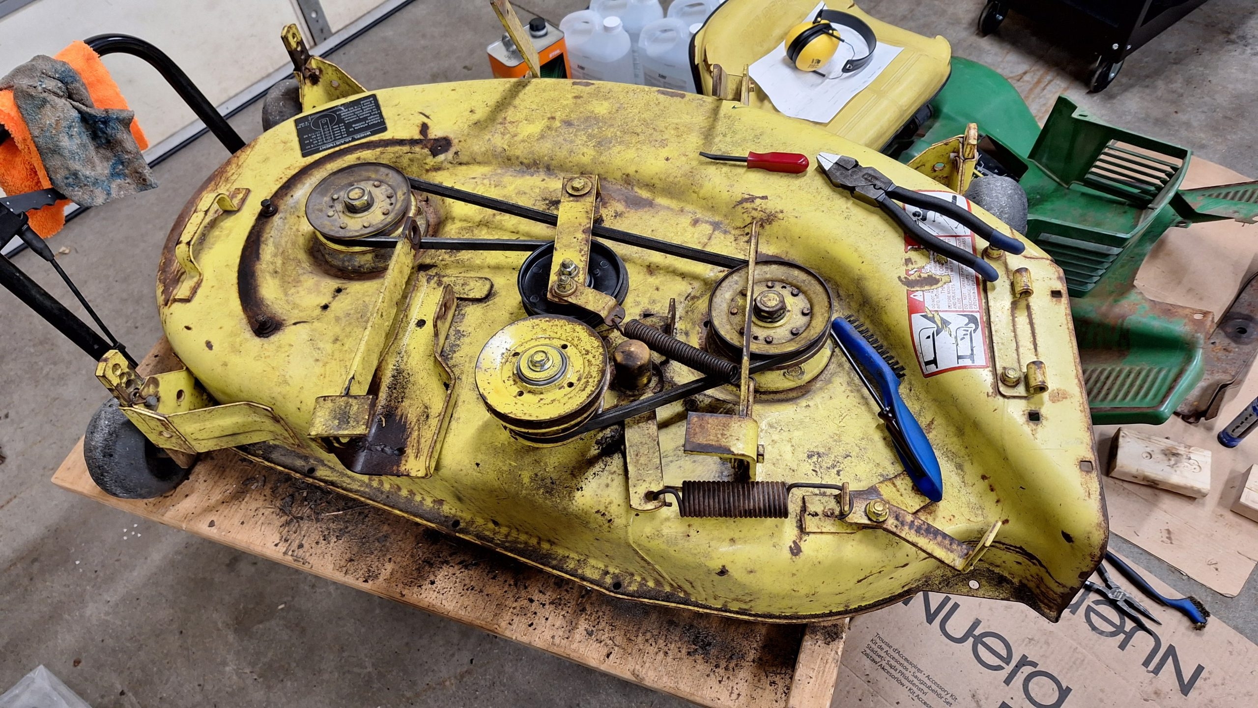

Hey all,
Literally bought the tractor yesterday for $150. It was running and mowing very well when I bought it. Fast forward 24 hours and it mowed for about 10 minutes before it threw the blade belt. Got it back on and mowed for another 10 minutes when it threw the belt again. Got it back on, went to engage the blades and the mower stalled. I checked the belt to see if it was too tight and it spins freely by hand. I checked the blades themselves and they spin freely by hand. Checked the blade engagement toggle in the dash and one of the connectors was not plugged in. So I unplugged it, cleaned it up, got all the connectors plugged in and lined up and the mower still stalls when I try to engage the blades.
Should I start with replacing the toggle switch or should I look elsewhere on the mower first? Or should I be looking somewhere else entirely?
remove the belt and grab hold of the blade and try rocking it side to side, could be bearings worn and keeping a pulley cocked to one side. that will throw a belt, keeps the belt alignment off
   / 1988 John Deere Hydro 175 - Engine stalls when I engage the blades #37
Is this what your mower deck looks like ?
If so, then I would start by looking at the support that holds the idler tenson pully and the pulley bearings. I'm guessing that they are worn and allowing the pully not to be aligned with the belt path.
Also make sure that the tension spring is doing it's job.
Richard
The top pulley is what powers the Mower Deck. Check all adjustments to be sure ist is correctly mounted. If that Pulley turns true and freely without wobble, Check the Belt
Size and clutch Pulley of the mower. Put the wiring back the way it was. Check Seat switch . Be sure to put a Deflector on the end of the deck.
