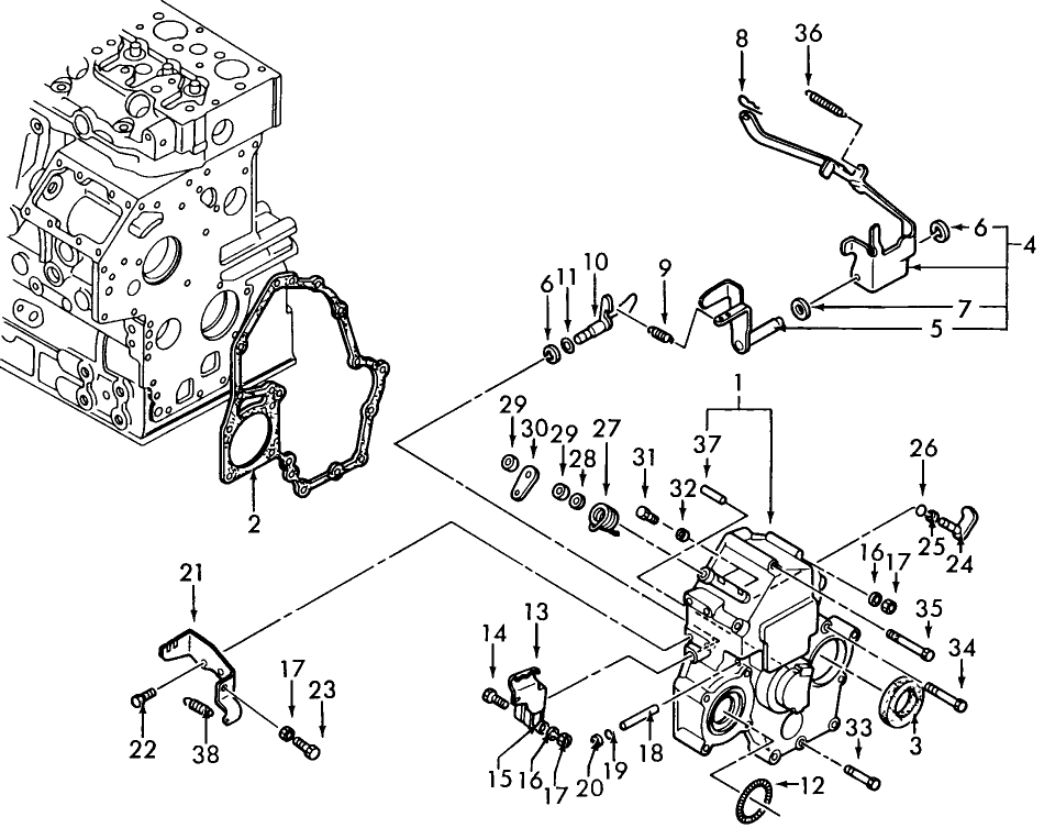

I wouldn’t be too discouraged. The repairs in front of you are not all that costly. It’s more frustration than anything else.
Governor:
When you pull the injection pump you will be able to determine the functionality of the governor. Keep in mind that all of the governor components have spring returns.
This may be a preexisting problem; you may end up pulling the timing cover.

purged the tank and changed out the fuel filter. Got it running. Have been running it now for about a hour and a half or so today performing some minor work around the house such as moving a dirt pile. Has only run away once in that hour and it only did it for a few seconds and died on its own. Cranked right back up and has been running "normal" for a while. I'm thinking something may be wrong with the governor. Sometime you can press on the foot accelerator it the engine rpm's will increase. Other times it may not respond at all. Also seems to have low power. When going to "scoop" with the front end loader the engine bogs down and will die if you keep getting into it. This is only 60/40 so its not like I'm moving clay or anything too solid. I know this fuel injection pump is run off the cam. Is there any timing involved with it and if so...how is it adjusted?
   / 1989 ford 1920 engine acceleration #20
Achallie, It´s probably obvious to you now; the reason you have no power is because you have no governor.
The governor lever #4 has a retaining pin #8. Do you recall installing this pin through the pump governor shaft?
You will not have to time your pump, they are factory set.
Mike
