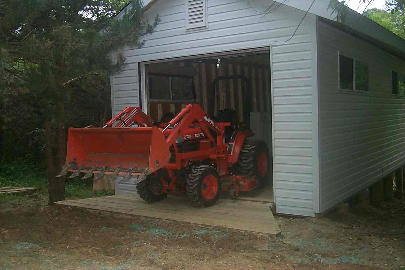

Sorry about that. Let me try again.
   / 1st time changing oil in B2400...Murphy's Law #12
Re: 1st time changing oil in B2400...Murphy\'s Law
I know what you mean about the manuals; they're terrible. It's kind of like interpretive reading. When I changed the hyrdo oil in my B7500, I think 90% of my time was spent trying to match the drawing in the manual to the actual tractor.
Even then I didn't get it right; someone here steered me in the right direction.
