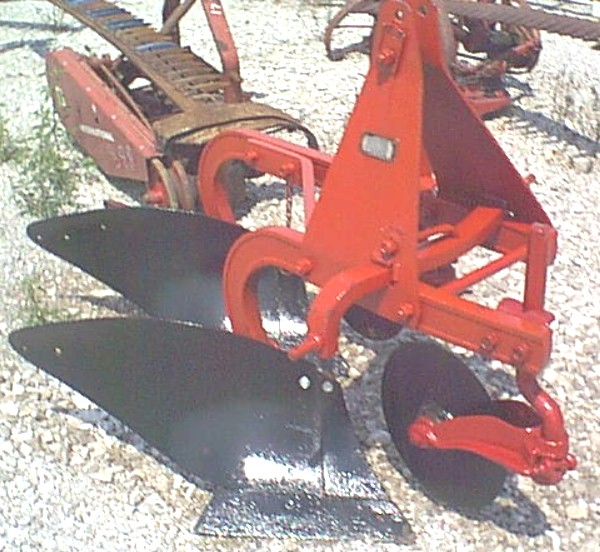

Here's the scenario...
Last week I picked up a 2 bottom IH Fast Hitch C-20 plow..pics attached. At first the game plan was to chop it up and modify it for 3pt use. BUT, my sentimental side kicked in and I am having a hard time bringing myself to chop up a vintage plow which is in such good shape....Well, that coupled with the fact I'm a new dad...I dont exactly have time to devote to this project :confused2:
SO...I put this plow up on craigslist with the idea of trying to sell it and just buying a 3pt plow...OR if worst comes to worse, I'll chop it up this plow at the last minute. Basically whichever comes first type deal...
All that being said...does anybody have an experience with the Frontier PB1002? I havent priced it out yet but it looks to be not too bad in price... The TSC 2 bottom price interested me, but last time I bought a TSC implement it lasted 2 hours :( anybody have experience with the TSC one?

As long as you stay with a regular clearance plow you should be ok.(No High Clearance) No matter what plow you use, The center of the drawbar to the edge of the right rear tire needs to be 23 inches for 12's--25 inches for 14's and 27 inches for 16's. If you don't hit these measurements, the first plow will cut more or less than it should. (new or used). I am working on getting some pictures of a Ford 2-bottom plow to you today or tomorrow with coulters and no rebuild needed. Ken Sweet

I don't want to get into a mudslinging war with anyone here but,take a look at the Frontier pb1002 and to me it looks just like the Leinbach,International(World Agritech Corp,)and or Worksaver plow painted pretty JD green.I doubt if Frontier makes that plow.I have the single m/b version 14"(Inter.W.A.C).Also I have noticed on the "Frontier" the front beam is cut short and looks almost like you could not mount a coulter wheel on that beam up front.http://www.deere.com/en_US/newsroom/media/images/2008/high_res/august08/10seriesplow_486312.jpg
I have seen the TSC 2 beam plows and would not buy one IMHO(please nothing personal to anyone here who owns one).You know if your going the Leinbach,Inter.(WAC),or Worksaver route Mr.Ken or Ted sell them.
O BTW these plows are shearbolt protected.:)

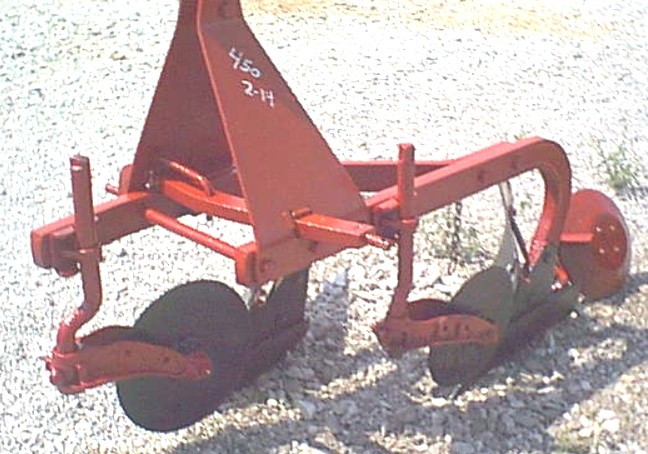

Here is a Ford 2-14 with the modern 3 piece setup that is easy to find parts for. It has good points and 2 new shins. Price is $450 + shipping. Ken Sweet
