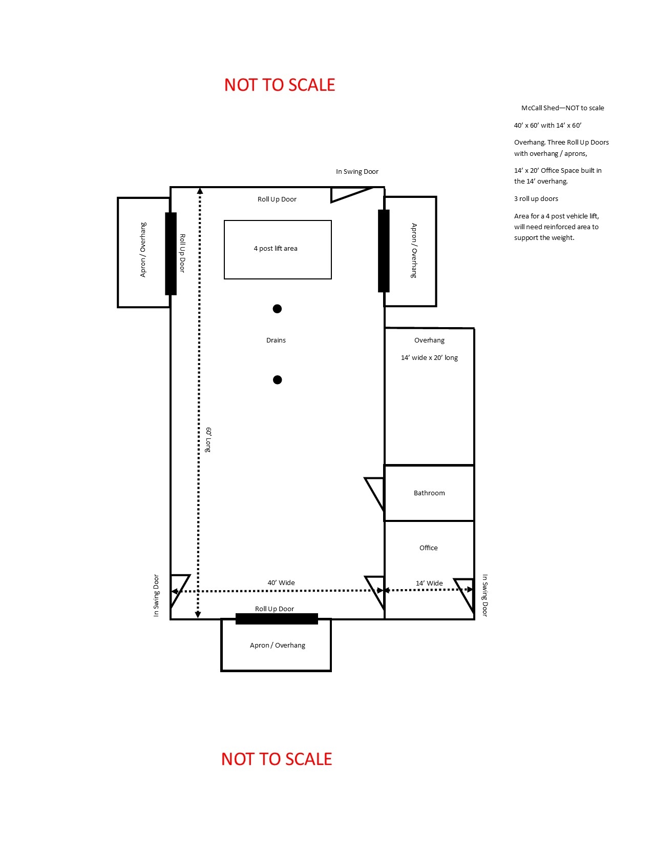

All are VERY good inputs. As for the drawing, I made it very quickly in powerpoint, and it is all subject to change. I'm meeting with my builder tonight, and all of these points will be discussed.
This is a one and done job for me, gotta get it right the first time.
I am torn on the lift aspect, some very good points for both styles. More than likely, I will go with the 4 post lift. I do want it down on the end, since it is not my primary purpose for this shop. Thank you all for the input... I'm definitely learning!

Updated the floor plan to this... based on some very good input from you all. This is a rough model, will be working out the details with the builder this evening. I'm leaning towards a 12,000 pound 4 post lift, still "up in the air" about that.
Thanks again for the input!

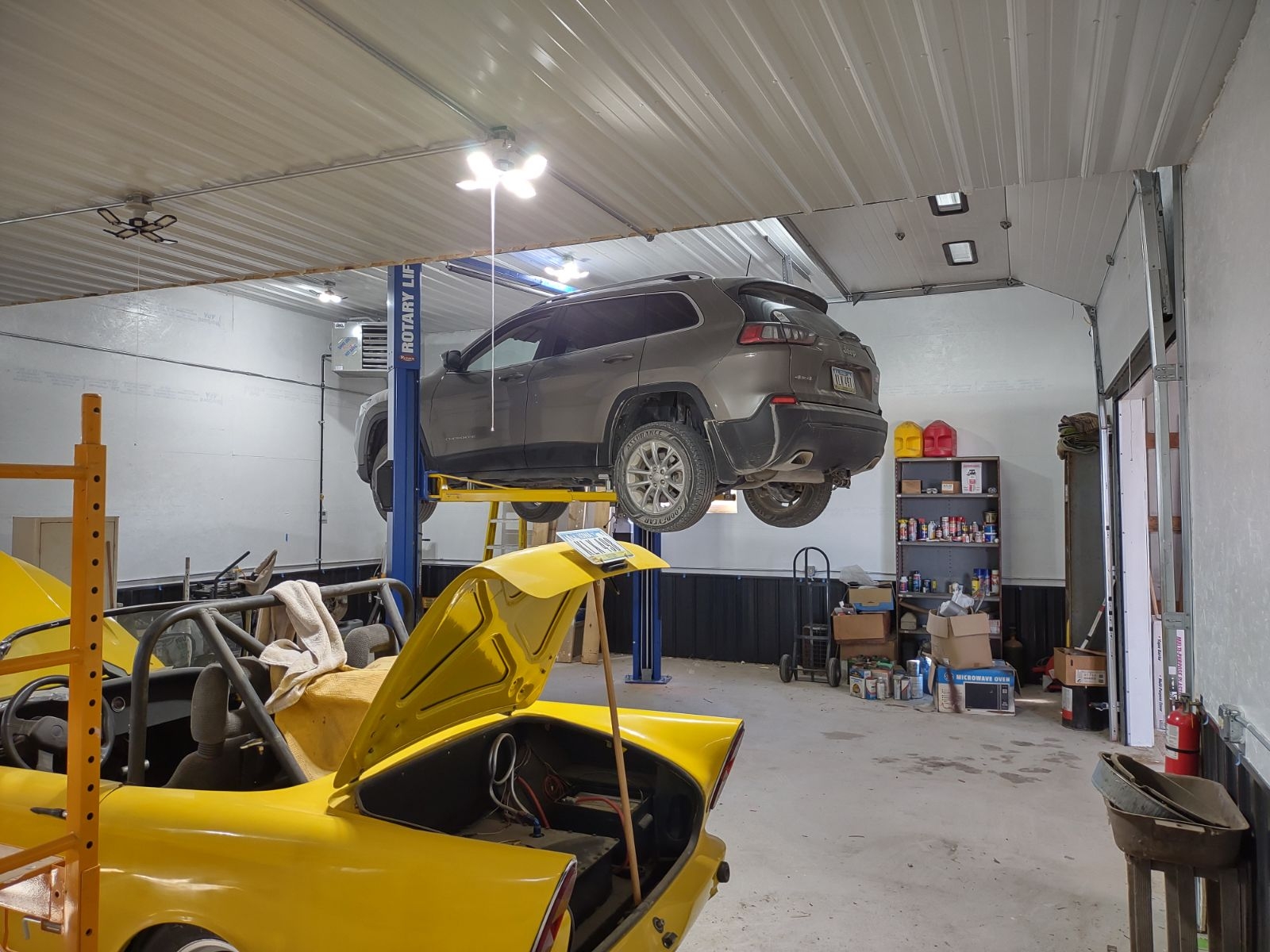

Two post Rotary 10k, overhead cables, assymetrical, made in Indiana, here. Just installed (took them 3 hours - would've been two days for me) in Oct '23. Working great, for me. Make sure you're overhead is clear and your concrete is thicker than the minimum.

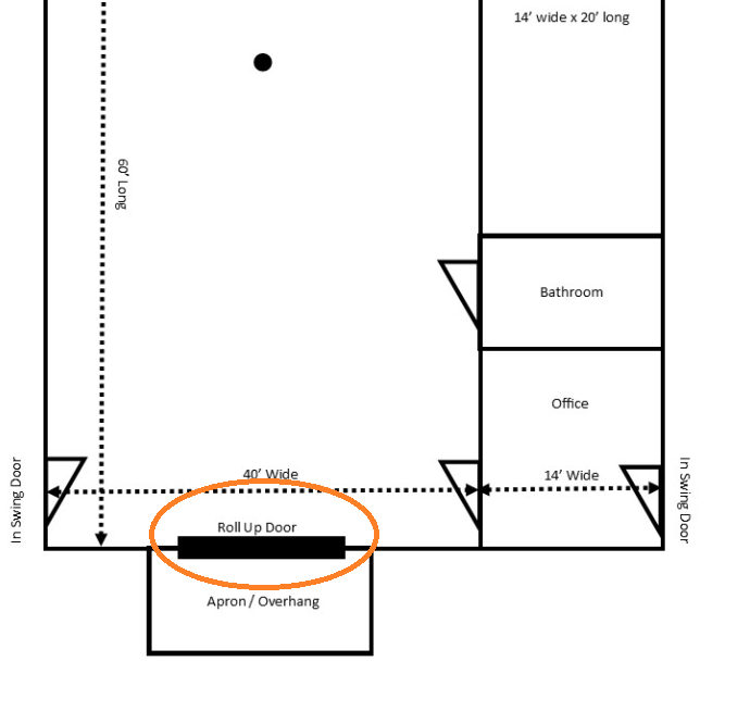

For the bathroom door I get both options, I guess it depend on for what and who will be using the shop, bathroom and office... If this is all personal used only I would think about it pretty good, you have a shower in there too so where will you keep you change of clothes? in the office ? ... one thing that is nice in a garage is a seal closet for dirty or off season clothes when going out mudding or hunting or what ever you do especially if you have a shower in there what about washer and dryer ? these are nice to have in a garage as well. Man doors take lots of wall room so that is the other consideration for choosing where the door should be.
