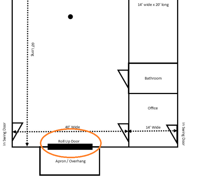

With that second design you can only get one vehicle in the building, and that will be on the lift. Which is more difficult to park on than just a bare space of floor, but you can park on it.
If you're only going to be working on one vehicle at a time then that's ok. But I think most people end up parking running vehicles or long term projects in their shops. And for that I'd want more than one vehicle door.
With a 40' wide gable end you can fit three vehicles side by side including a 12' wide lift in one bay and still have room to work on them. Or you can put doors in the long side. I'd put in three bay doors either way. Even if you only plan to use one bay for the lift and one second non lift bay for now. But put them all on one side, if the space around the building works for that. Then you can pave or gravel a space on that side for pulling in and out and the inevitable outside parking.
BTW the forums on garagejournal have a lot of shop build threads if you want ideas.

he has a door on the other end
