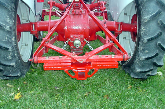

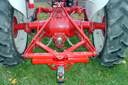

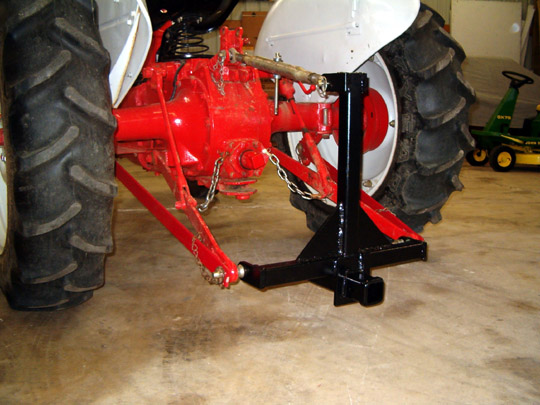

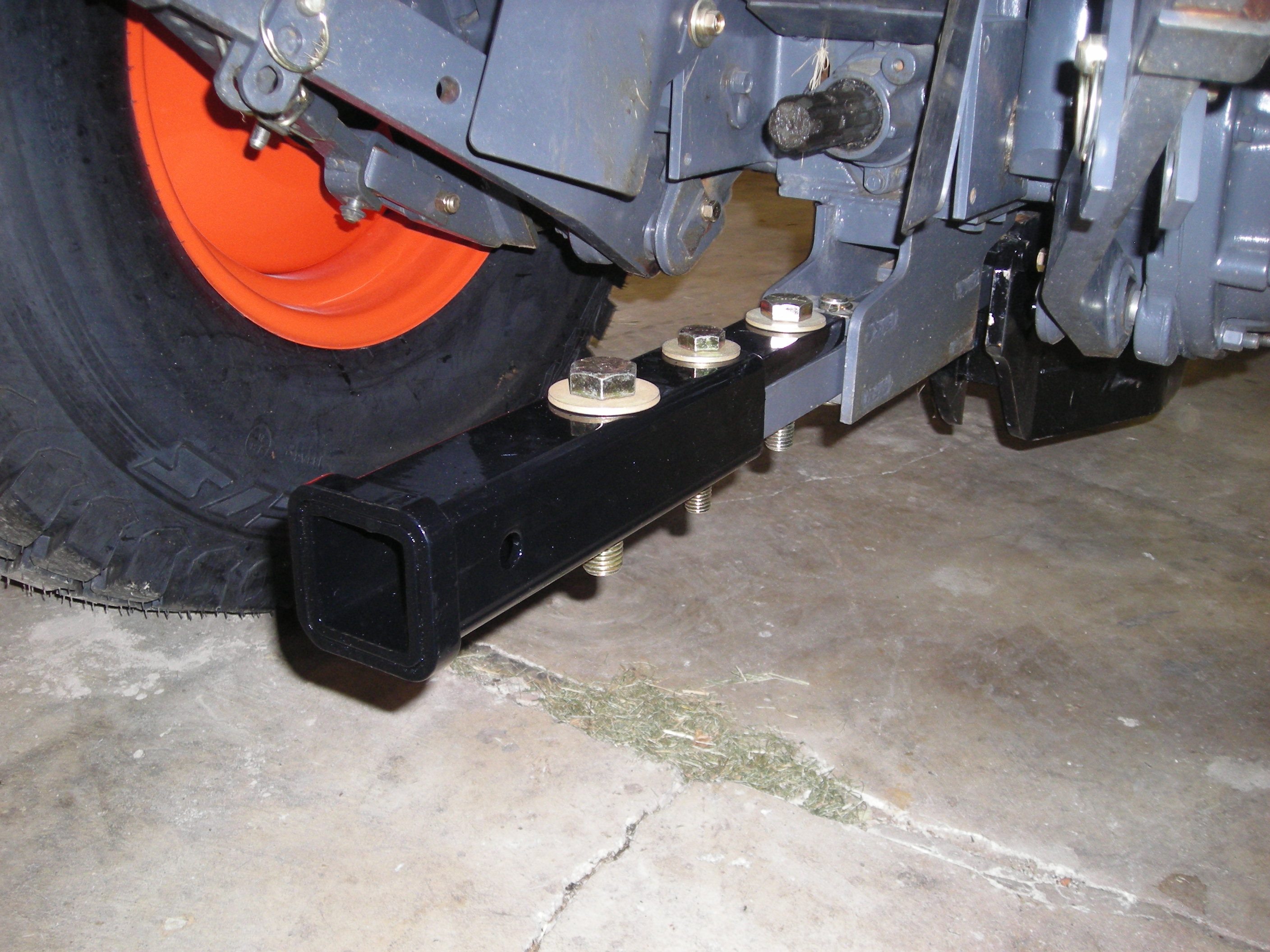

Here's a couple. With your skill set, I would just buy the 3 point version. I made the one for the Kubota drawbar with parts purchased from Tractor supply and McMaster Carr. The one for the 11 hole drawbar on the 8N was also make from parts from TSC and MMC. Takes a little thinking and drilling, but it is not that difficult. Philip.
