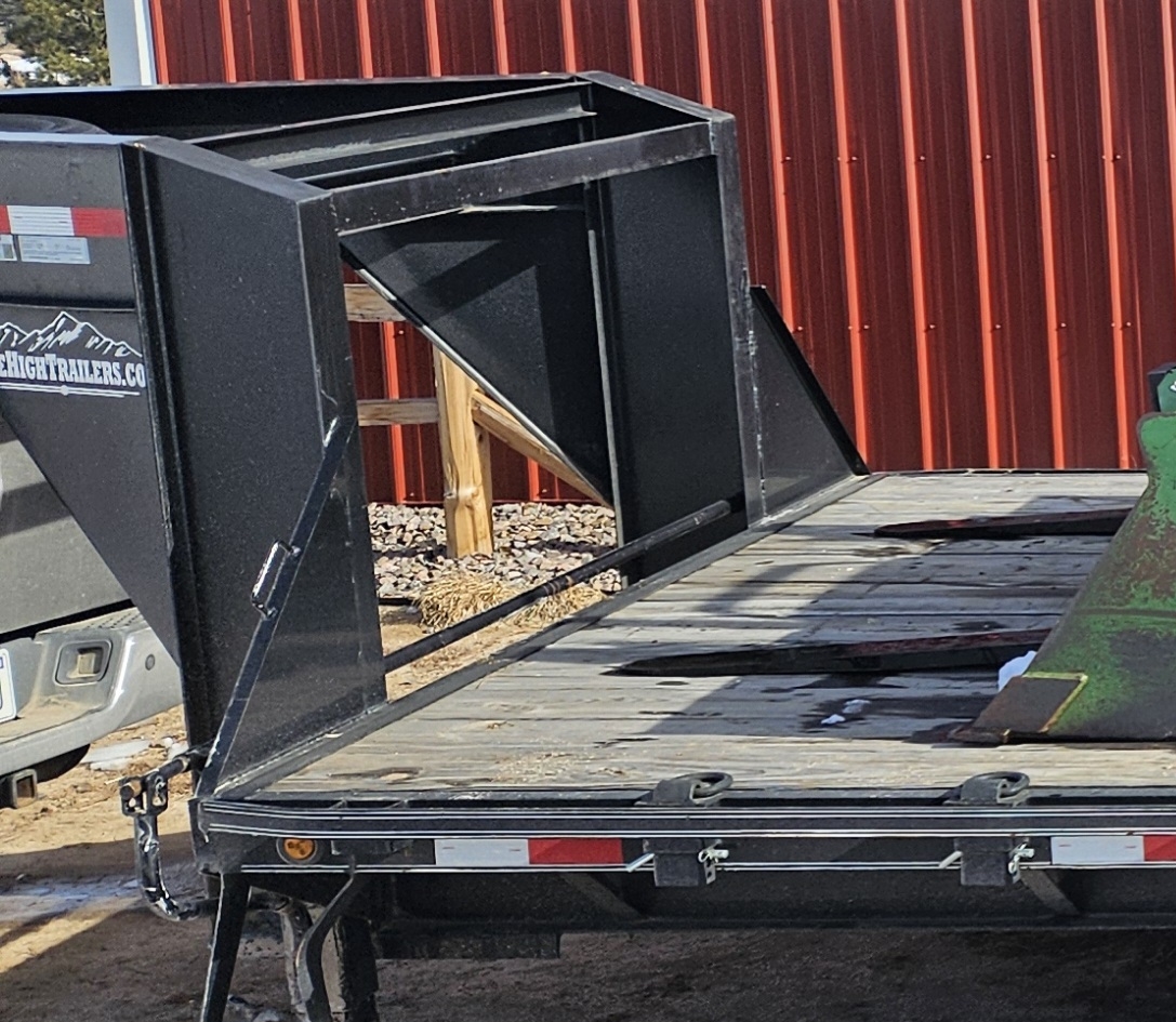

I have a 12V winch on one of those cradles that slides into a 2" receiver hitch. I'd like to add a mount to the trailer so I can pull a vehicle onto the trailer. It's a flatbed with a dovetail. I can weld (have a MIG welder), but would like to find something that "hooks over" the front of the deck frame so it is less dependent on my welding skills. Any suggestions for a product?

Just get a piece of 2" receiver tube and make your own. Sounds like you are more than capable.

Here's mine. Having the mount up high allows you to get a better angle when pulling the vehicle onto the trailer. The same design could be used at any height on the verticals. Not 100% sure what you mean by "hooks over" the deck frame. If you're not confident in your welding skills, it would probably be best to either hire someone who is or wait till you get some more practice in.

If your welding skills cause you pause, just tack up what you desire, and then bring it to a welder to finish the work. A couple of tacks, even poor ones, will not be any problem regarding the finished weldment integrity.
/ Adding Winch to Gooseneck Flatbed #7
Other than the 2" receiver stub like yours, mine is made from used oilfield pipe. 2-3/8" pipe spanning gooseneck uprights,resting in 2-7/8" cradles on each end. Receiver welded to a piece of 2-7/8" which is slid over 2-3/8 above. The only weld that must be top quality is receiver to 2-7/8" pipe which can easily be done by a qualified welder in their shop.

Always looking for new ideas Mr. Jaxs, is there any possibility of posting a photo if you get a chance?
