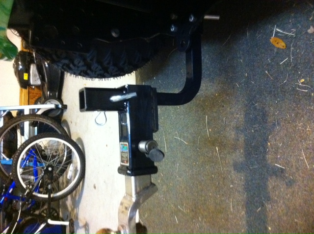

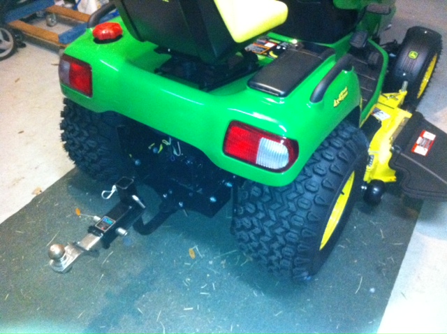

Ok...as promised pictures of the hitch setup. The new machine is awesome...I can't wait to do some work with it.

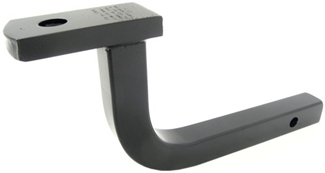

Too late now, I guess. But, I found a bolt on 2" receiver adapter that fit right on the back of my 425. No welding required. I simply had to drill a second hole. I got it at harbor freight. It is down low. But, that's easily fixed with an offset ball adapter.

I would be careful using that hitch as it puts the ball rearward a long ways from the rear axle. Really think you would be better off with the hitch ball much closer in to the machine.
If you are using this to move and park trailers, moving just a short distance the front weight bracket has a 1 1/4" receiver built in. This will handle more weight than you can deal with on the rear ball as you have it configured now.
Go slow while backing a trailer for the first time as the 4ws will over steer a trailer very quickly. The 4ws also has the effect of not making much difference which end is hooked to a trailer, reacts the same either end.

Thanks Steve - I've logged many hours on my old 425 AWS I just traded in so am definitely used to the dynamics when backing or pulling a trailer with it. I do agree with you on the hitch set up...I'll probably use the front receiver mount to move the big trailer. The hitch on the 425 had a pretty long moment arm too and it didn't really have any trouble with the big trailer but I generally had the JBSr. mounted to the front when doing so. The new machine is a beast compared to the 425!

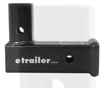

What about something like this for lighter loads? $9.99 at HF.
/ 2" Receiver Solution for X749 #26
That's similar to what I used. Only mine is about twice as long and attaches with two huge bolts.

This is a different item. I was wondering about the reference above to a hitch like mine but with two bolts to secure it (mine only has one). The hitch in my picture above is item #65961. The two items here are 12" and 18" extensions of the 2" tube that slides into the hitch I have - not the hitch itself.
Not sure what you want. But that is what I used. It receives just like the item you reference, and I don't believe it would go into your part unless your part is larger than standard catIII. I added holes that match the hole pattern on my tractor and bolted it on. It accepts standard cat III towing accesories. I use a carry-all, a sleeve hitch, and a ball hitch (all standard unmodified) with it. Slide in, insert pin; just as it should. Sits low, but works perfectly for me. There is a "double" one availabe that I guess would raise the height. but, then so would an offset insert.
