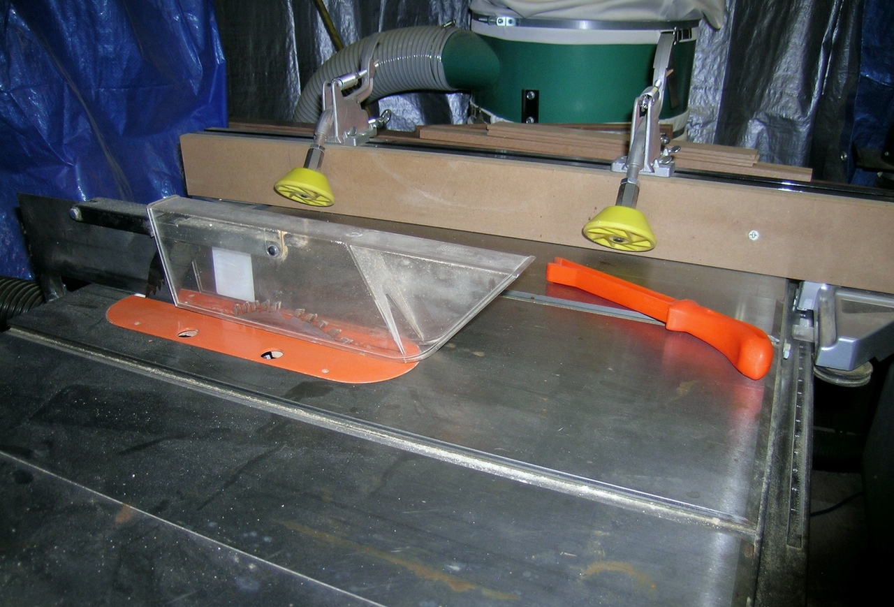

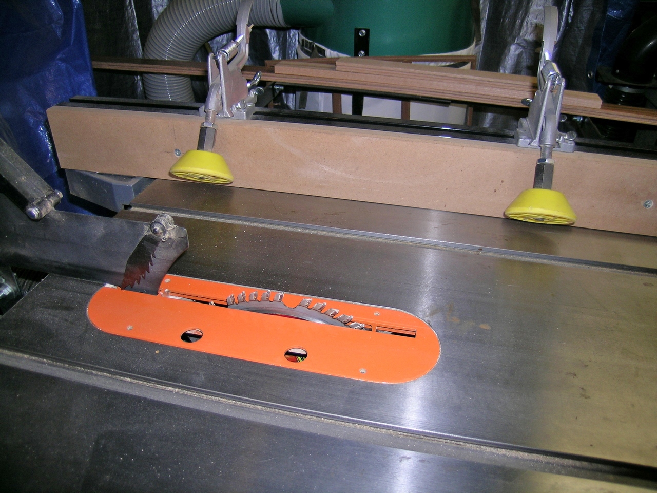

I am a hobbiest, and I've become accustomed to having all my fingers, so I do keep the safeties in place whenever possible. I realize that there are times, like making a dado, when this is not possible. I have a buddy who lost 3 1/2 fingers in a dadoing accident, so that is always in the back of my mind when using a table saw. You cannot sew anything back on cut on a dado, it's just gone. Here are a couple of pics showing some of my equipment that is available to reduce kickbacks. The yellow wheels only turns in one direction and the rear one holds the board down after it passes the center of the blade. They can be removed in a couple of seconds if need be.

As soon as my right arm heels from tendon surgery I'm going to install my "splitter" on my saw--just like in your photos. Having to do everything left-handed-only for three weeks--with FIVE more to go--has been a sobering experience on the importance of keeping limbs and digits intact. Try brushing your teeth left-handed. I can't even dress myself.

Where did you get those wheels. Looks like something I might be interested in.
