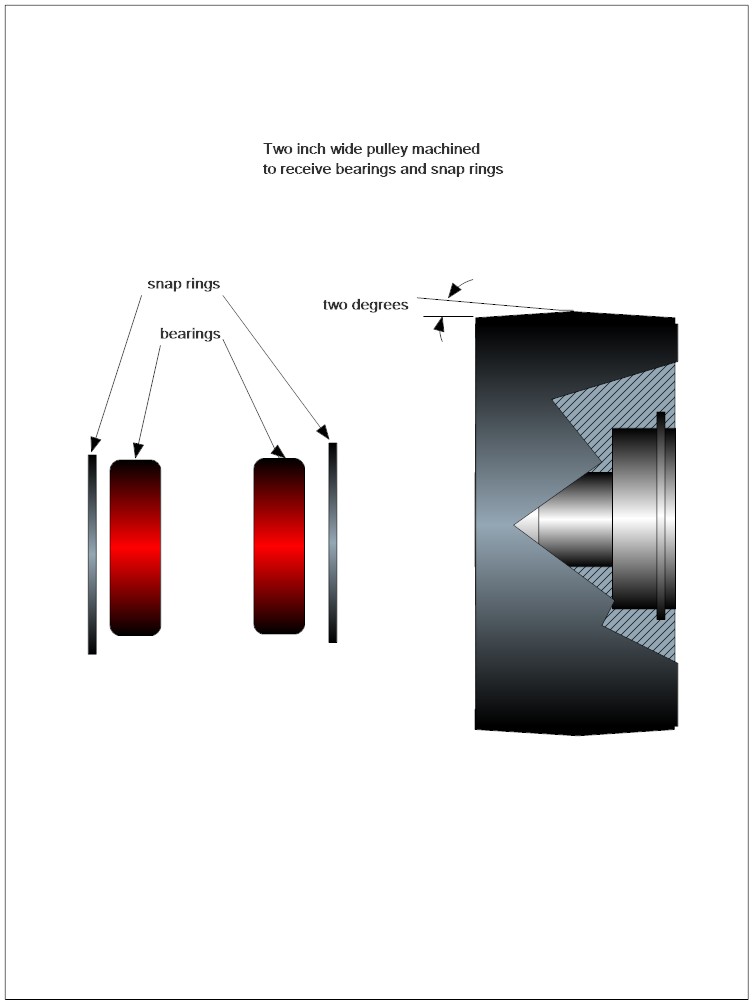

So, you had the two aluminum wheels just lying around? What were they in their previous life. I want to build a 2x72 for shop work and knifemaking. Wheels are expensive!
The large wheel came from a junk shop for $2.00 but it had a U shaped one inch thick rubber glued on that I had a **** of time trying to get off, finally used a band saw to cut it off, then made a shaft on the lathe and turned the rest off. For the smaller pulley I used a hole saw on a piece of two inch aluminum plate and finished on the lathe.

I started with the 1x30 HF grinder then got a 1x42 1/2 hp grinder. The 1x42 grinder is 10 times better than the 1x30 HF grinder. After watching Mr Pete 222 build a Kalamazoo style 2x48 belt grinder I built my 2x48 1 hp grinder. 10 times better than the 1x42 grinder. I had a 1 hp motor from a Craftsman table saw and most of the metal for the build. Purchased the wheels and a piece of DOM. I have a little over $100.00 in the build. With the 2x48 belt grinder it will help with a build of a 2x72 belt grinder using plans from Jeremy Schmidt (check out his build on UTUBE).

Just wondering if anybody has tried to smelt old aluminum metal to cast the big aluminum pullies. It is something I have thought about, but been afraid to try. I have a buddy that cast small aluminum parts. He uses old transmission cases or other busted parts and melts them in a homemade forge. He then uses some sort of green sand to make his molds.
   / 2"X48" belt grinder #15
Look on YouTube for a man called mrpete222. He recently made a video about fixing up a belt sander. And he has many videos of casting parts from aluminum, including wheels for a belt sander.
