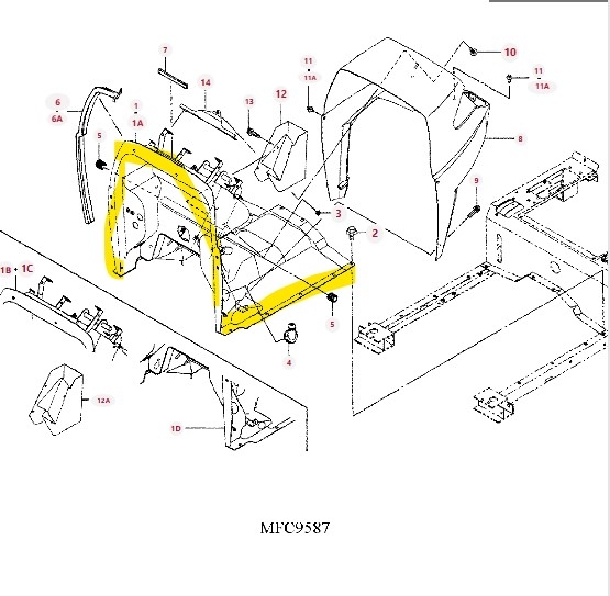

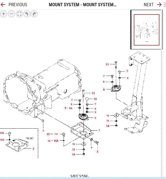

This is not a simple tractor when it comes to getting to the head. The fuel tank mounted over the engine, half under the instrument cowling, makes it more of a difficult job than the average. Also, the superstructure for the hood and tank takes time to disassemble and assemble. I found that removing the platform mount nuts and prying up on the front of the platform about 1 to 1.5" gave enough room to slide the fuel tank out from under the cowling. Also, remove the muffler before you try to disassemble the rest of the supports and tank.
Hopefully your service manual gives you some tips on this procedure, but I didn't really see anything that would expedite getting to the head. The head itself is straight forward once you get there.

What I'll do this weekend is study the manual carefully. I'm lucky about the fuel tank on this model year because the fuel tank is behind the seat but with the FEL on there it's a bit of a contortion to do anything on the engine. Maybe I can do things like thoroughly clean everything to reduce time on the mechanic.
