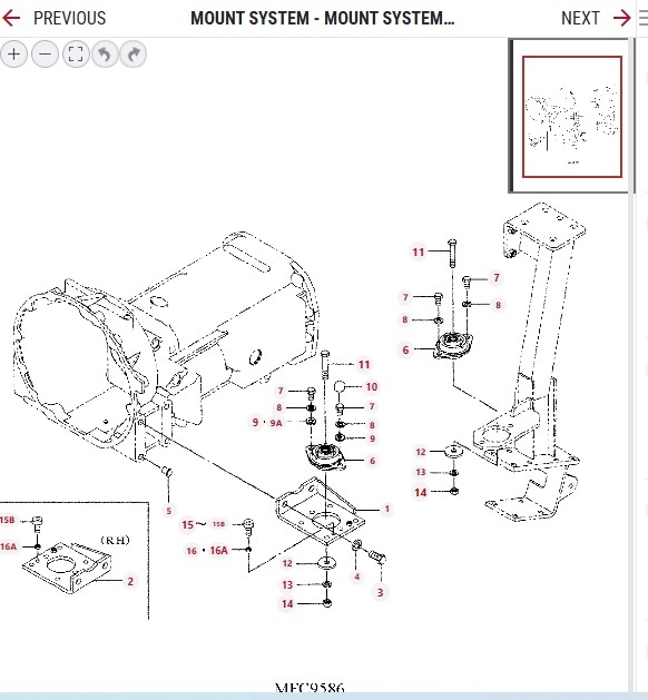

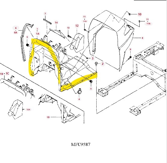

Welcome to TBN!
Remove the mounting nuts, #14, on the platform/floor in the front and back. This will give you flexibility to lift up the cowling around the fuel tank enough to get the tank out. I think I put 2x4 or 4x4 pieces on the front mount to keep the it propped up. There is enough flexibility with the wiring to do this.
