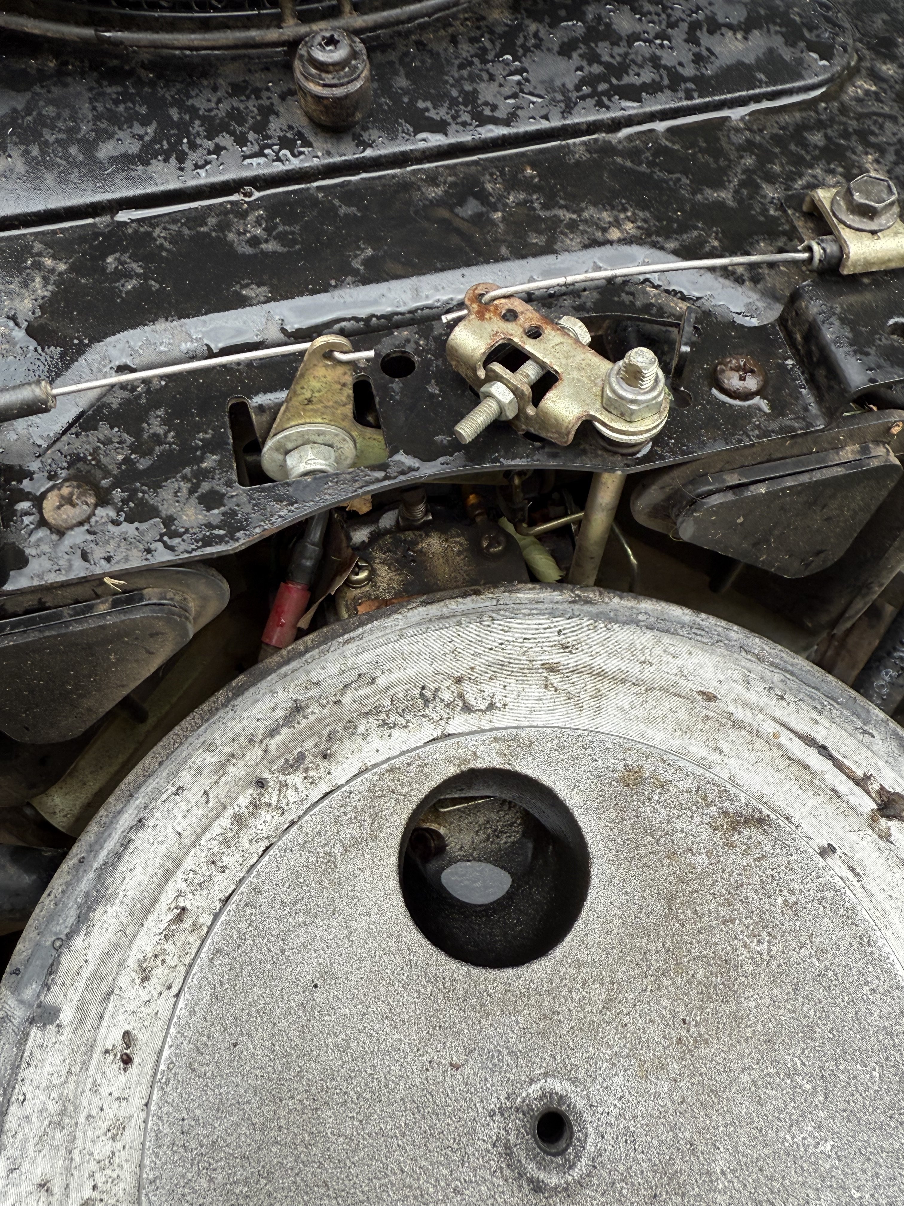

I have a 2000 Dixie Chopper with a Kohler 20HP engine model CV20V, spec #65605. Will start on first attempt after sitting for let's say a week. After starting if I shut it off and try to restart turns over but no go. I took off the air filter to look into the intake to the carb, it was full of gas. So I'm guessing that it is flooding. Stuck float, bad fuel pump????

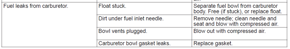

Biegs, Welcome to TBN
If you are seeing fuel puddle in the carb, then yes, your carb is flooding. Here is the suggestion from the Kohler service manual:
The service manual is available on the internet for free.
Richard
