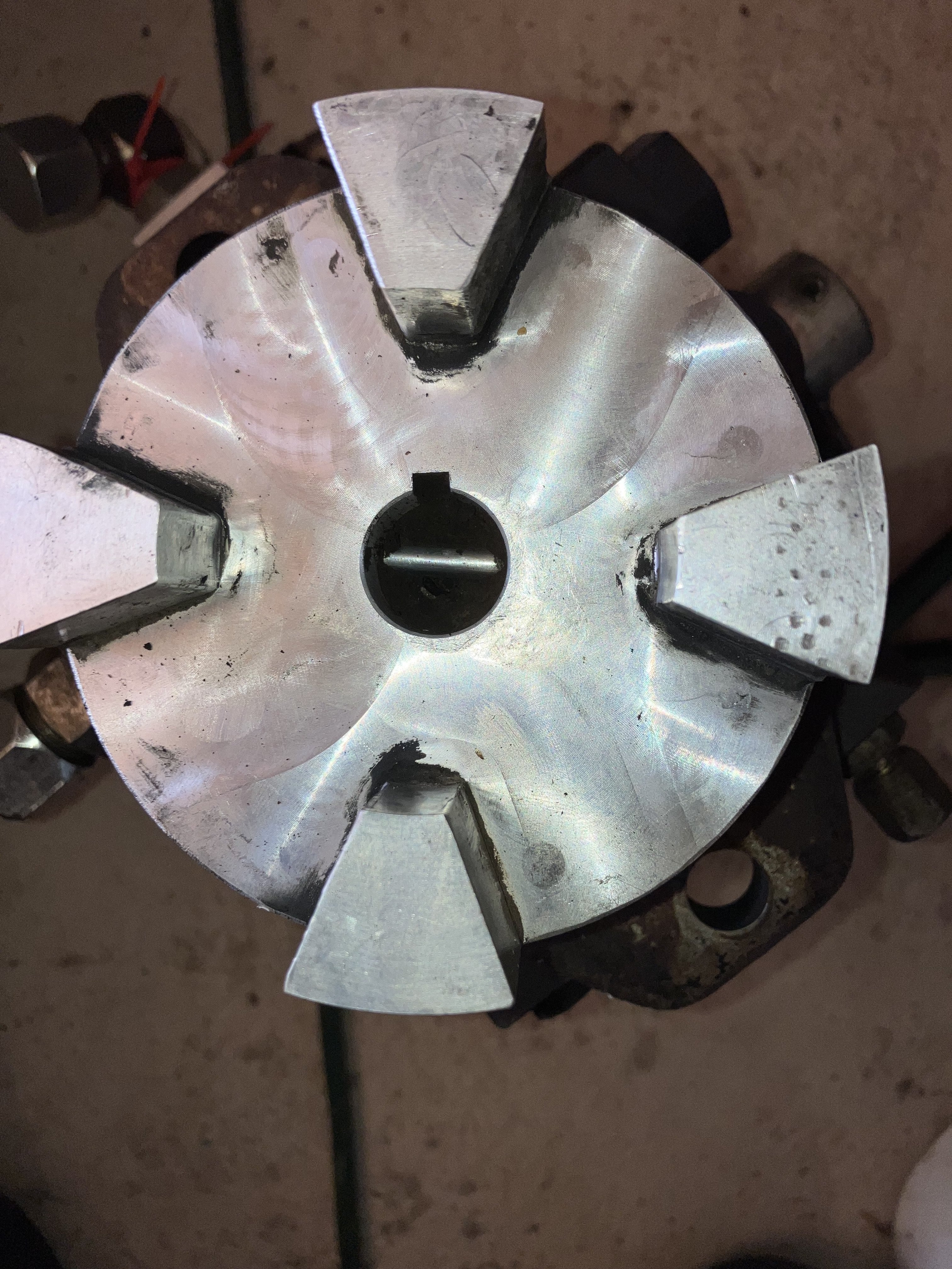

Where is this part located??
Between the tramp pump and the engine.
There are three parts to the lovejoy connector:
Two hubs and the spider.
On this particular one, the hubs each have 4 fingers and the spider has 8.
One hub is mounted to the engine shaft, the other is mounted to the pump shaft, and the spider goes between them. They are sandwiched together with the pump mount. Apparently it takes up shock and allows for minor misalignment of the shafts and dampens vibration.
There's another one on the PTO pumps on the shaft on the other end of my engine.
(click to enlarge)
Pump hub.
Engine hub with spider installed as viewed through the pump mount with the pump removed.
That silver thing between seen coming out of the engine through the pump mount, still attached to the pump shaft.

The hubs are keyed to the shaft and have set screws. So you could adjust depth onto the shaft for adjustment if you had to.
However, this is the hub mounted on the pump. PT has cross drilled it and installed a pin to prevent the hub from going too deep onto the shaft. That's pretty convenient for me, as it got the hub back to the correct depth on the shaft very easily. Otherwise, you'd have to mark the shaft for depth or measure, etc... to ensure it gets back into the correct place.
Knowing now what I did not know then, if I'd have removed the engine with the pumps attached, I'd not have had to take the hub off the pump side to get everything out. 🙃

Hmmm... I am used to the rubber spiders being the same size as the couplers. I doubt that it matters.
That is super nice of PT to cross drill and pin the coupler! That saves a bunch of fiddling around.
I wish that there was an access port to check on the state of the rubber spider. It is a wear item of an unknown lifespan, though the sound of a shattered/missing spider is usually quite noticeable.
