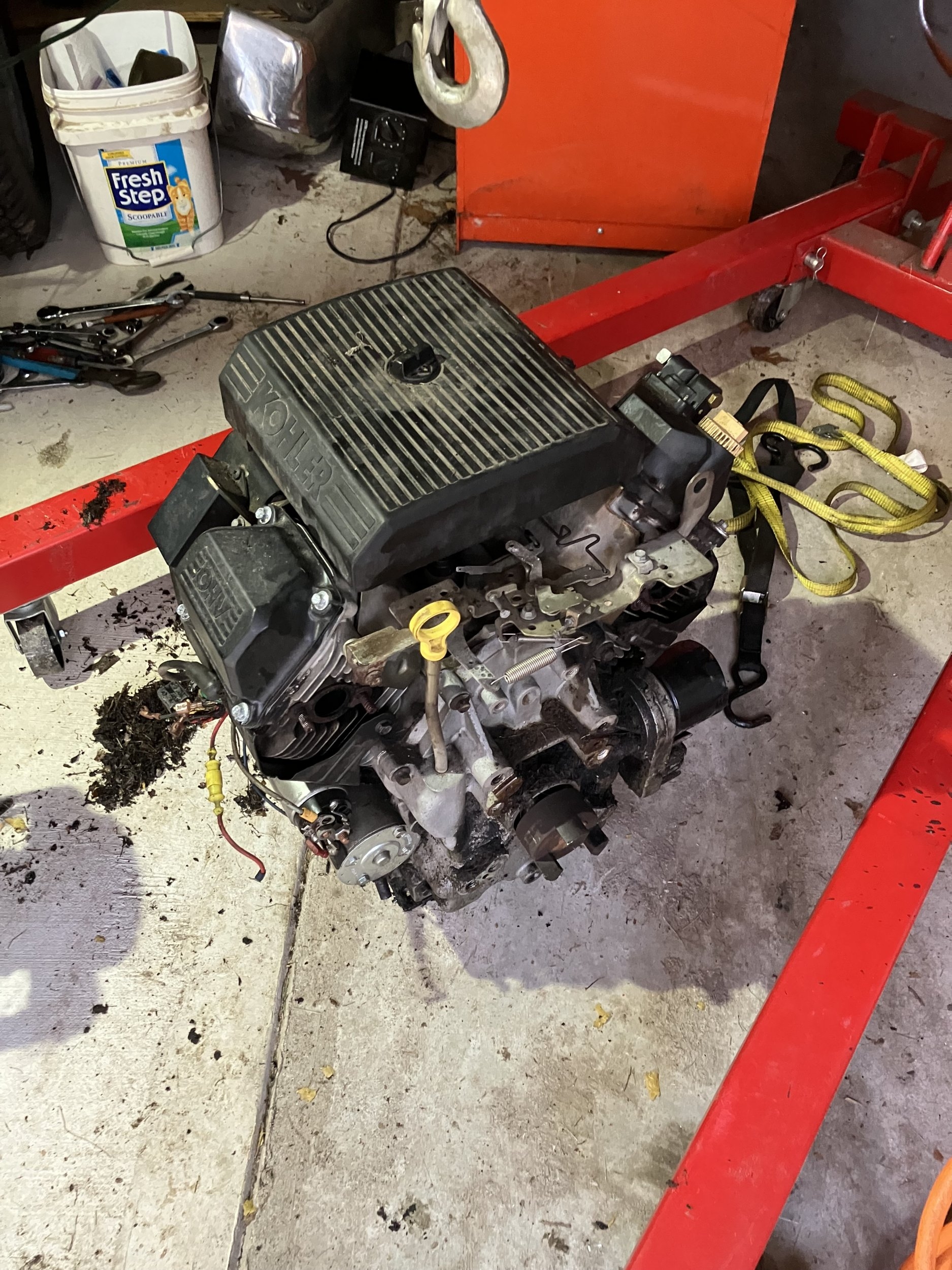

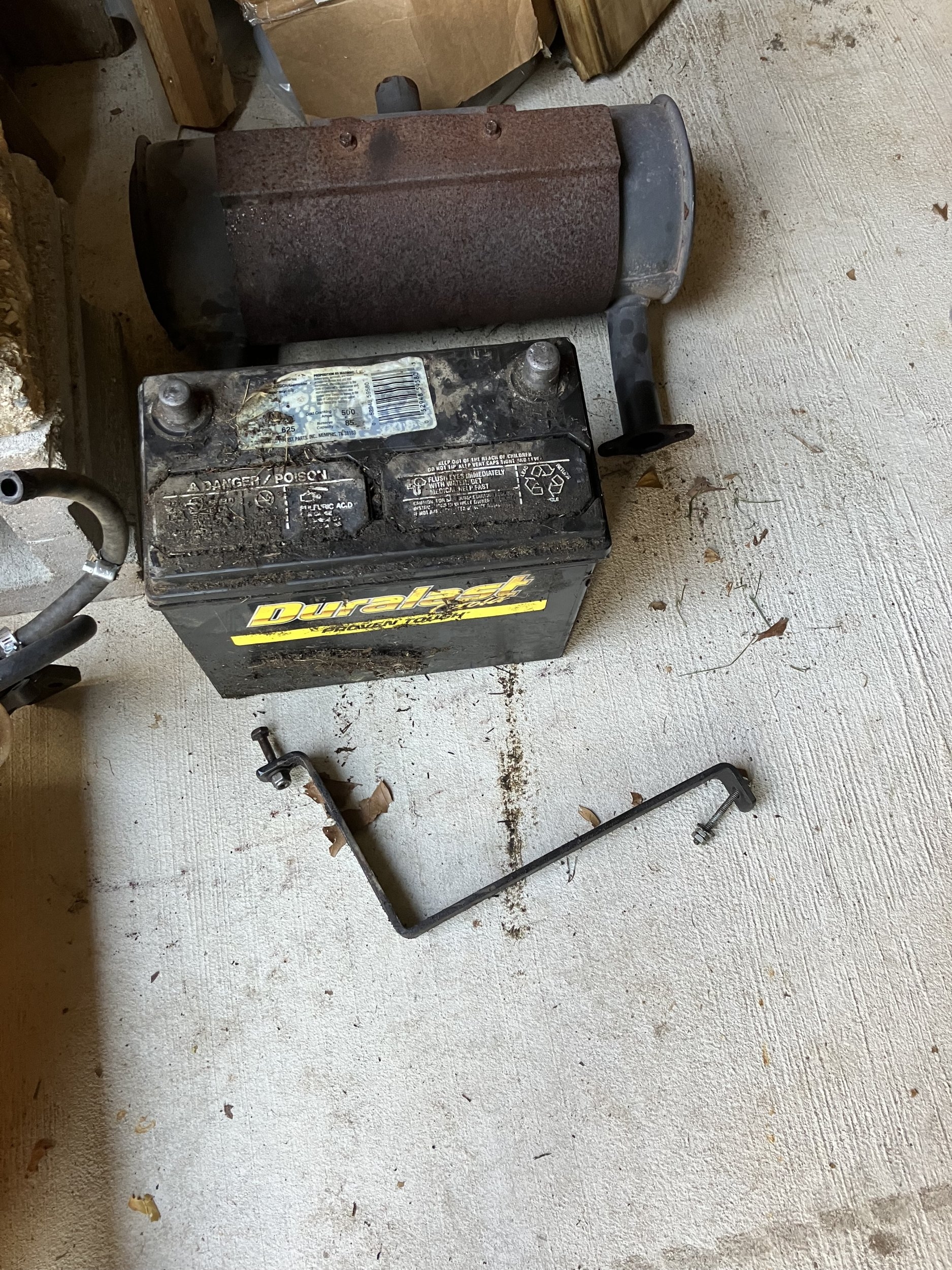

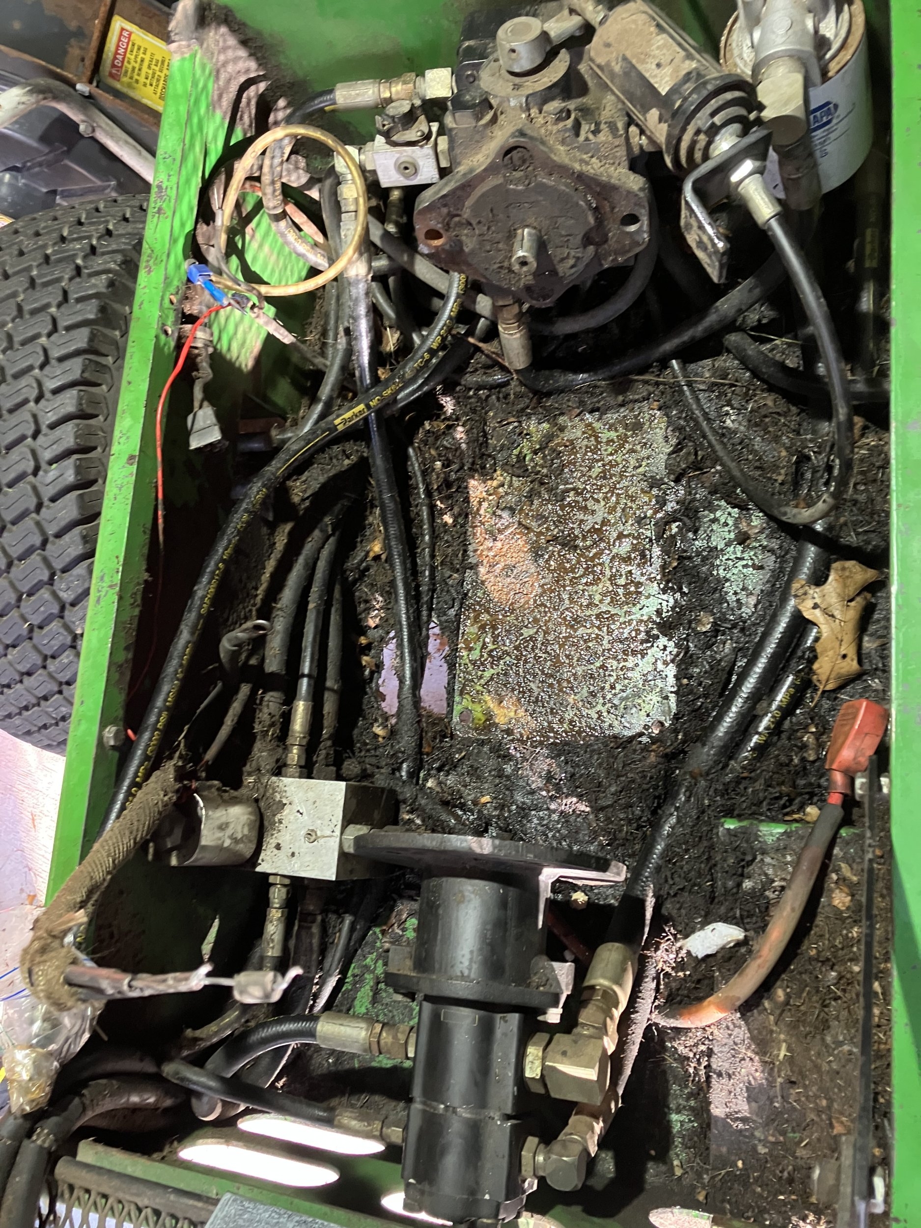

My 2001 PT425 developed an oil leak. About 1/2 a quart every 20 minutes. Can't seem to locate it, other than a pool of oil under the engine. So time to pull the engine, put it on a stand, clean it up, and run it to locate the leak.
Trying to avoid disconnecting hydraulic hoses.

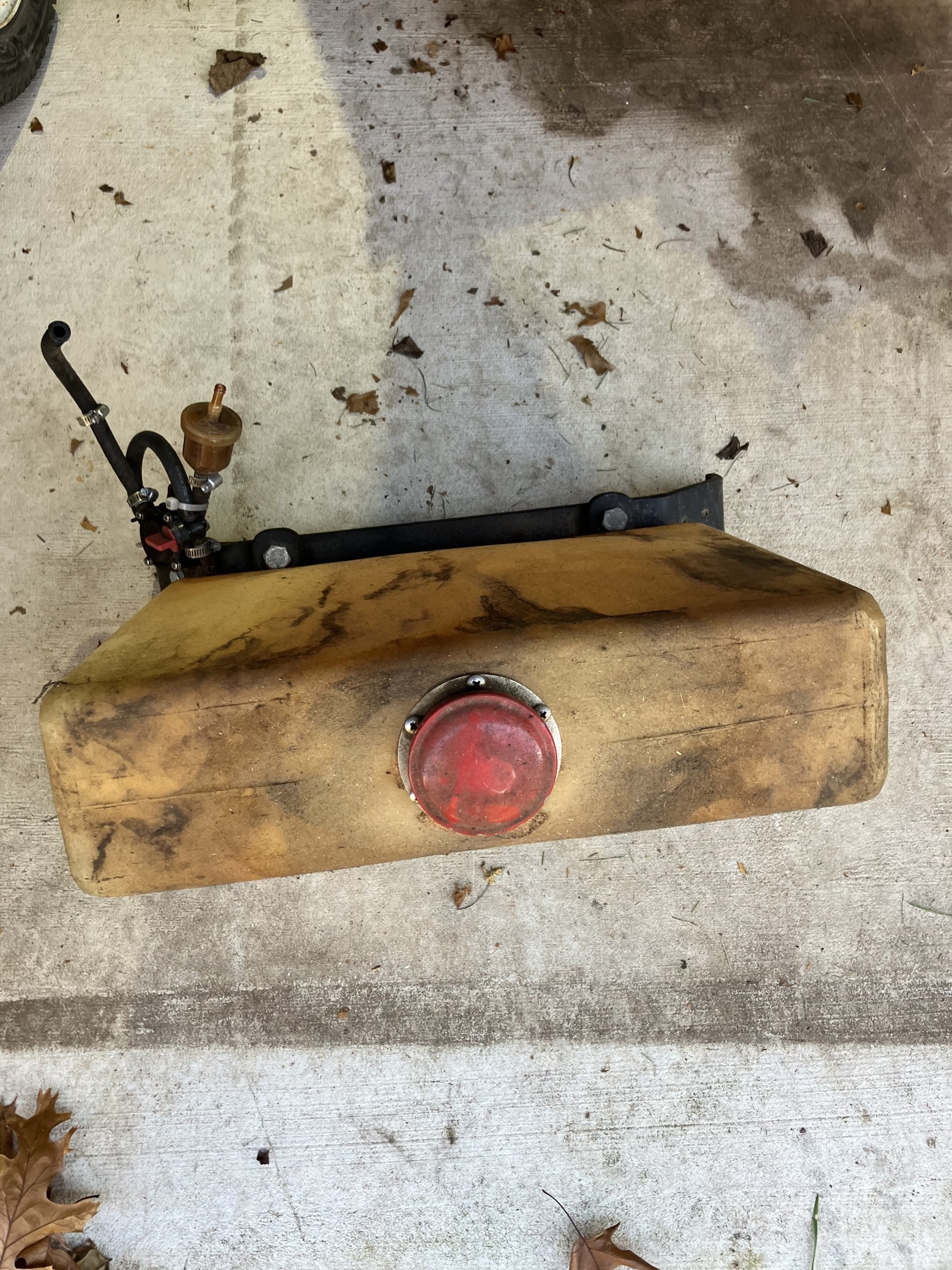

Pulled the gas tank and fuel pump all on the bracket. Just 4 bolts and a hose clamp.

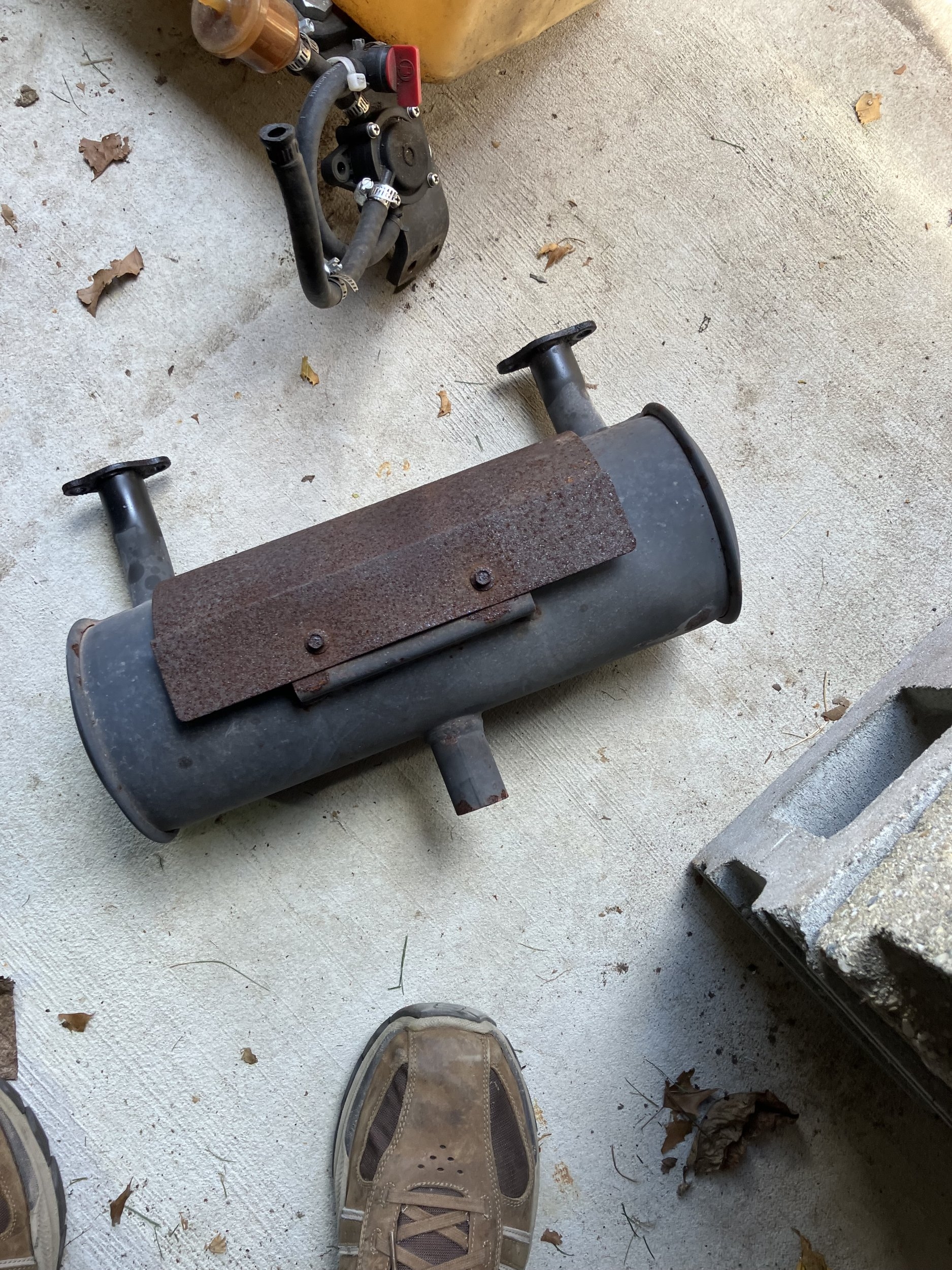

Pulled the muffler. 4 nuts. Didn't break the exhaust studs this time.
Pulled the battery.
Unmounted the hydroback assembly.

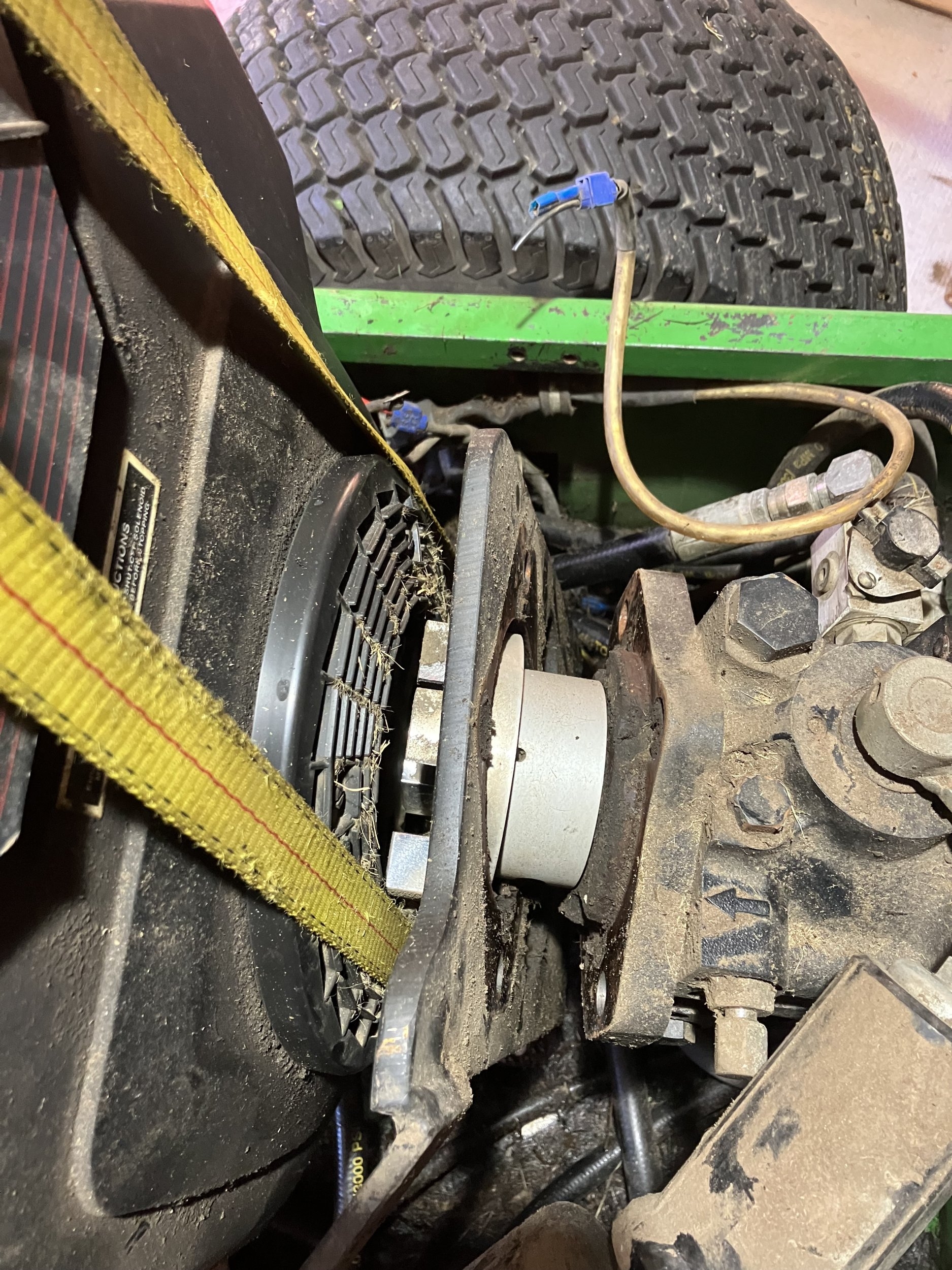

Disconnected the wiring harness and positive battery cable from the starter.

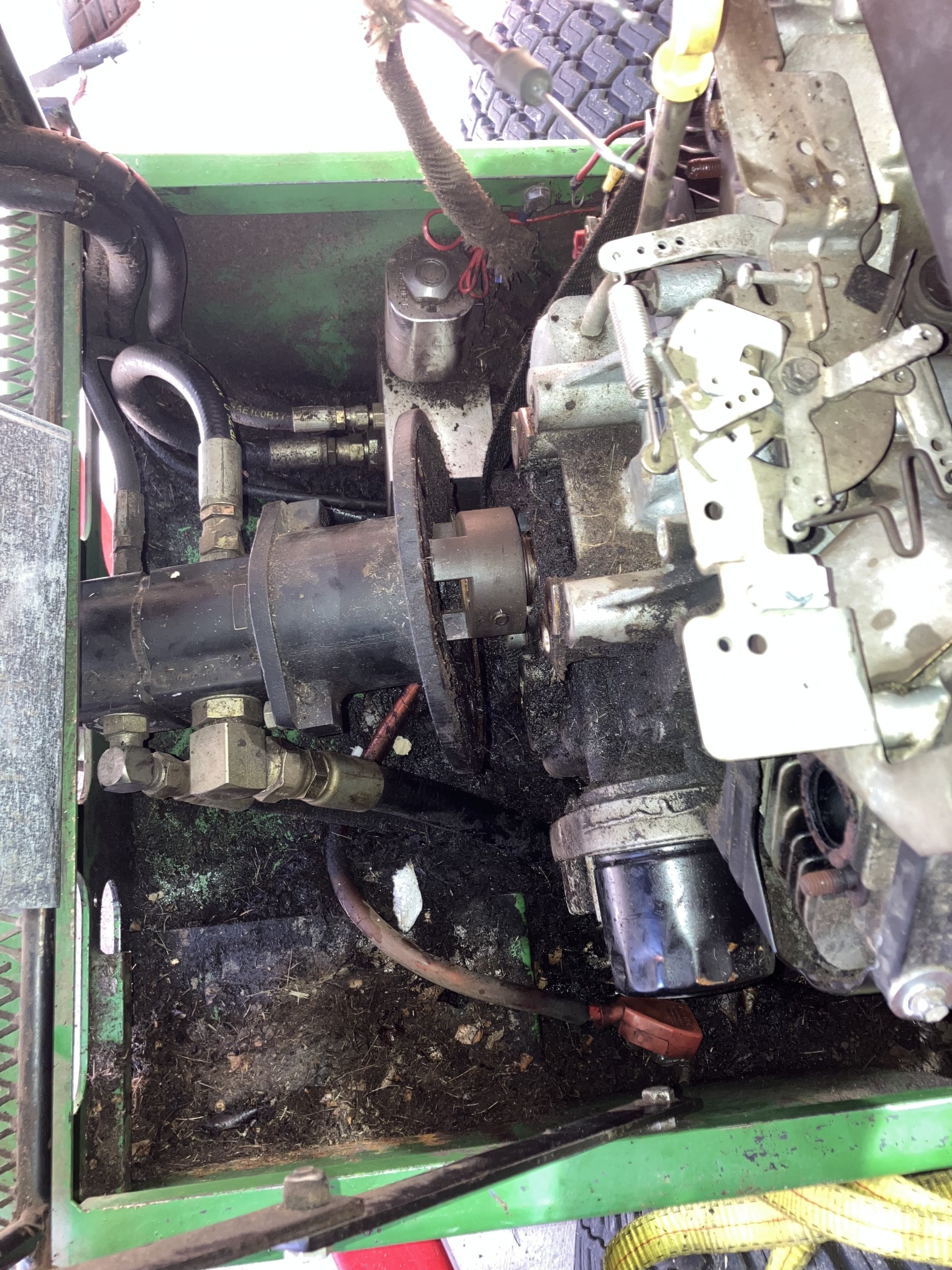

Disconnected the tram pump from the mount on the front.
Disconnected the PTO pumps from the engine on the rear.

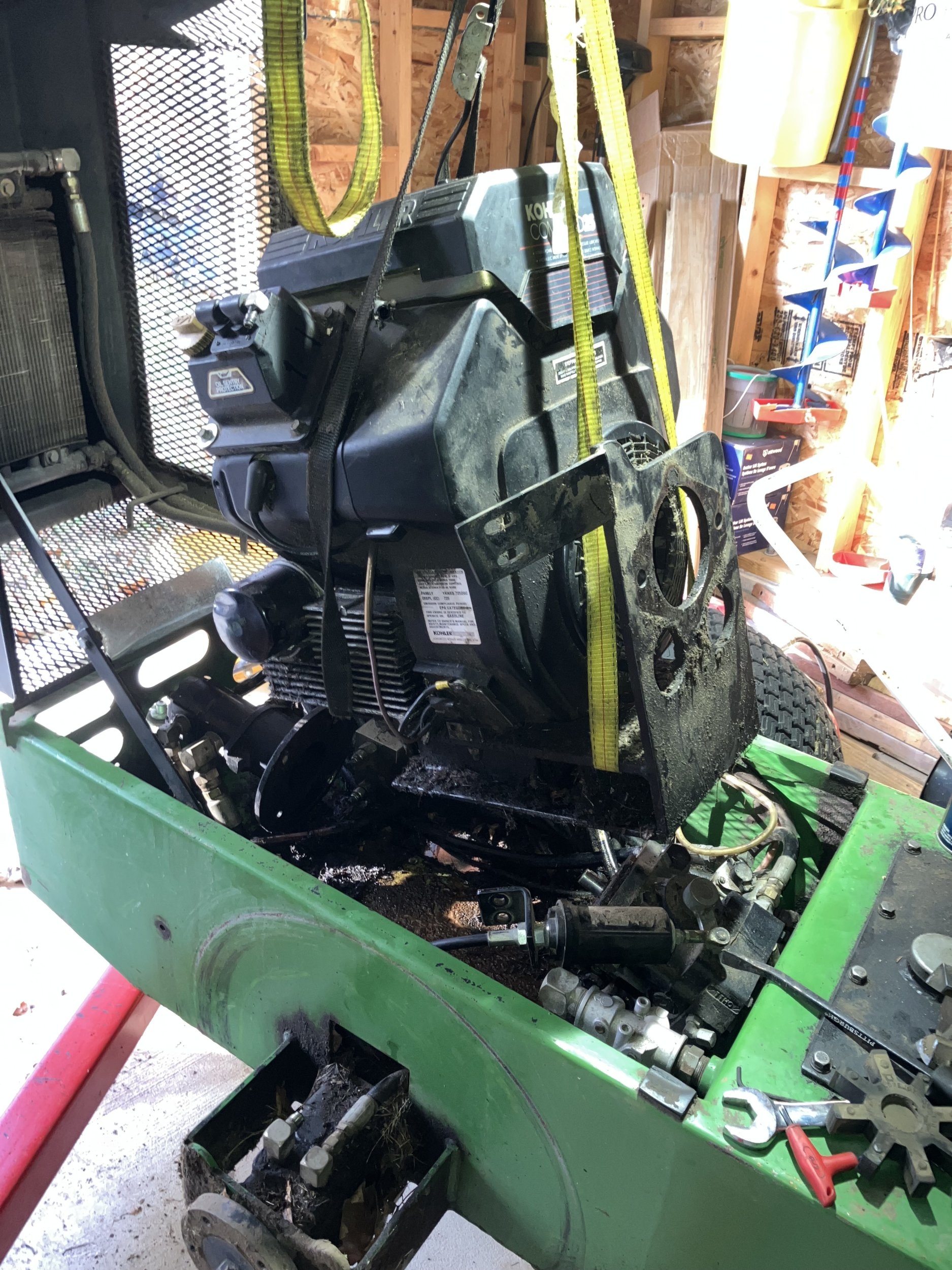

Removed the 4 bolts that hold the engine mount to the bottom of the tub.

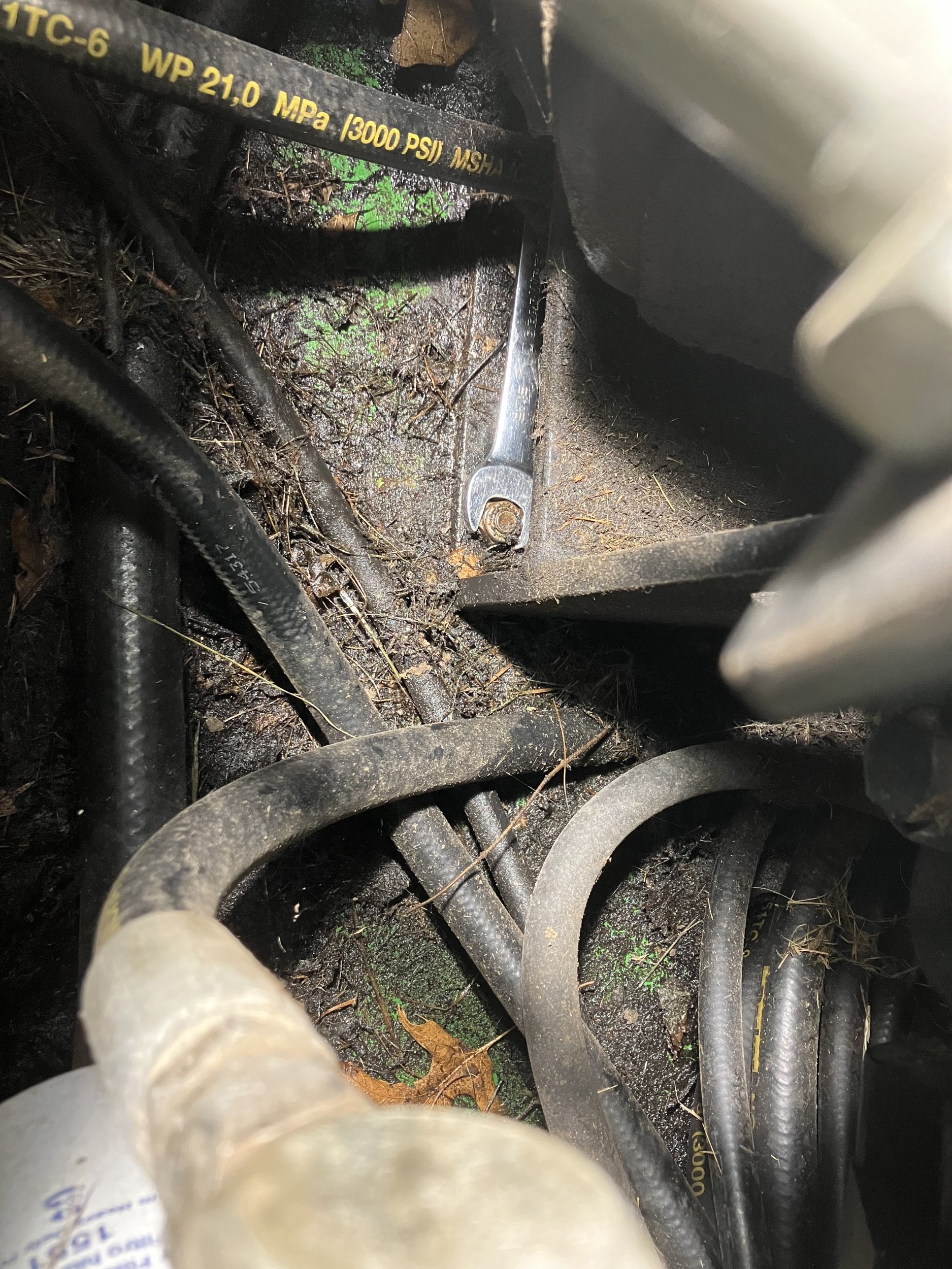

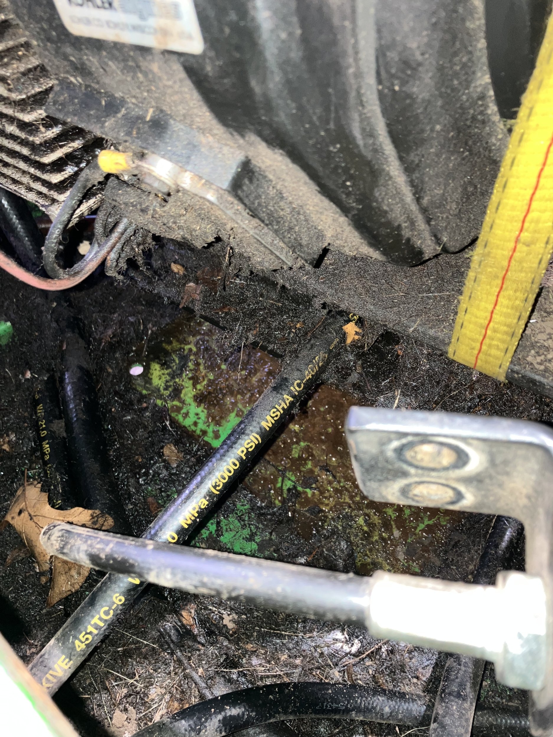

Started lifting the engine and found one (1) hydraulic hose that goes through the engine mount. Grr.

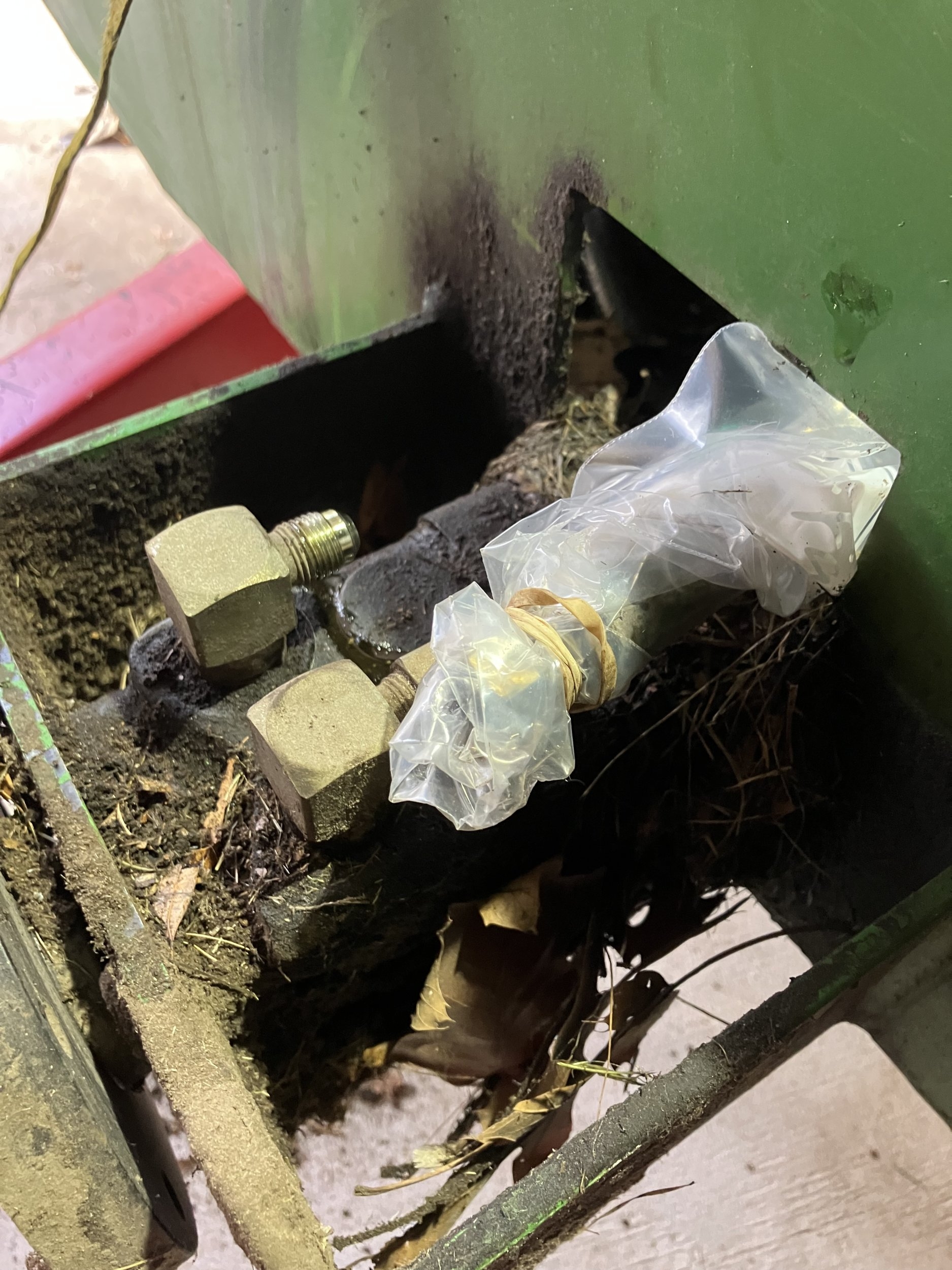

Pulled the right rear tire, cleaned the fitting, bagged it and pulled the hose.
Pulled the engine.
Took about an hour and a half. Overall, not too bad.
I'm going to get a cap/plug kit and pull the hoses off the pumps, reassemble everything after locating and repairing the oil leak, and put it all back in as one unit. That will be much easier.
