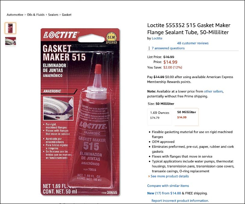

Silicone works and many of us have used it on oil seals just like you did.
There is very good alternative which I am using often:
Locktite 515 Anerobic Gasket Maker
