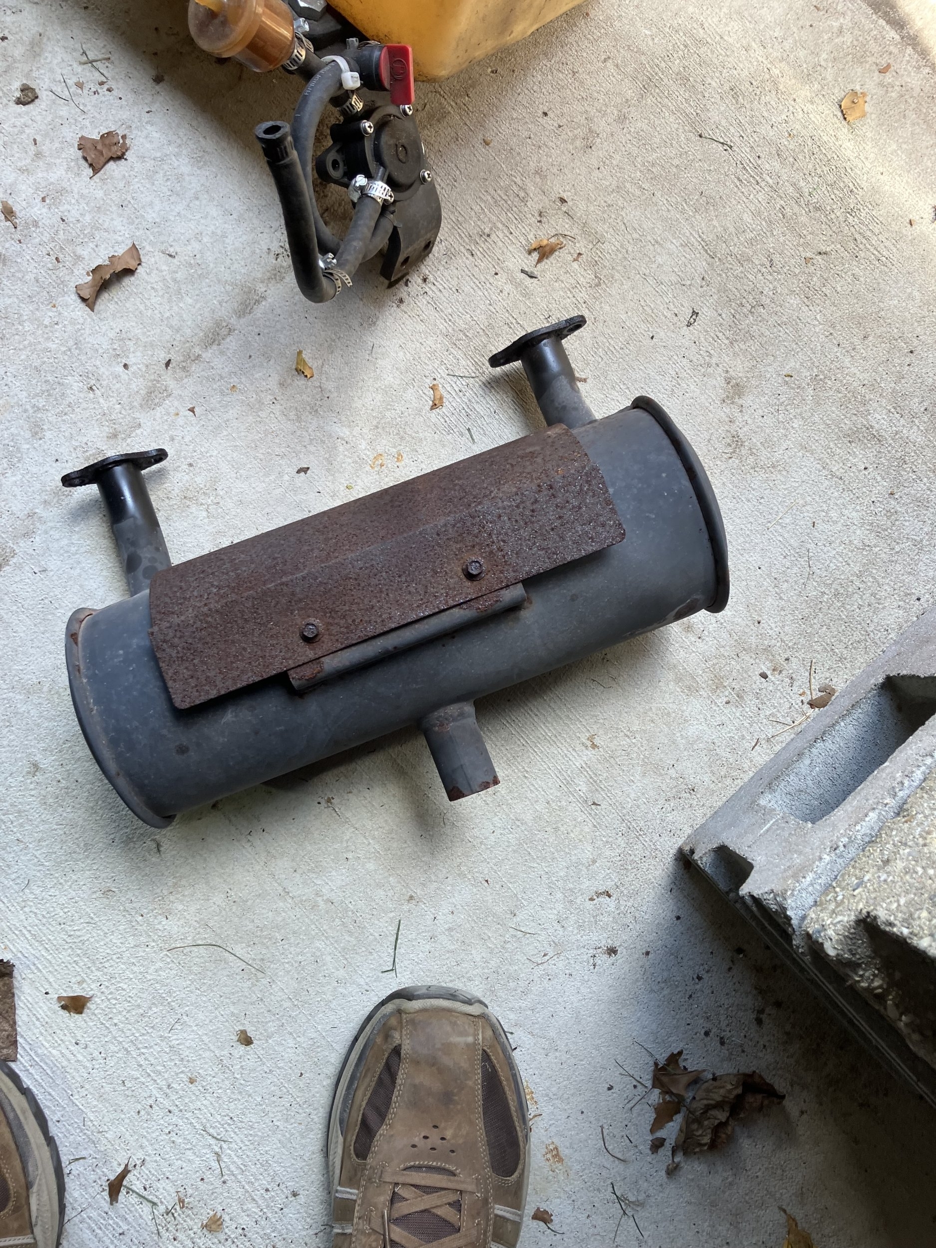

..................Snip......................
Pulled the muffler. 4 nuts. Didn't break the exhaust studs this time. šŸ™ƒ
I have switched to using brass nuts in all exhaust manifolds etc. I've had to take apart. On some applications I've used two nuts together for locking & extra strength.
So far it has worked out pretty good if or when having to reopen them, sometimes years later....
