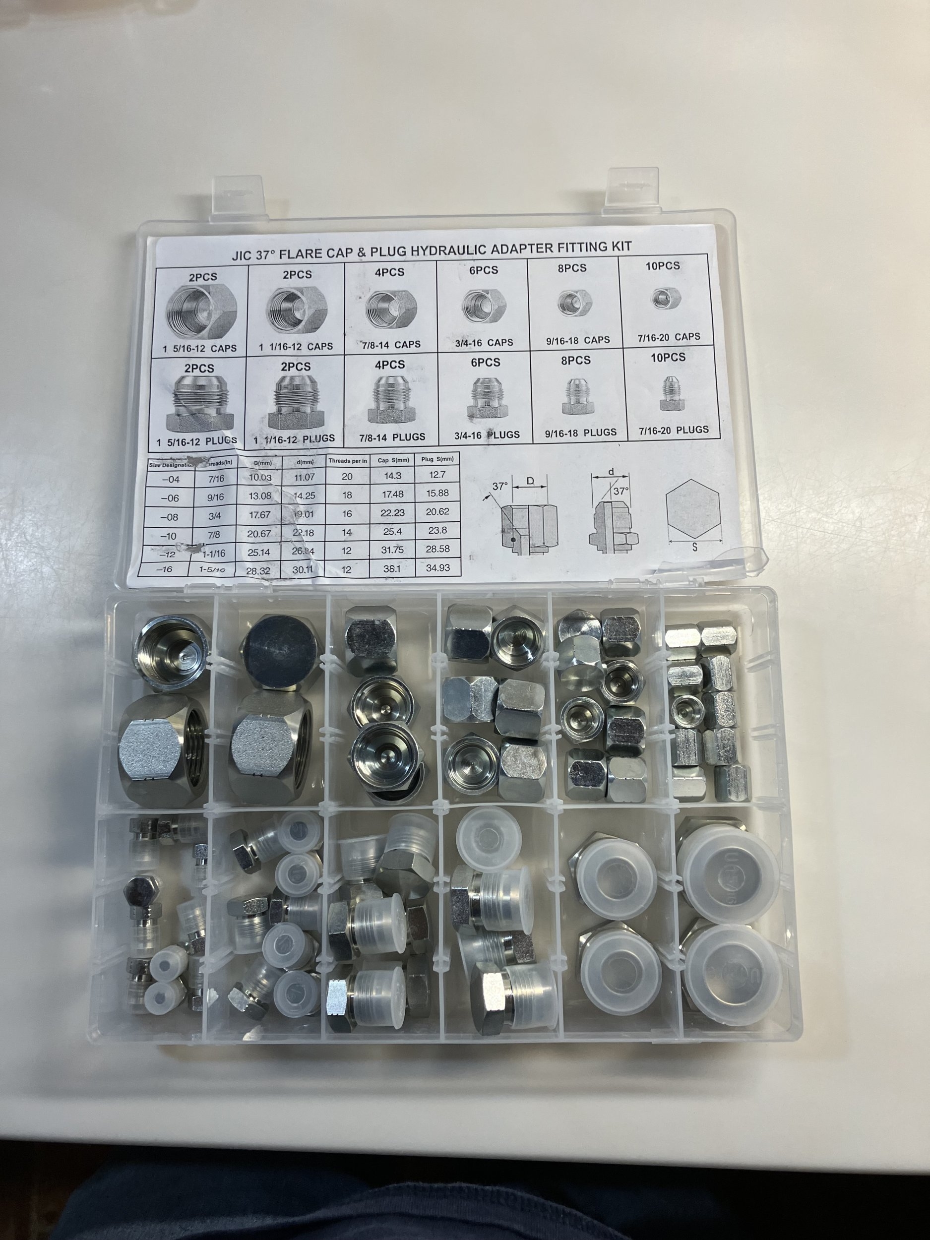

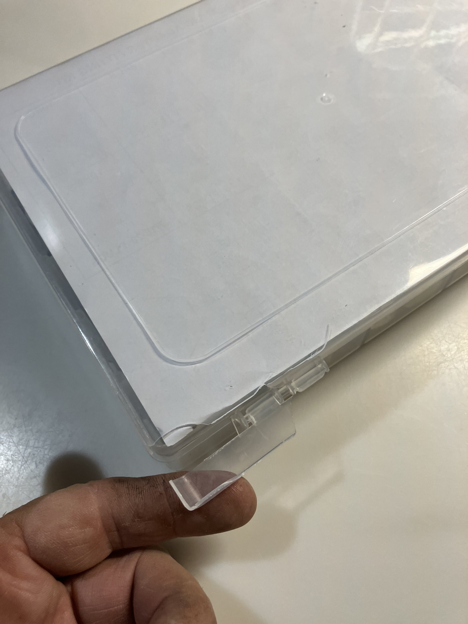

Welp, it showed up inside of a corrugated cardboard box in a waterproof bag. The plastic box has a cracked hinge. Oh well. Doesn't bother me. All of the fittings are there. Will get on it again as time permits. Spent the weekend working on canna lilies, flower pots, greenhouse, etc. winterizing. Spent Sunday with my wife and some of her family.

And my hydraulic plug/cap kit arrived shortly after I ordered it and I used one cap on a hydraulic hose.
So the engine sits on the garage floor waiting for me.
