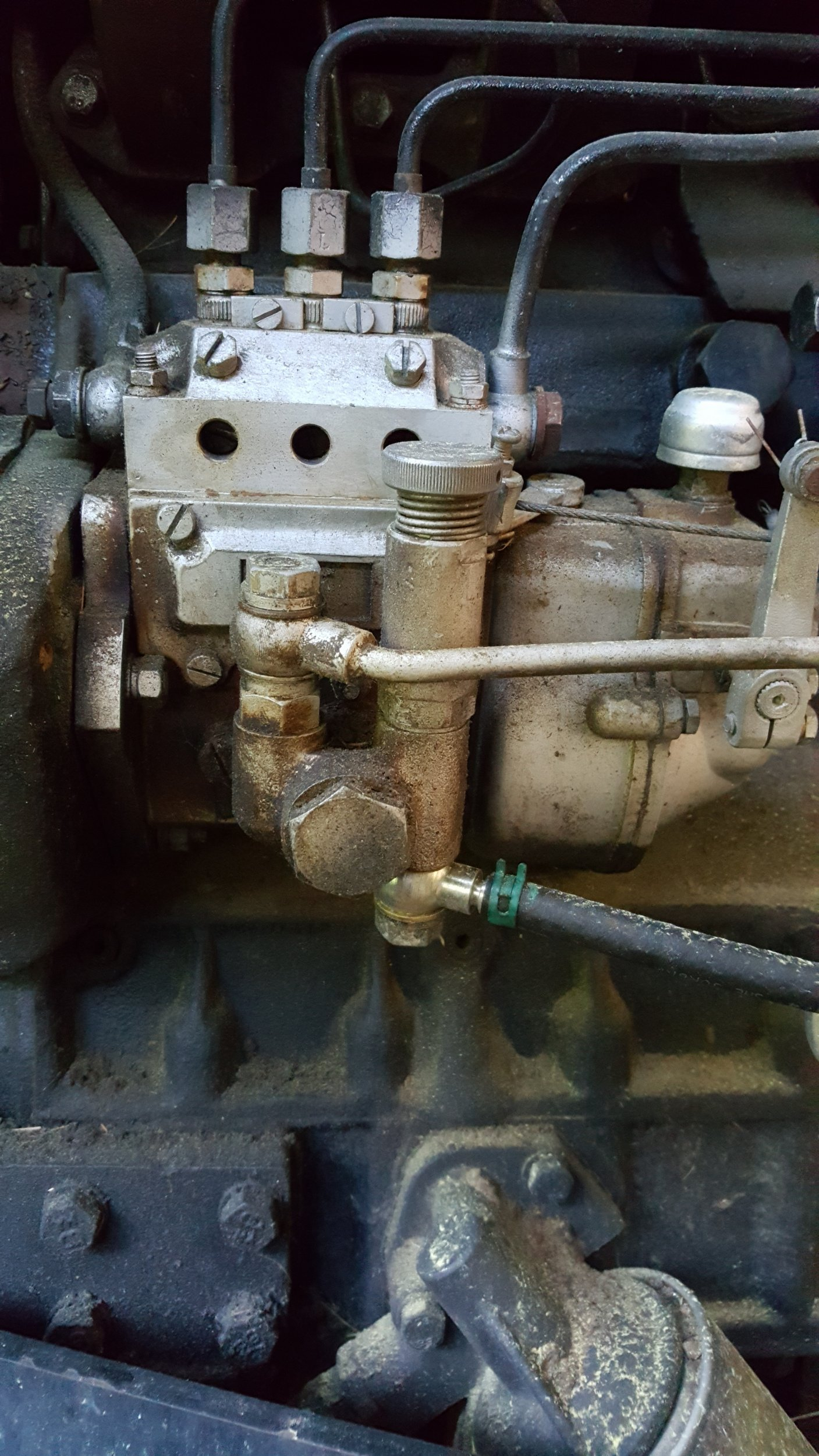

All I can tell you is I've use my JM 354 tractor for 21 years. It starts good and runs fine. It was a crate tractor I had to assemble. Besides the usual drain and change all oils and remove and flush fuel tank, I replaced the fuel tank petcock/strainer bowl assembly with a 1/4 npt (had to run a tap in the tank drain for this) and installed a 1/4" npt needle valve. I don't remember from 21 years ago, but, I did some Americanizing of hose and fittings till I got things connected and had good flow to the fuel filter. The OEM petcock had very small orifice and very restrictive for the fuel to come out. So, I understand your issues well and I addressed that right from the get go. bjr

Check your banjo bolts..
The one under the hand primer might have a screen in it..
The one on the inj. pump at the rear(return) should be a pressurized bolt or have an orifice..
It looks as though the banjo bolt next to the hand primer is your pressurizing bolt..& needs to go in the return line..
Simply going by a picture tho.
   / 2003 Jinma 354 Starts runs 1 minute dies and will not restart without fuel prime #27
Well, you don't have a removable side cover, which makes it impossible to see the rack and plunger. Apparently you don't have flow issues because #2 and #3 are firing correctly. Let us know what you find if you remove the #1 barrel & plunger assembly.

thank you....will get into it soon and report back
