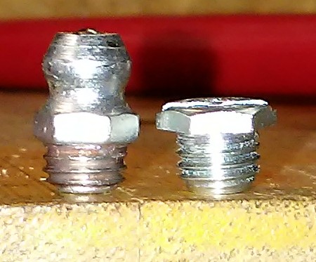

Like Wvanetti I got my recessed zerks and no-go. I called Scott's number listed on the invoice and he came up with option: Plug for end cap and 14-28 X 1 5/8 extension to use when greasing. He sent me the stuff free of charge. EXCELLENT customer service experience with Zerksplus (thanks ruffdog). He also has an Ebay store : Zerksplus61. Hopefully the included links will work.
1/4-28 UNF Plug (SLOTTED) for Zerk Fitting 5 Pcs - ZerksPlus
1/4-28 x 1-5/8" Taper Straight Grease Zerk Fitting Minimum 3 pcs - ZerksPlus
1/4-28 x 11/16 (.687) Taper Straight Grease Zerk Fitting Minimum 6 pcs - ZerksPlus
1/4-28 x 1" Taper Straight Grease Zerk Fitting Minimum 4 pcs - ZerksPlus

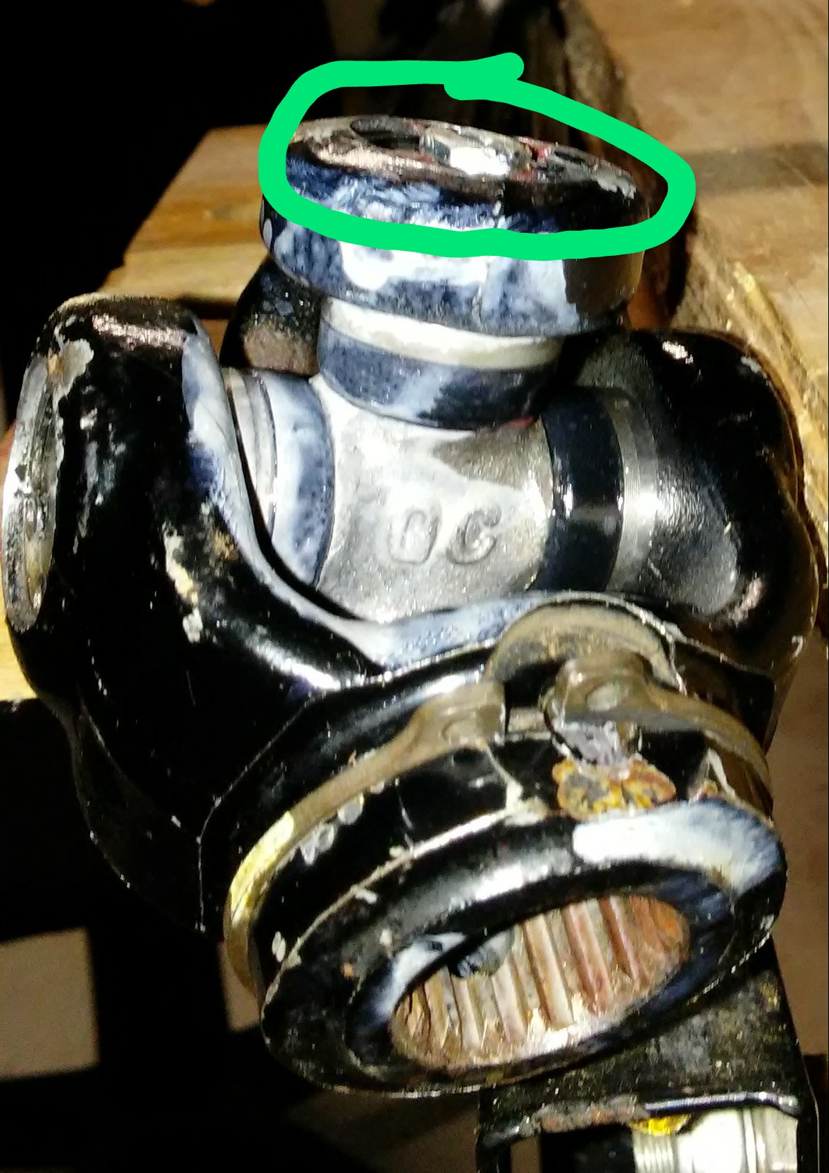

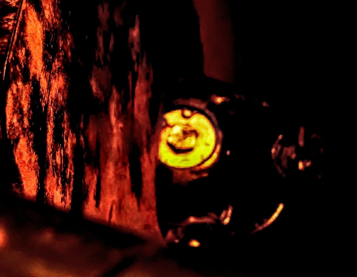

Ultimately I ended up shortening the 1/4-28 slotted / hex cap plug by about 1/6th inch to avoid the end of the pin on trunion. Picture 1 NAPA zerk next to plug, Picture 2 is original vs. ground plug, Picture 3 is lower profile of the installed shortened plug on the forward u-joint.
I looked at putting a washer but figured the less weight the better.
When it's time for lubrication I'll remove the plug, install the extended zerk to get Locknlube attached, grease and replace the plug.
All of this was just to avoid grinding down the interfering frame support due to proud zerk on after market u joint end cap from NAPA. If I was working from the top, rather than from underneath, I might of gone with the frame support mod like Wvanetti or possibly even just put up money for the OEM u-joints with zerk in the center. I have more time than money right now. I'll later post a last picture of shaft, near frame support on tractor. Thanks again to all other previous posters for paving the way to a pretty do-able project for an average or less skilled DIYer.
