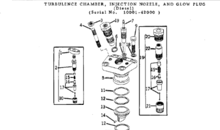

According to machine serial number you posted you should have the later style injector(key 19). T18533 Turbulence chamber(key 5) with stripped threads is NLA from JD
Yes this is correct, but the picture you posted before is not the correct injector, that one was the series after.

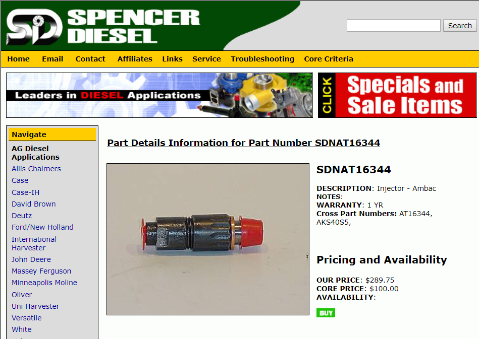

So ITS NOT the inj, in post #7??
IF NOT then I'm gonna need a pic of it.. some GOOD pictures.. & I'll probably have an idea that might work.
If its easier, u can send them to my home email.. just use my screen name & add @ a o l dot com in your HOME mail server..
   / 2010C, need to get it started! #18
post 7??? Do you mean post 9??? I incorrectly posted that photo because I didn't check machine serial number. Have you looked at my post #11?

The one in post 11 is correct.
Part number AT16344
