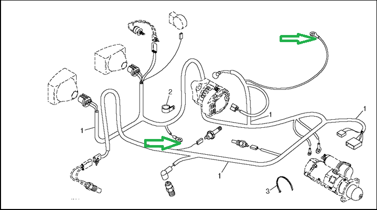

ground at battery, ground at frame, pos at battery, pos at starter, ground on wire harness all the wires from the dash usually connect at one spot, pto off, seat switch good

Ground at battery and frame good. Pos at battery good. Pos at starter, ??? . Ground on wire harness, can't locate. Further help will be appreciated Tx Jim and Peter 315
/ 2013 John Deere 5065E electrical problem #16
Follow pos to starter and see if you have voltage. The ground from harness are usually a few white wire all bolted to either the block or the frame. I can find the exact spot tomorrow.

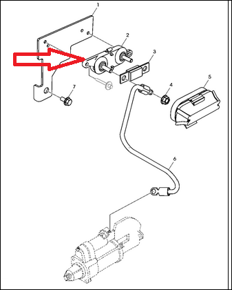

View photo & note green arrows. Red arrow is a fusible link.

I’ve replaced that fuse many times. Easily looked over
