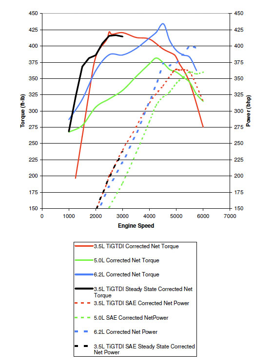

Thanks Bullitt.
Alright, well we can see the baseline for the other graph was lifted from this one from Ford, which is reported to be an engine dyno. What's the source and standard for the other three makes.
From that Article we can also see that the wheel dyno profile does not look anything like the numbers Ford supplies, driveline losses aside.

Thanks Bullitt.
<img src="http://www.tractorbynet.com/forums/attachment.php?attachmentid=368466"/>
I got the chart from the same source a couple years ago. I'll have to see where it is on their website now. Pickuptrucks.com
