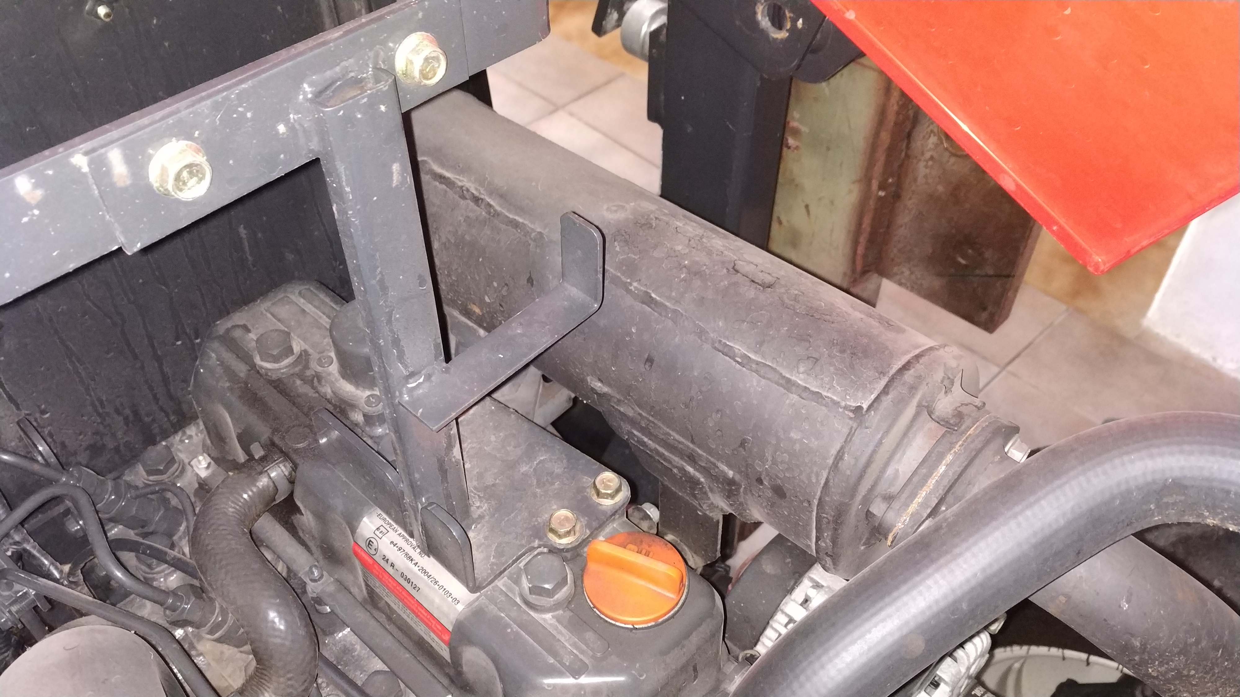

Stopped by a local exhaust shop today, they wanted to see it before they'd know if they could do anything with it. So left work early, loaded up the tractor and hauled it down there. Guy isn't sure he can make the tight bend at inlet side, and he says he doesn't have the flanges. Wants to cut my pipes off my cooker and reuse them. I really wanted to save the filter as a bolt on piece, so I had it for trade in or whatever.
Does anyone that has made the swap to muffler have a part number for the flanges they used?
I did stop by the local Runnings store and bought a muffler for an Oliver 550, that does have a right angle outlet. But the inlet is straight. Was hoping to find a right angle inlet side, but nothing on the peg. This is the muffler I found:
https://www.amazon.com/All-States-Ag-Parts-Muffler/dp/B01FRHY042
I think it's short enough the guy ought to be able to make this work, can cut the inlet pipe down to almost the muffler body.
I'm sure I'll never put the soot cooker back on for my own use, but I'd like to keep it all "bolt on" swappable, just in case.

Summit racing lists 354 flanges. Surely one would be close enough to the required size? Or you can cut them out of plate. Summit also has bends and tubing.

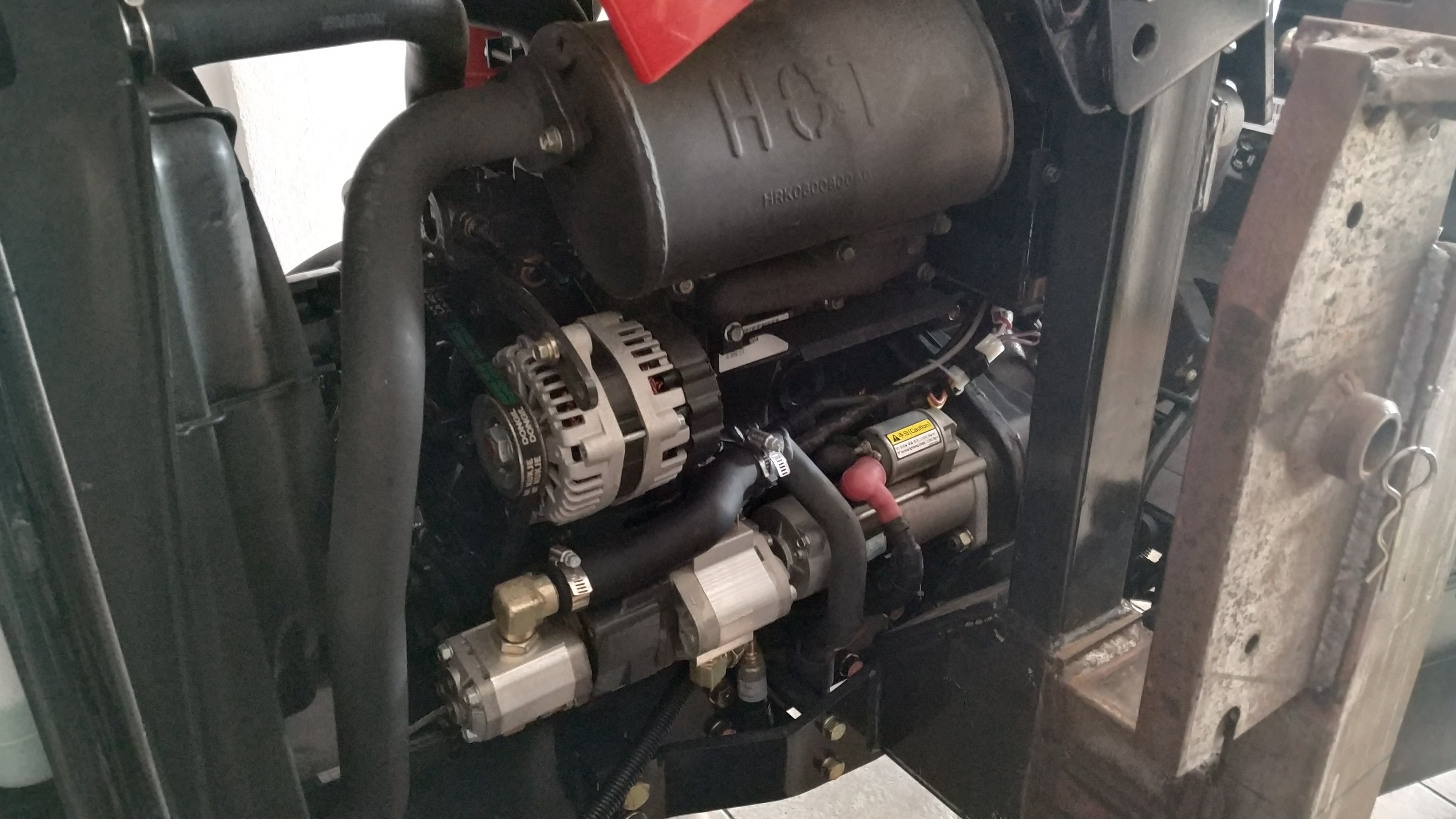

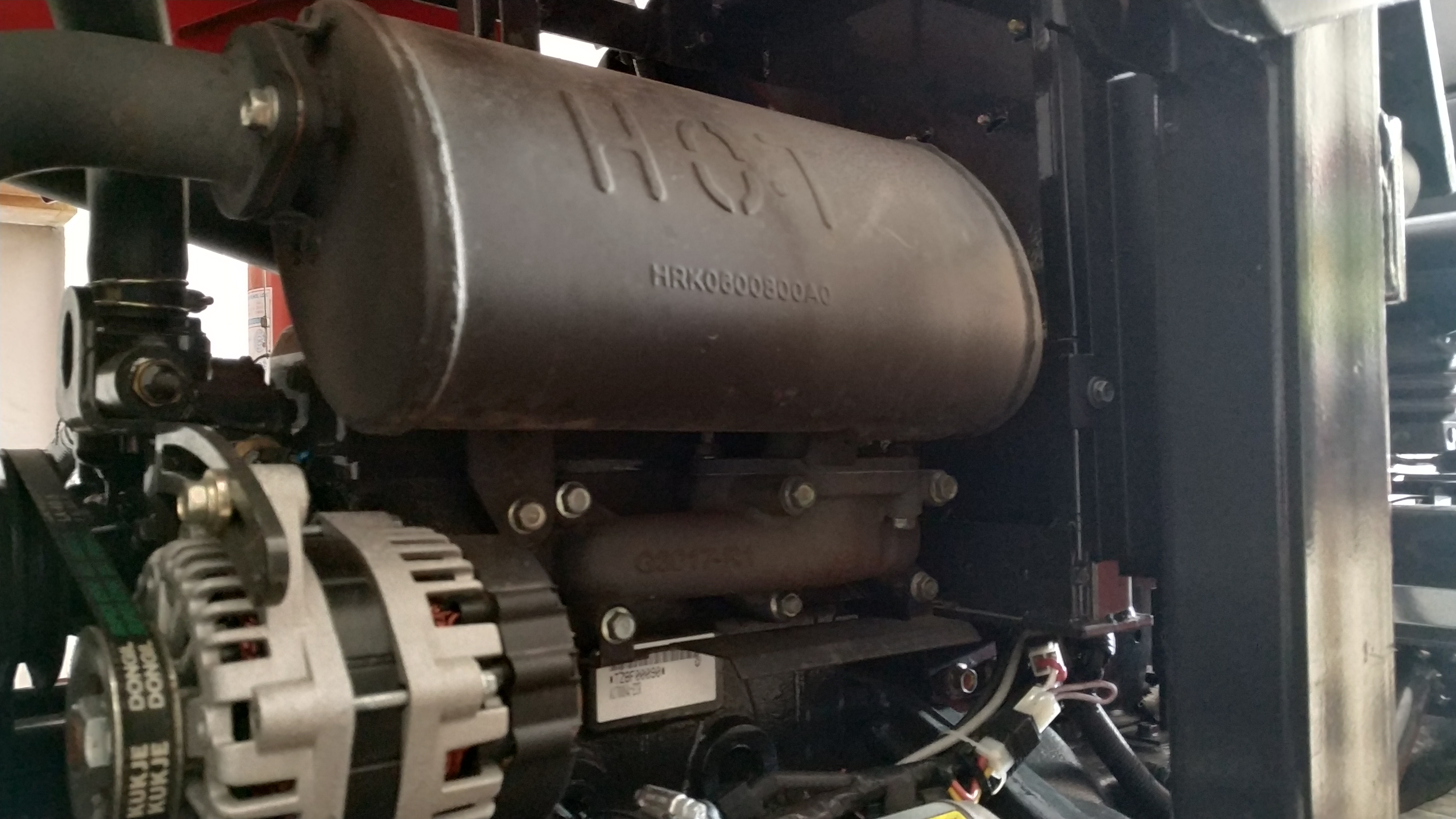

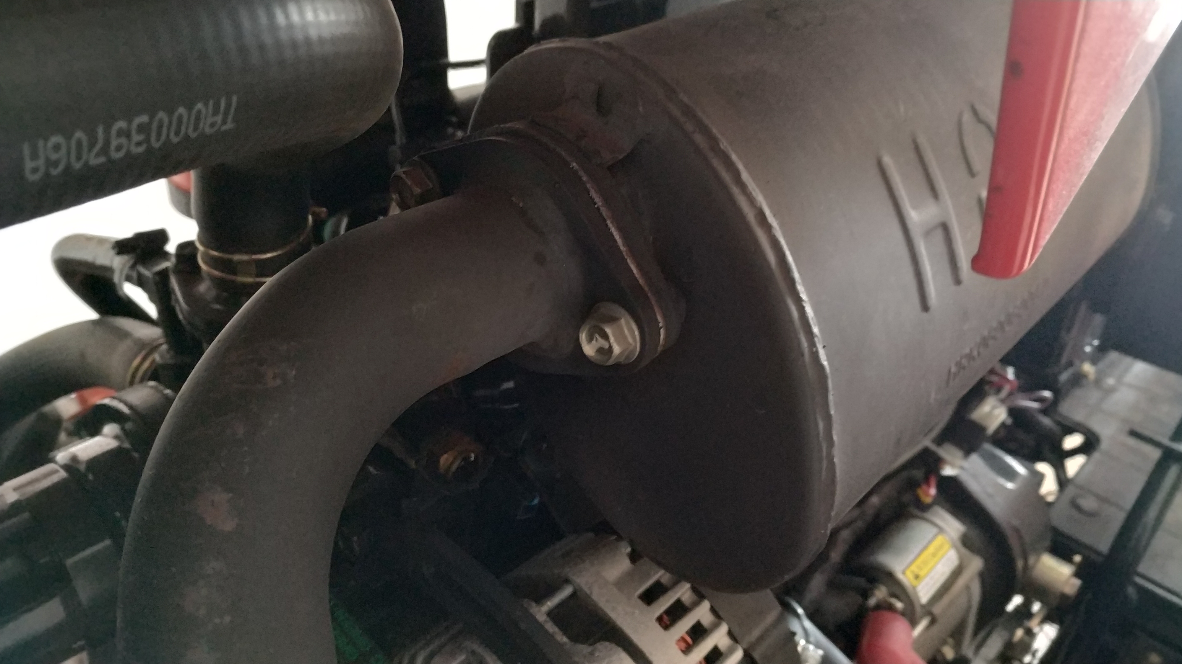

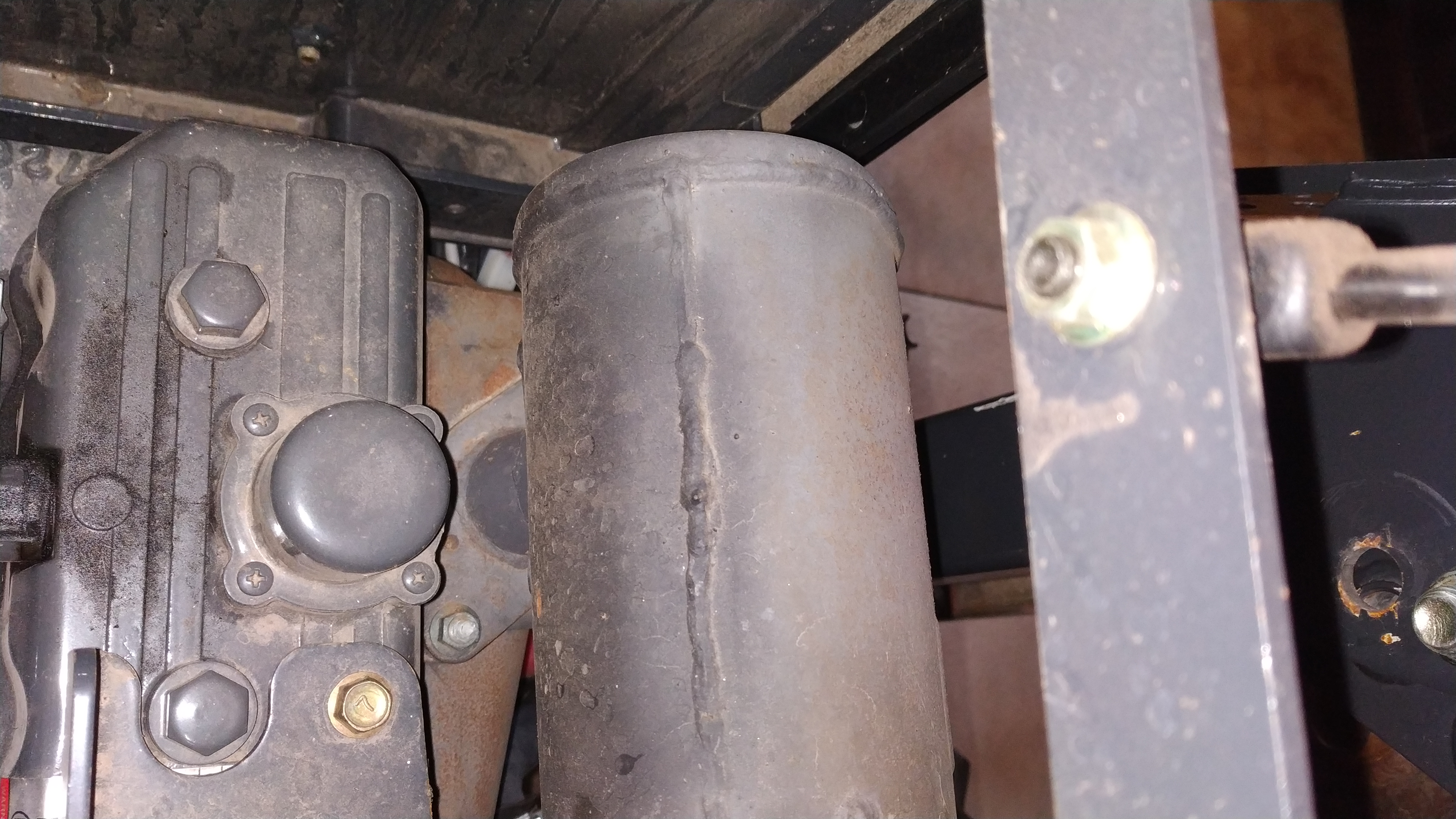

I happen to have the tractor in the home garage so I took a couple random pictures of the exhaust. Maybe it will help or at least give some ideas.
