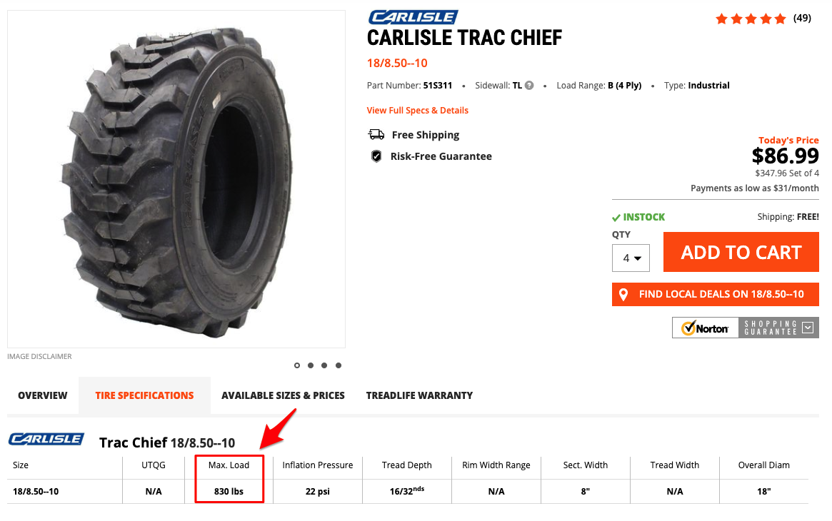

Also, in researching the tires more thoroughly, they are quite anemic. They are 4 ply with a weight rating of 830lbs... I just don't think thats very good for a SCUT with loader, but I'm not a tire expert. Maybe they're fine, who knows.

Just checked 5 minutes ago. 21psi. What should they be?

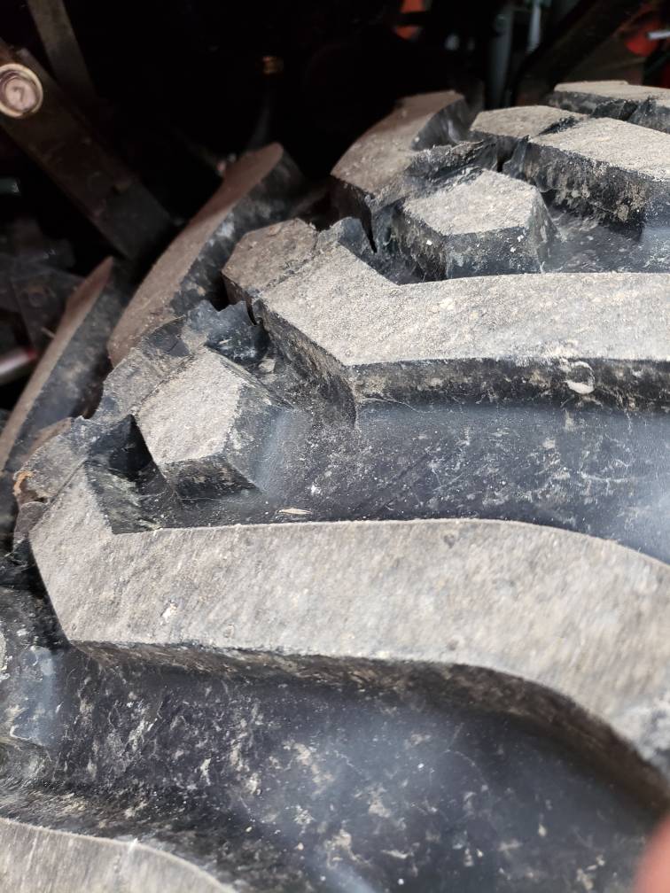

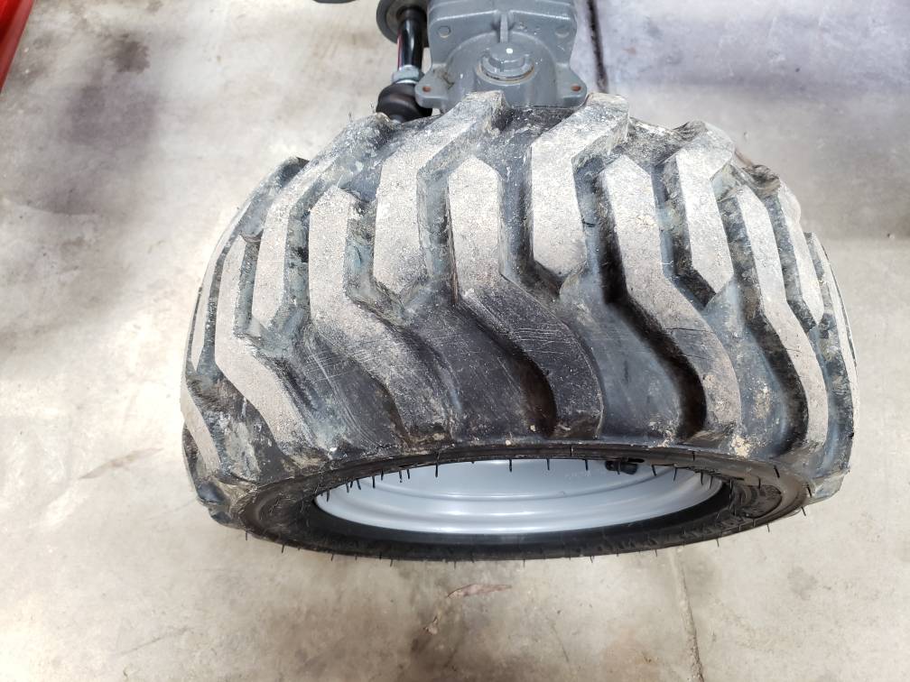

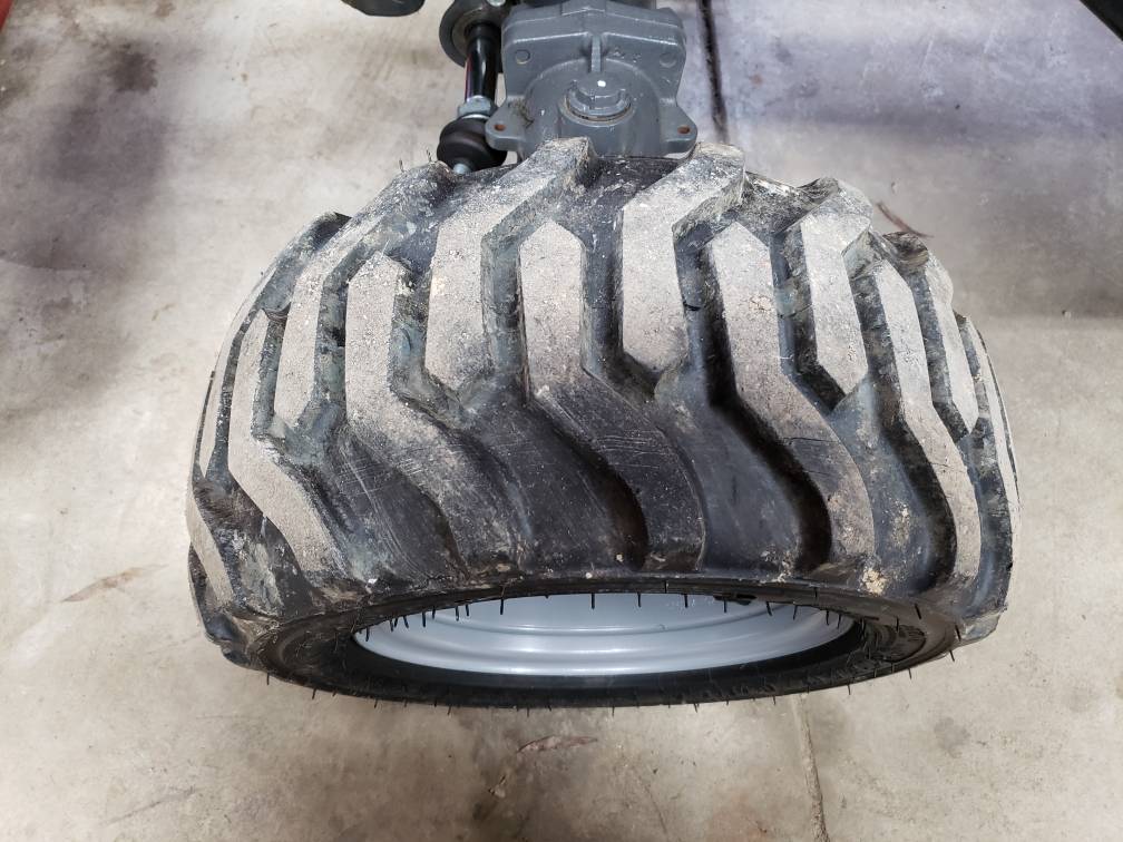

Here's a couple more pics with a little better perspective. 20190424_193624.jpg20190424_193620.jpg
   / 2018 GC1720 Tires Splitting after just 20 hours of mowing the grass? #19
Are you certain theyæ±*e actually cracked? They look like cuts to me. Maybe spinning up a trailer ramp?
If all the cracks, cuts or slits are exactly perpendicular with the axle I would agree they are the result of physical damage. They surely have nothing to do with a tire mold. The mold parting line is clearly visible at the centerline of the tire.
Just viewed the video. It looks to me like damage from spinning on a sharp object.
#20
I just don't believe so.
Something would have had to cut completely through the lugs and the top parts of the groove at the perfect depth on both sides in exactly the same way. An event that powerful and catastrophic would be memorable, I'd think.
And if that were the case, the rear tires should show some sort of damage because whatever would have cut the fronts would absolutely have contacted the rears, too. There's nothing on the rears at all. I'll attach a photo.
I just don't buy it being something I would have run over. It's only ever been on grass and my gravel driveway.
None of my vehicles nor other commercial mower have contacted anything to cut their tires. My lot is completely turf.
