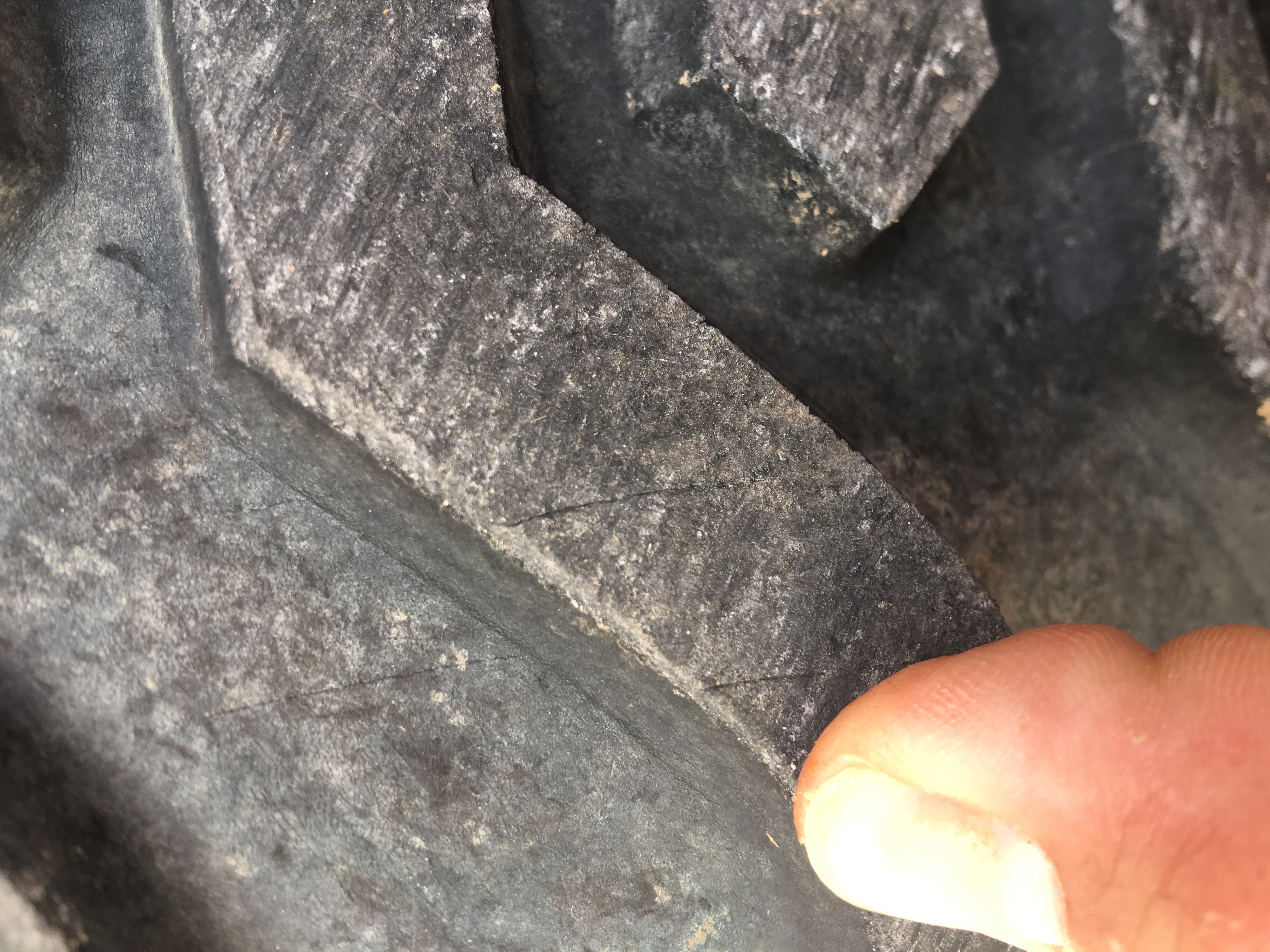

Its probably not a failure at the mold but an issue with the material or vulcanization process.
Carlisle Corporate knew exactly what I was talking about and asked me if they were the r4 industrial tires even before I told them what type they were.
   / 2018 GC1720 Tires Splitting after just 20 hours of mowing the grass? #22

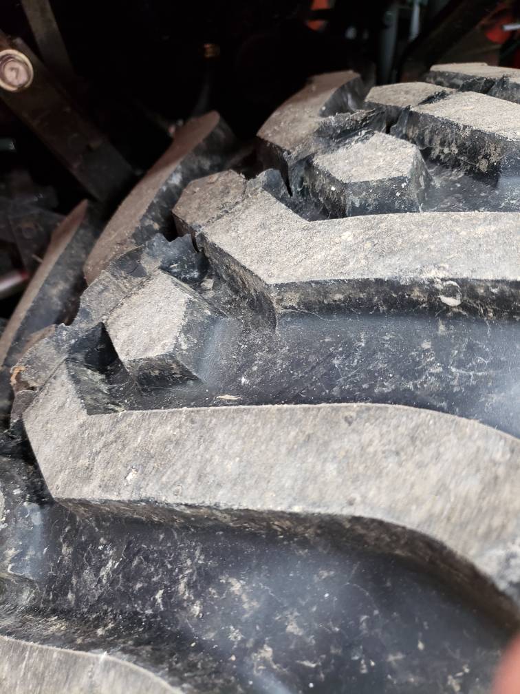

I just don't believe so.
Something would have had to cut completely through the lugs and the top parts of the groove at the perfect depth on both sides in exactly the same way. An event that powerful and catastrophic would be memorable, I'd think.
And if that were the case, the rear tires should show some sort of damage because whatever would have cut the fronts would absolutely have contacted the rears, too. There's nothing on the rears at all. I'll attach a photo.
I just don't buy it being something I would have run over. It's only ever been on grass and my gravel driveway.
None of my vehicles nor other commercial mower have contacted anything to cut their tires. My lot is completely turf.

Nacademus, you are NOT alone. I bought my GC1720 in early January this year. At 33 hours, after giving her a proper bath, I noticed the exact same type of cracks. They are on either side of each front tire. There is no way that this was caused by some sort of physical damage. These tires are made for this application and should not fail in this manner. Here's a pic of on of my tires. This should validate the theory that it is a defect! I am anxious to see how this is resolved for you, as I plat to follow suit.

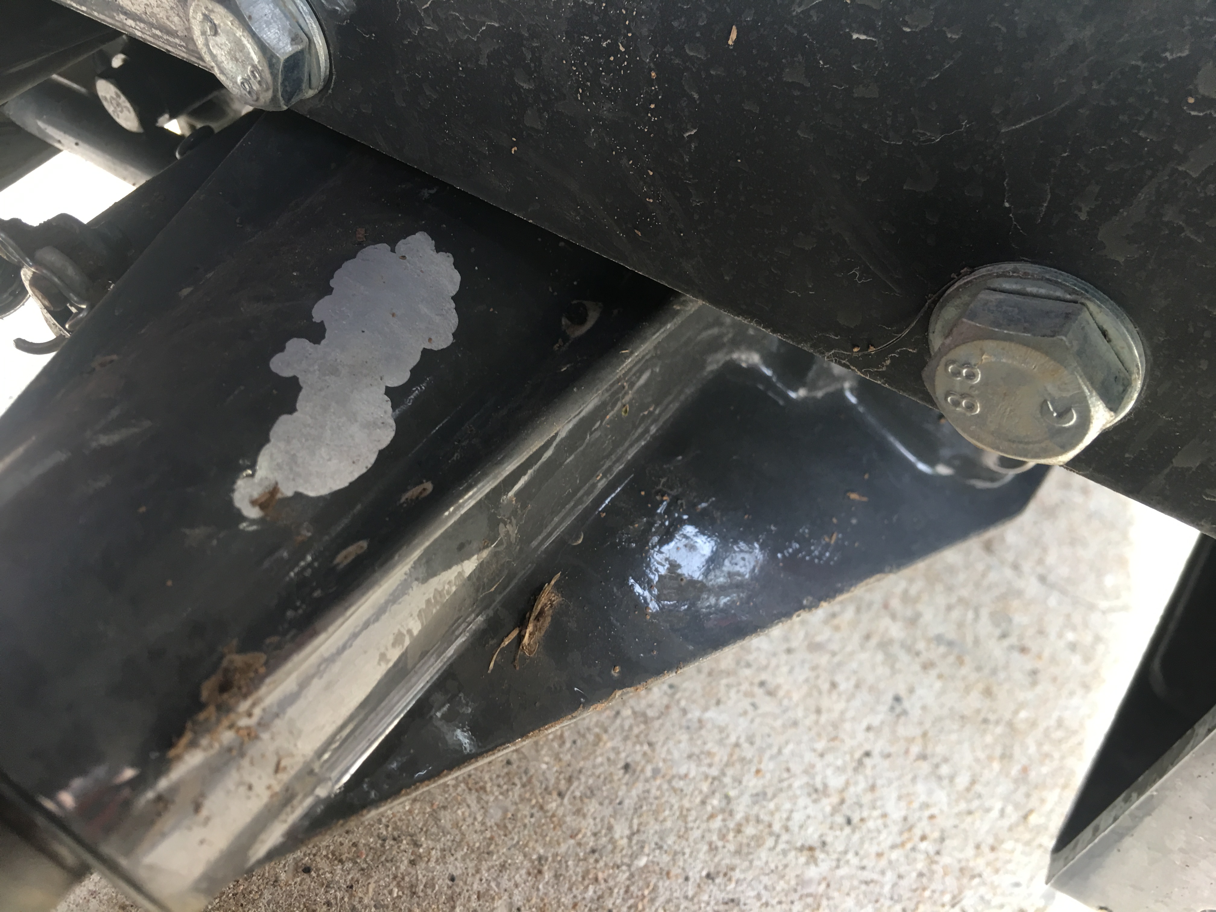

I also posted a pic of paint chipping off of my axle housing. I merely sprayed it off with a garden hose and it chipped off like that...

That is not from spinning tires, they are defective, It took me inspecting three 2305's to find one without a cracking Carlisle tire on it.

Finally received my replacements. Glad to have them. My only annoyance is that they look like they used the ****tiest, dirtiest, mold to make them. Like they're cosmetic rejects or something.
